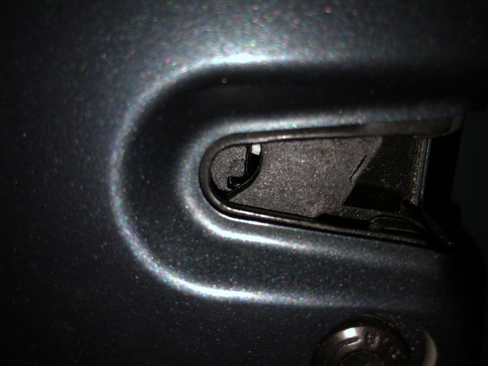

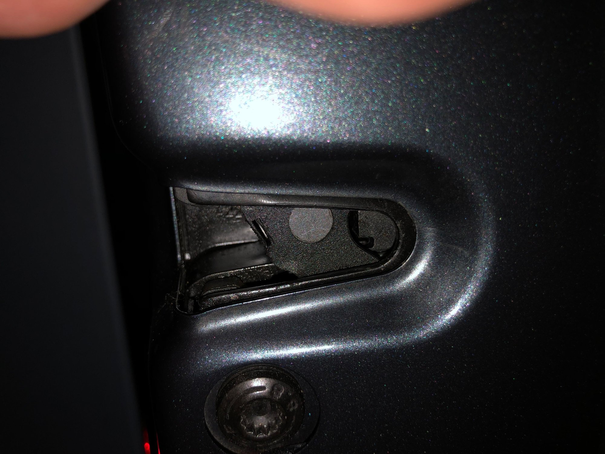

Well, I can't see anything obviously wrong with the mechanisms.
The passenger side which still works fine
Driver side not working
