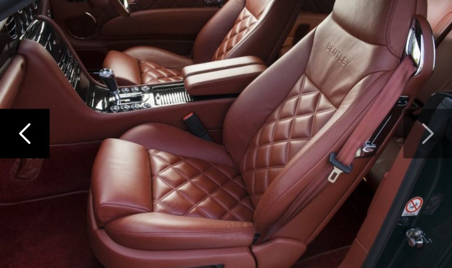

2010 Brooklands Coupe drivers seat control module
'Backrest not locked' warning, no power to the drivers seat. Suspected faulty control module but they are on back order. Does anyone know the VW equivalent to the Bentley 3W0959760B06 (replaced by 3W0959760E00A)? I see that they seem to share some of the same part numbers e.g. 3D0959760B for the VW Phaeton.

We have been through this before with @Lars_Tempest and his seat problem, the Pheaton control module did not work for him on his GT, most likely because the Pheaton is a four door like the Flying Spur with different controls for headrest and seat belt adjustments unlike the GT.

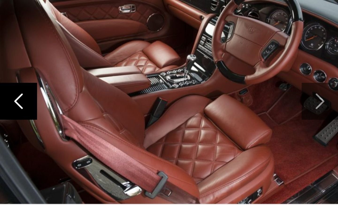

I am not sure what vw module would be swappable with your coupe Brooklands, as it uses the Bentley GT seats as shown in the attached pictures.
