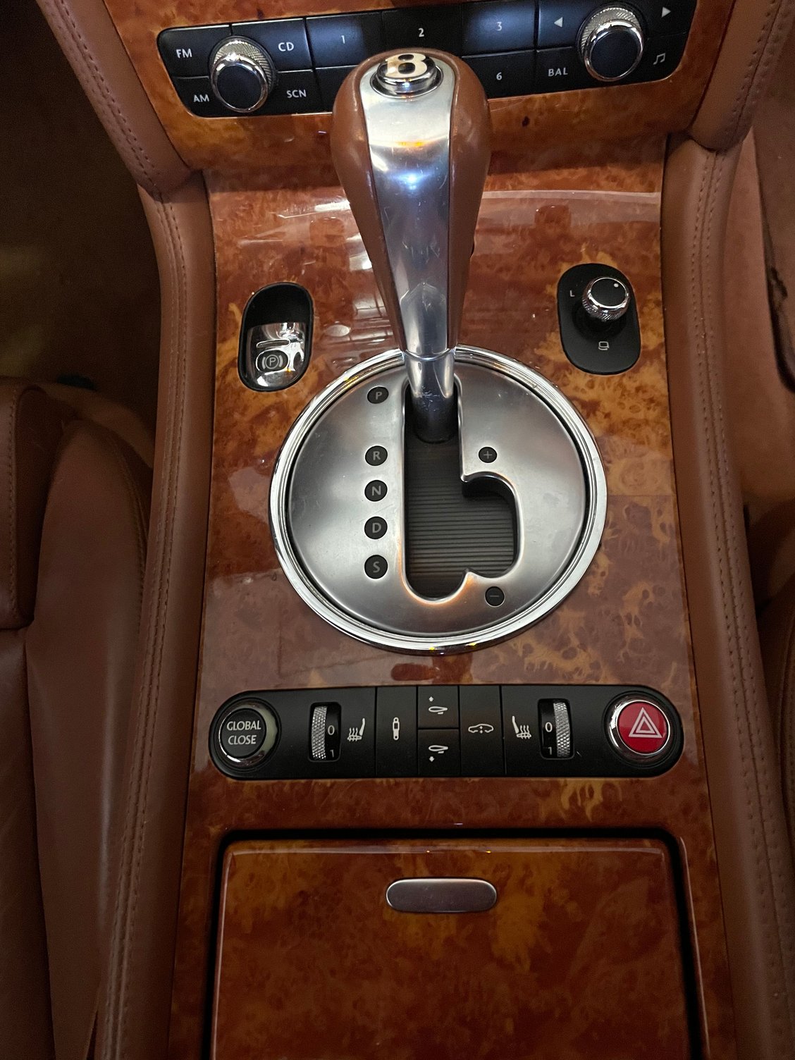

Are you saying there's no Start/Stop button on the center console and you can only start the car with the key? Post a pic of your center console if you have a chance.

USA cars in 2005 were key only
I just realized Sazam is possibly not in USA. It is my understanding Bentley/VW didn’t add push to start till later years. The cars can accept it with a modification since the rear of the world got it

yes i am europe - bought gt 2005 swiss
btw - what is the label of this button you have / what is the function?

It is "Global Close" and it closes all of the windows.

ROW would always get the options first, 2004 - 05 had global close for USA N/A, we got push button start in 2006 models, whereas Europe got it in 2005, who knows, maybe even 2004...
