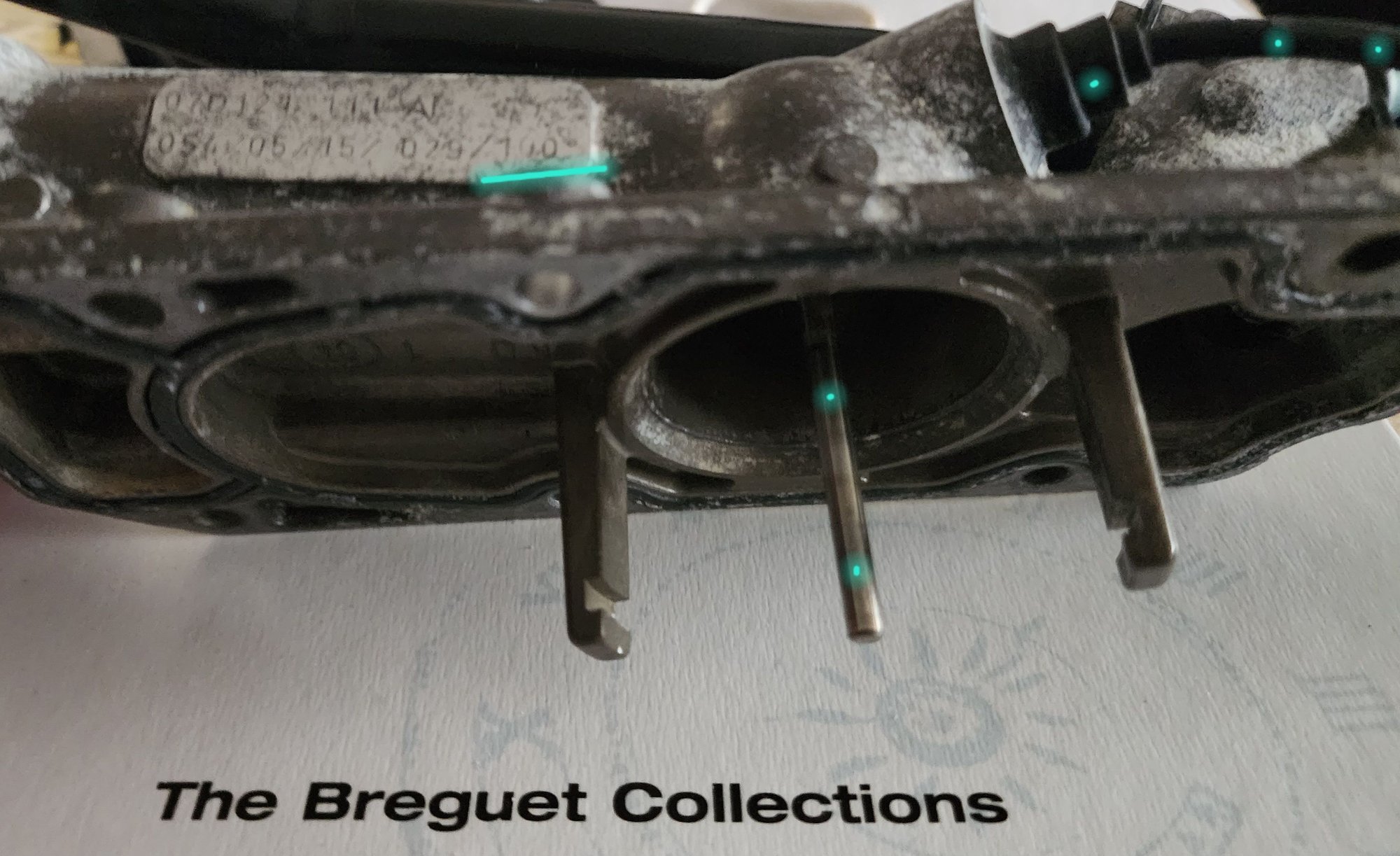

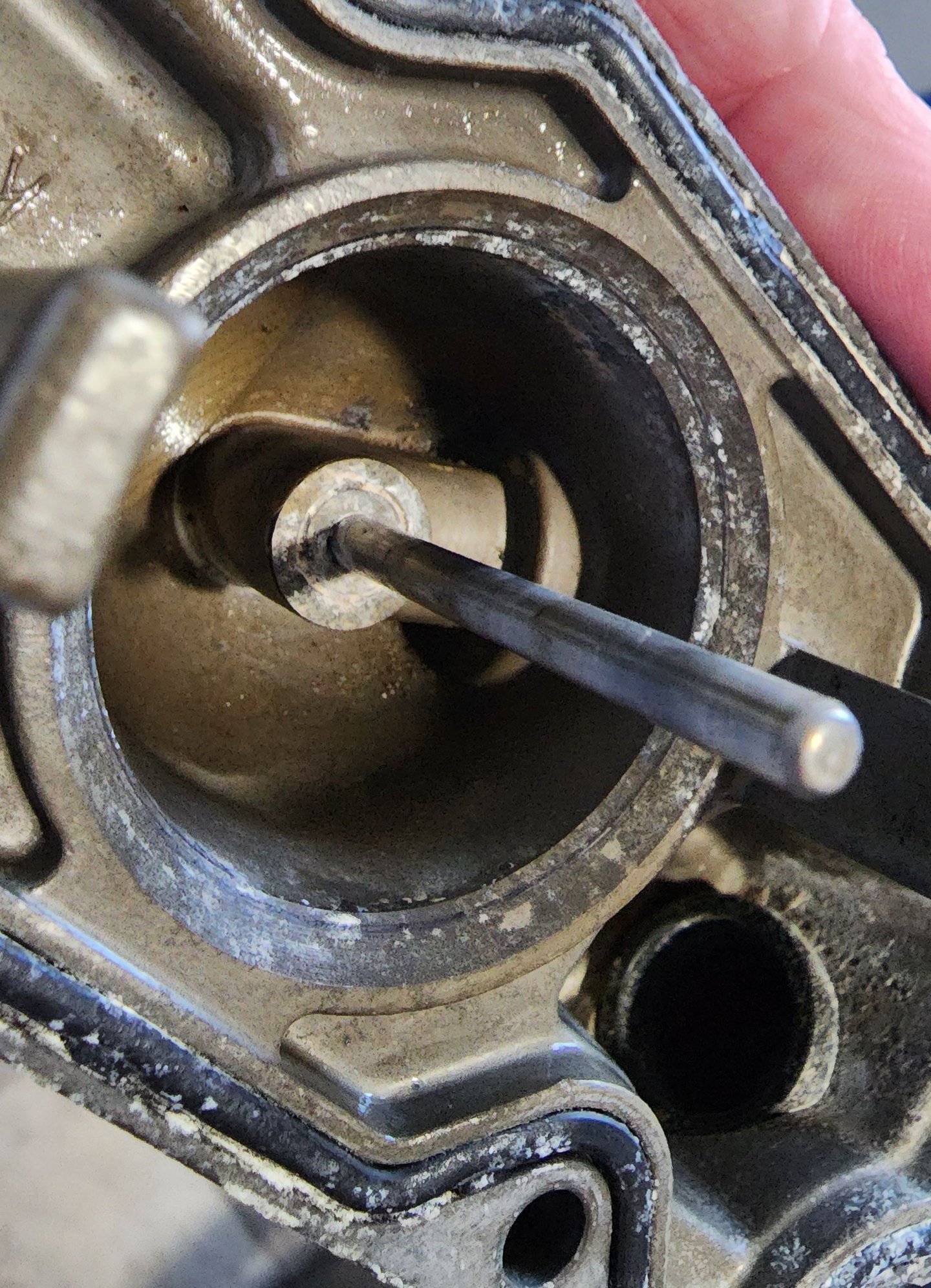

@Owner bentley ,
I just wanted to add a few pictures to clarify the difference between the heated and non heated housings, the 87°C non heated thermostat comes out as I pictured previously, meaning, that the mounting stud/shaft comes out with the thermostat, whereas the 100° and 105°C thermostat housings retain said shaft in the housing itself, as it is part of the heating element, SO, when removing the thermostat from the shaft, do not put pressure side to side, slide it straight up and off the shaft.
Here is a 100°C electric heating element thermostat housing with the thermostat removed.
You never did post any pictures of your thermostat, or answer as to your testing of either electric heating element with an ohm tester, please do.
Johnny

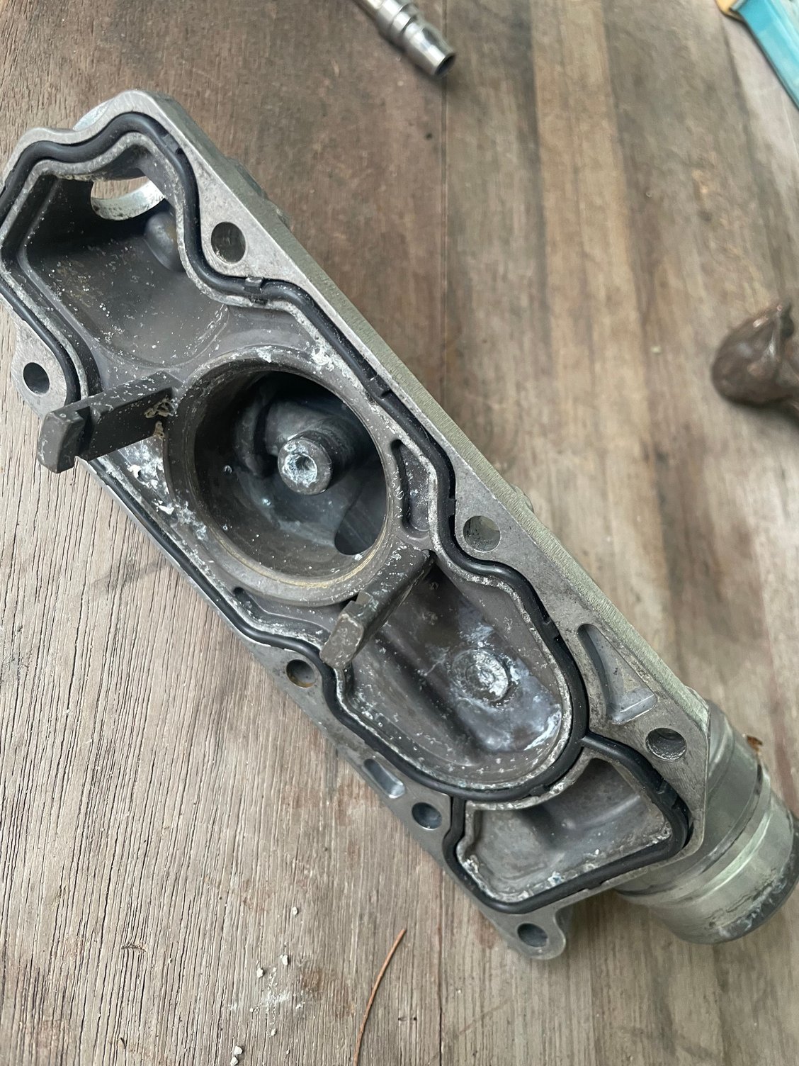

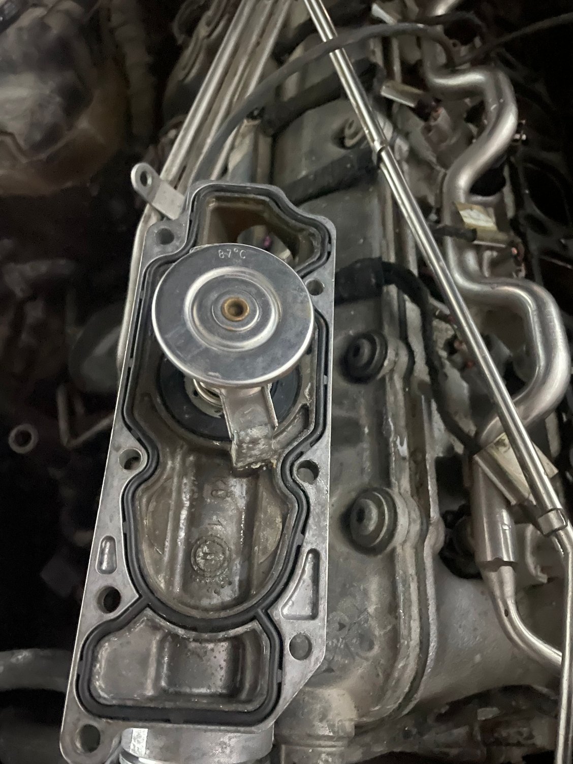

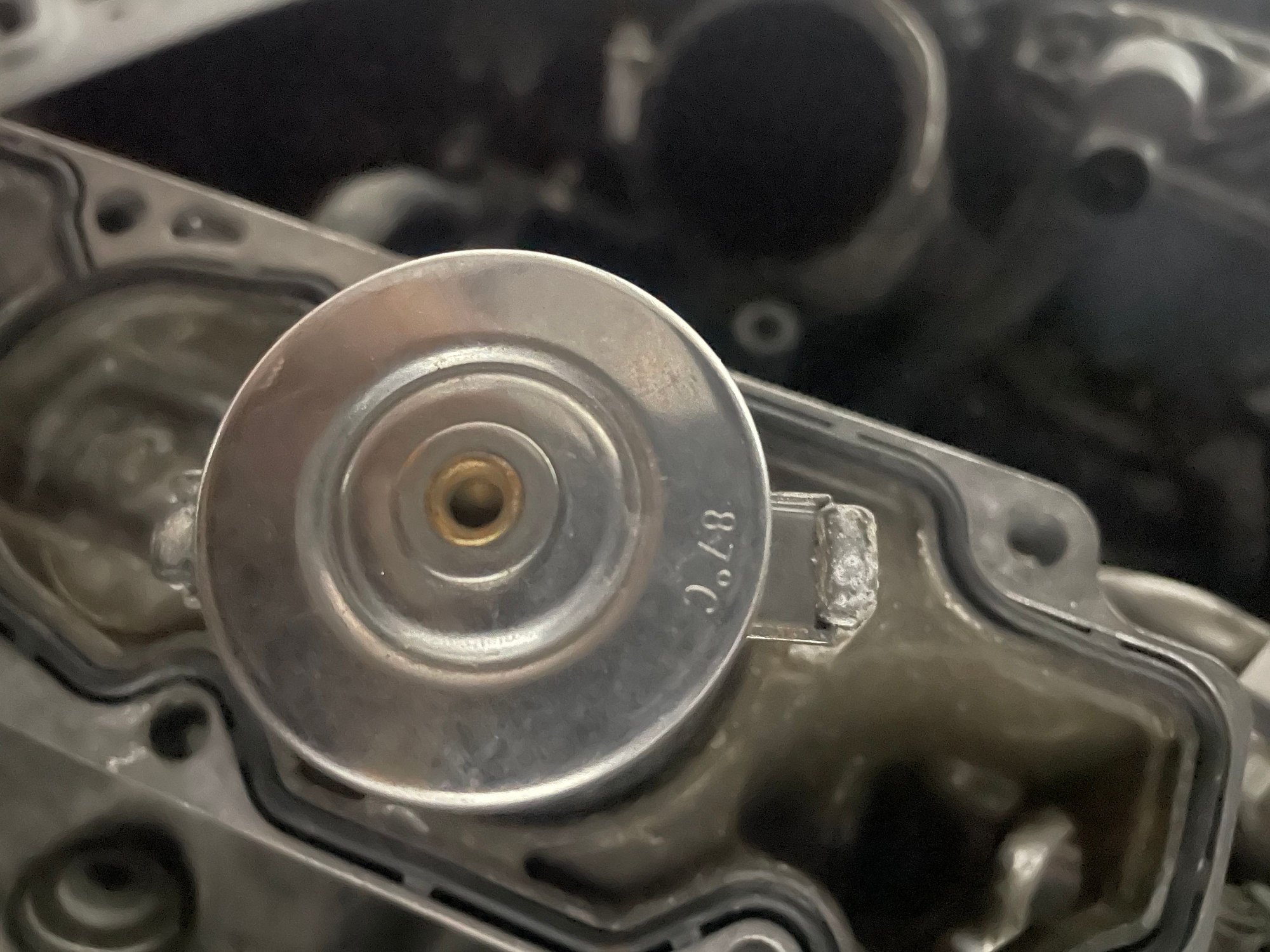

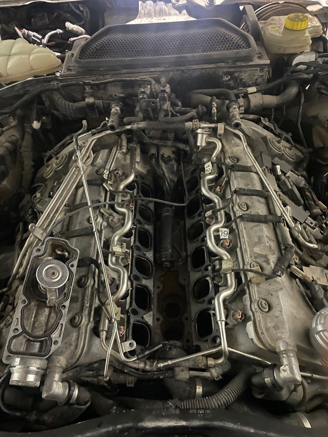

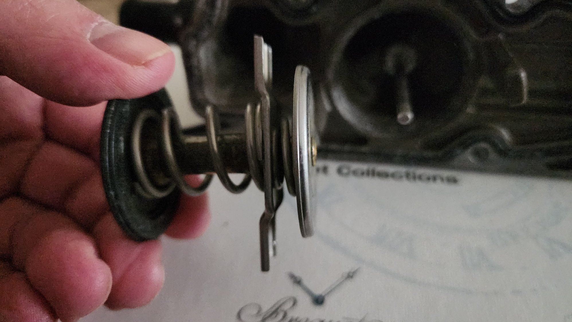

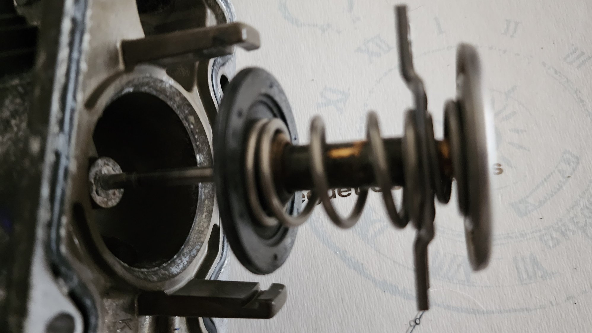

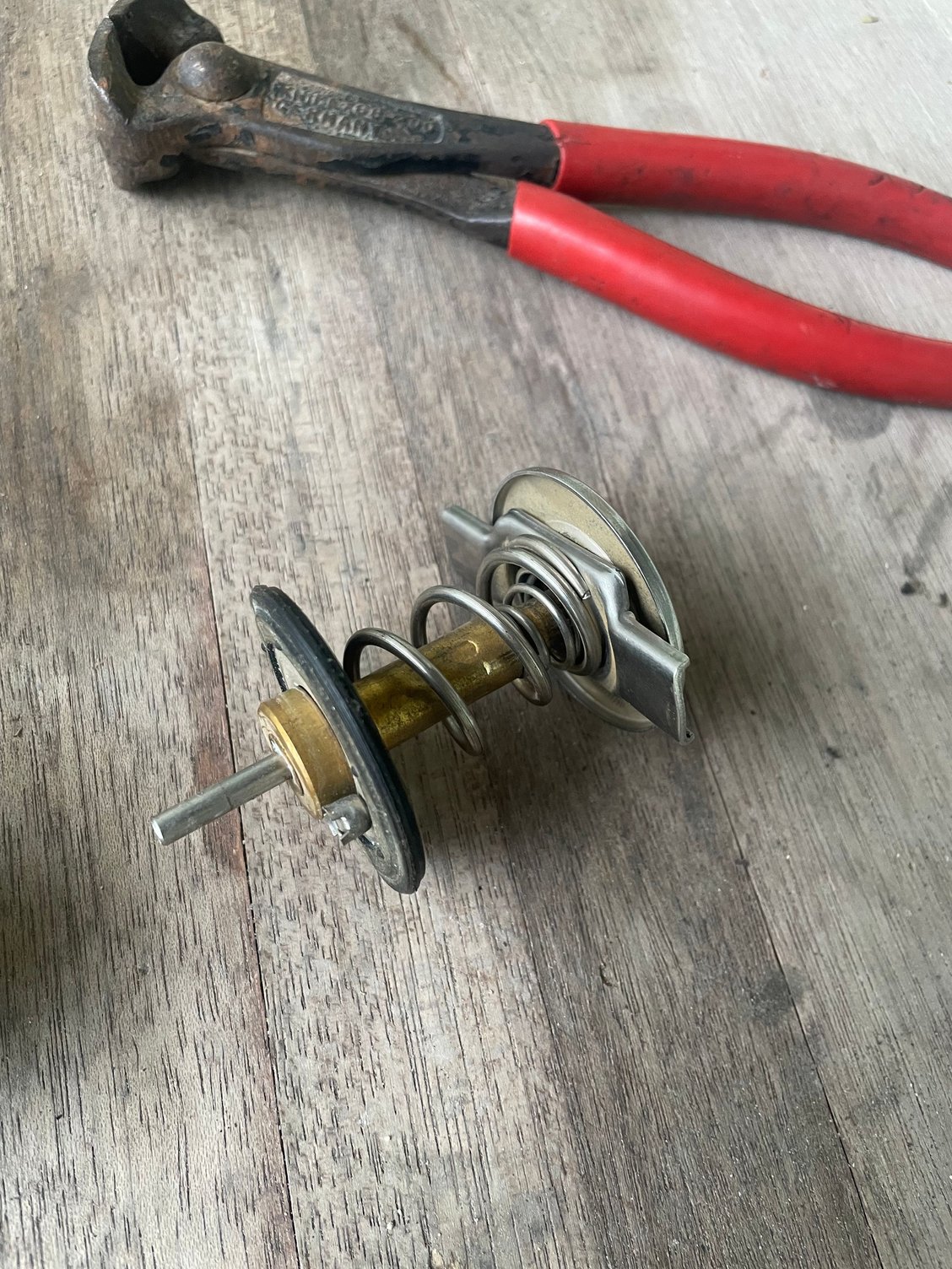

Here it’s ,
so right now I remove the 87c thermostat and install it on 106c housing ,
this is the difference between 87and 106c heated element with circuit,
And coolant sensor that located on rear of the engine had been replaced
sorry about the testing ohms , I read the thread late,
The car still not tested and driven , the fans won’t to run except when i unplug the coolant sensor or the temps go’s above 107c in obd wifi iOS
and when shutting the engine of i hear the fans work
The gauges read 90c
87 housing it has a shaft but no wiring
This is 106c housing

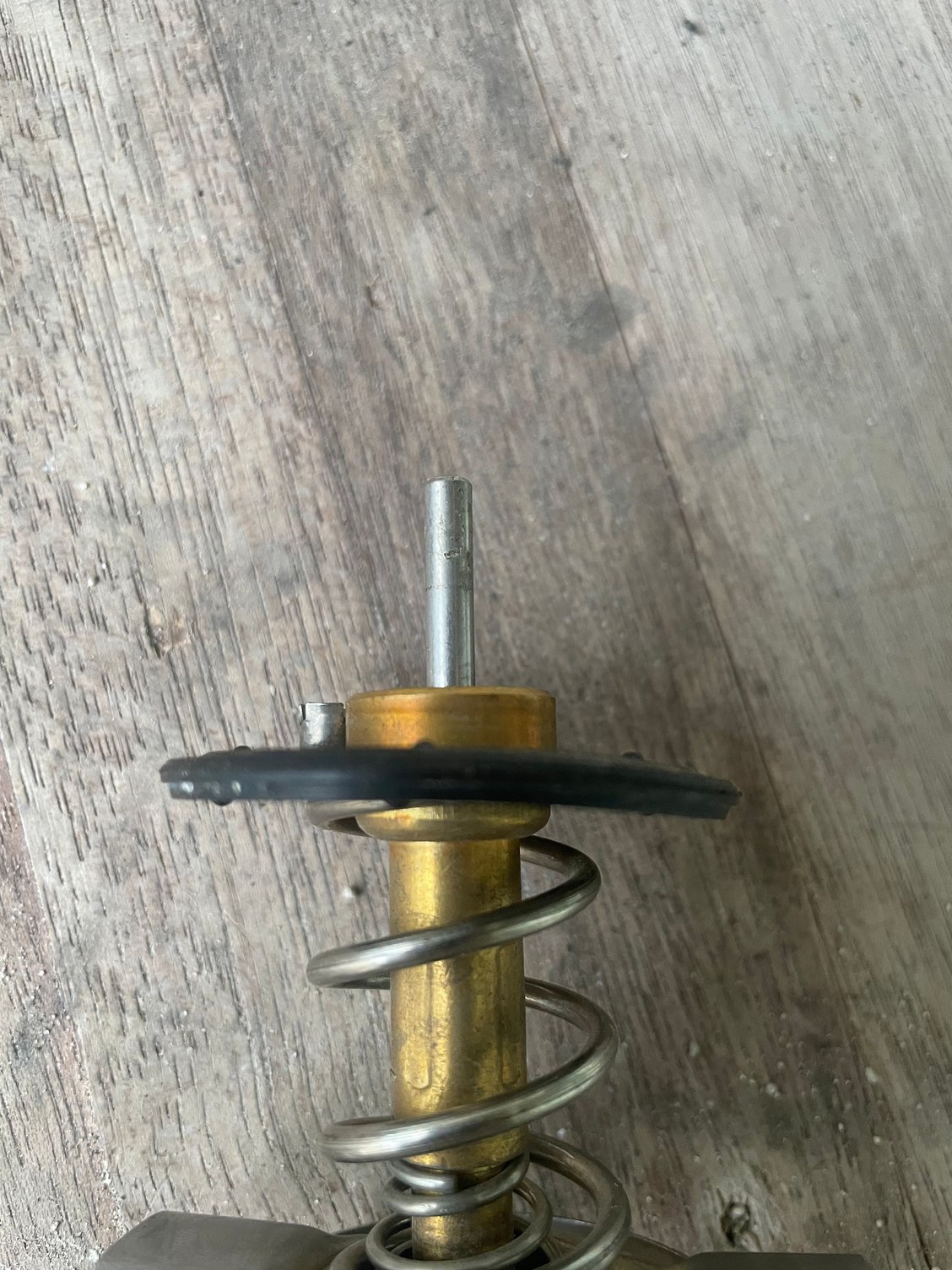

Hello Johnny
as you say
the 87°C non heated thermostat comes with stud/shaft comes out with the thermostat, where is the 100° and 105°C thermostat housings retain stud/ shaft in the housing itself
But about the 87th (non heated) it’s possible to remove the shaft from the thermostat or from the housing itself .
note: never try to remove the shaft from electric heated element thermostat because the shaft already connected to the wiring if you do it will broke up , I test this on the old thermostat (105) before I threw it .

@Owner bentley ,
I do not know what happened to your writing quoted above and in your previous post, very light, hard to read..
Anyway, once again your comments are hard to follow, you said that you gave wrong information before, 100° vs 105°, now you say that you tested removing the heating element from the "old 105°", you don't have an old 105°, I certainly hope that you followed my information and my pictures above, that you infact have the original 100° that you tested removing the heating element from, and not on the as you stated Audi 106° thermostat housing...
PLEASE BE CLEAR.
You were to remove the 87° thermostat and it's shaft from it's 87° marked housing, then pull the shaft out of the 87° thermostat as I previously showed im my pictures, then you were to remove just the "106°" thermostat from it's housing leaving the 106° housing's heating element in place, therefore sliding the 87° thermostat onto the "106°" heating element and securing it in place, please tell me that is what you did.
You say the car is not tested and driven, yet you mentioned temperatures of 107°, and fans not running, etc.
Is the engine back together, thermostat in place, you are not turning on the ignition or powering up the heating element of the thermostat in anyway without it submerged in coolant, are you ?
I asked for detailed history, but you just threw a blanket statement out about everything bad, bad in which way, is the engine original, has it been out of the vehicle chassis, has any work been performed on the engine wiring harness at all ?
If you have the engine all back together and running with coolant filled, is this now were you are seeing 90° on the dash, and 107° on the obd reader, if so, is the engine coolant boiling over, spitting out of the coolant tank, or is it at 90° on the dash, and is the radiator now warm ?
If I understand you correctly, when the engine is idling, the fans are NOT running, if so, what happens when you switch on the AC, make sure the AC is NOT in ECON mode, so when you turn the AC on with all temps set to LOW, do the radiator fans kick on ?
On your model year with the electric heating element fitted thermostat, as is my 2005 A8L W12, the fans barely come on at idle, because the system is designed to run hotter at idle for less pollution, same with the Bentley, they are designed that way, and the gauge on the dash does not even move off of the 12 o'clock position, which is 90°C /194°F on my A8L, because the gauges are set to react to a certain range, or not, not till it gets past a safety point of hotness, then the gauge will show, and warnings will go off.
As far as your fans running after you turn off the engine, this is kind of leading me to believe we are not getting the full story, I have the same exact operation of my fans on the GT, my fans run normal very low speeds if at all at idle on startup, and they operate up and down in speed depending upon engine loads and temperature, BUT, when I turn my engine off, my fans run exactly for 7 minutes, I have timed it quite a few times, my issue is that I have a complete matching 2011 Supersports engine, ECU'S, transmission, instrument cluster, etc package installed in my 2005 GT body with a 2006/07 body wiring harness, and the 2011 engine/ECU'S package wiring harness plugged into a 2005 radiator cooling fan setup, so I know that I am either missing, or I have a problem with one wire, it is yellow and brown, and goes from the ecu's to the fan control modules, BUT, I like the fact that my fans and the after run coolant pumps run for 7 minutes cooling the engine and turbos down, instead of heat soaking everything, BUT, I know that my house battery isn't happy about working for 7 minutes without it's alternator friend supplying power...
Johnny

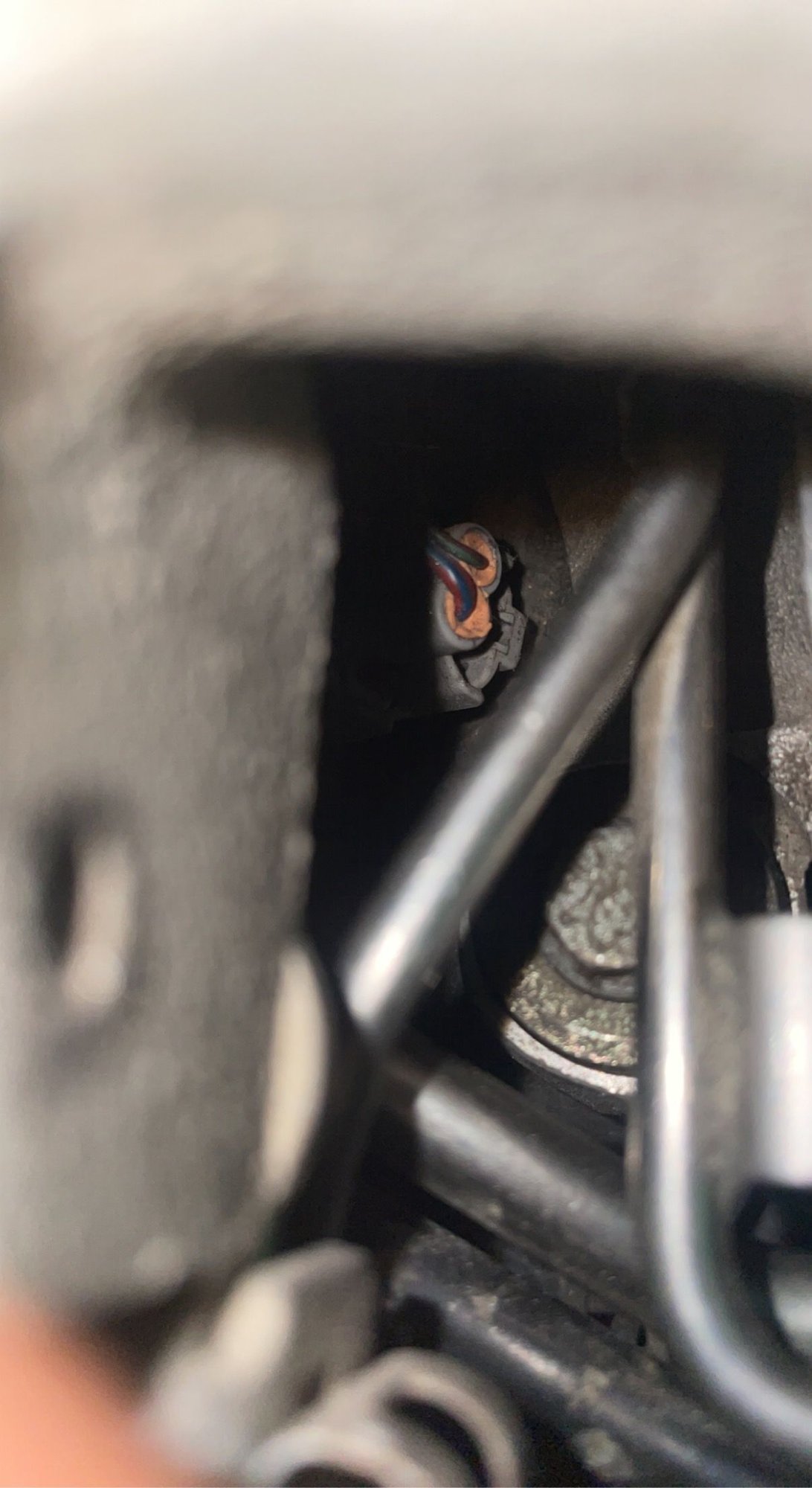

I think one of the wires are swapped !!
They are in incorrect positions
which one is correct
the blue and red wire should be left or right 🧐
