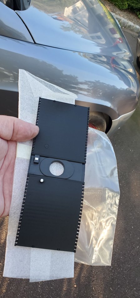

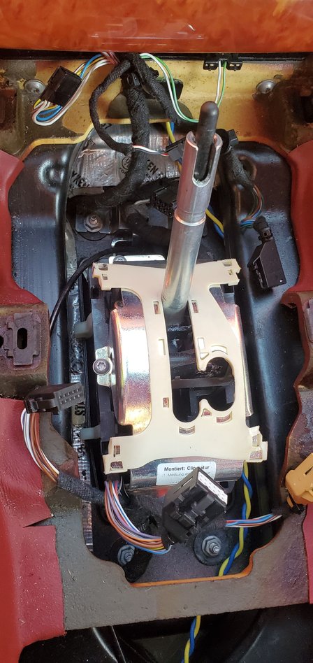

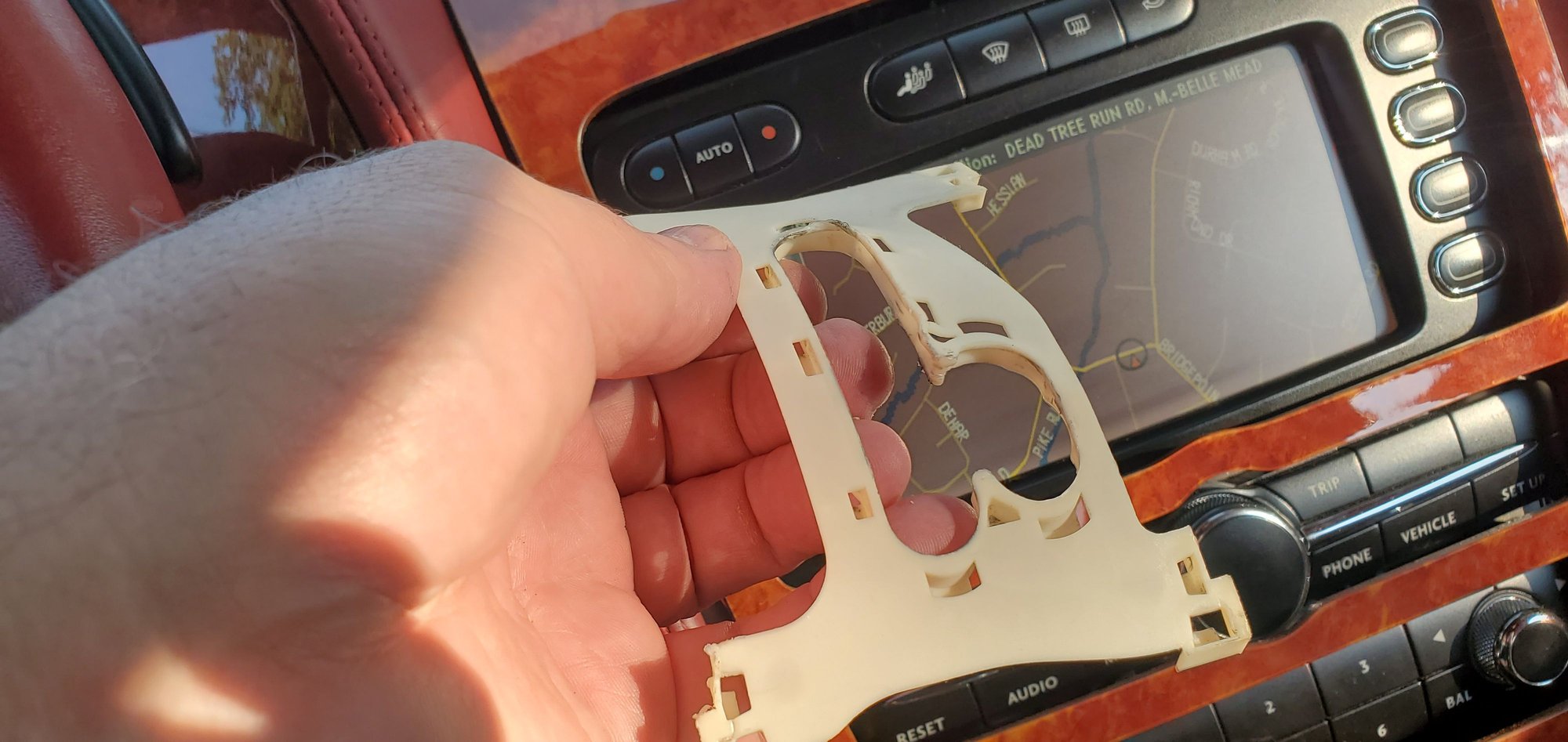

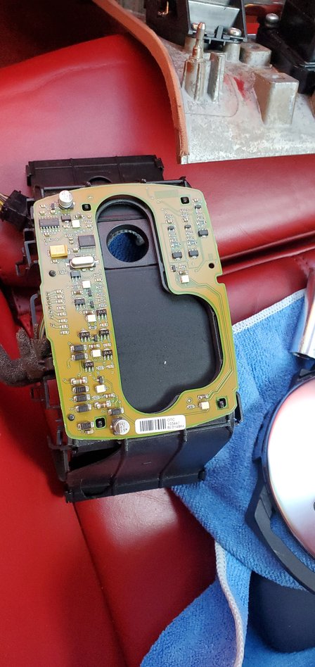

When I replaced my shift dust cover the magnet was seated improperly and there was no indication of the gear selector position. It should be seated firmly and flat. Also be sure that when installing the piece, the ribbed side is down/magnets facing up. A picture of the mis-seated magnet in my old post is here:
https://www.6speedonline.com/forums/...ml#post4840851
