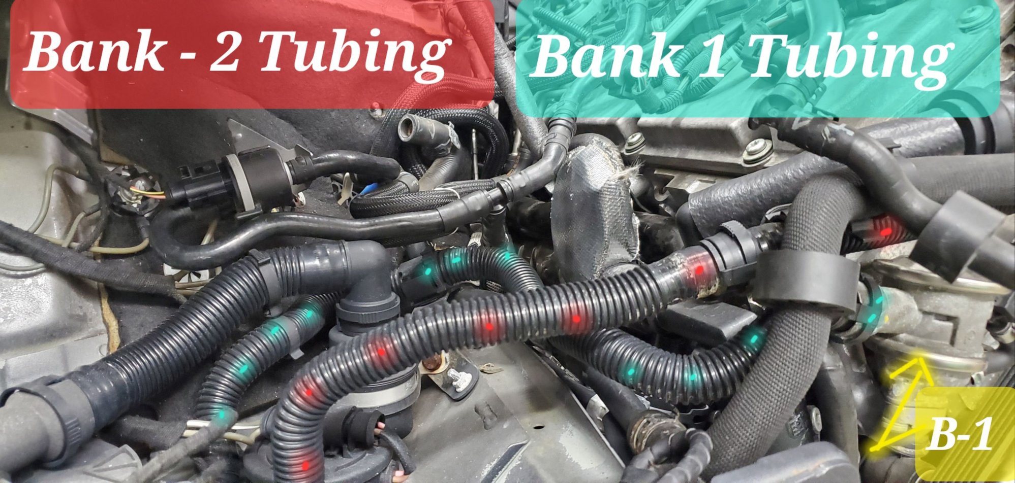

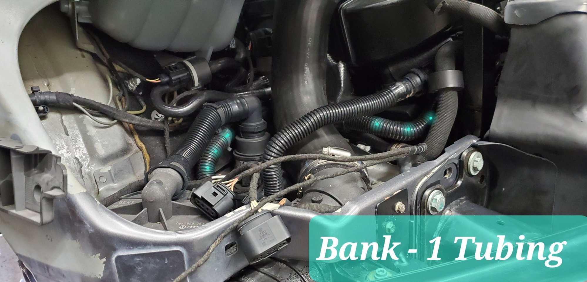

Hi I hope you're fine.
I own a 2010 Bentley Supersport.
here is the default code.
P0491, what do you think of the secondary air circuit??
how can I identify the SAI 1 motor pump from the SAI 2 motor pump? Thank you so much

Hello @yanacha ,
I hope you are doing fine also, besides you SAI issue.
I would first check for the operation of the B-1 SAI pump itself, by checking the fuse # 29, and relay #36, then, or first, check the connection of the tubing at the bank 1 combo valve right at the front of the engine, on the left facing the engine, the tubing does run down under and behind the headlight pocket, I did some color schemes to show which is B1, and B2, check that the tubing is not cracked itself, if the pumps are both running properly, and the connection at the combo valve is good, and the tubing checks out, then check the air intake filter/muffler for and clogging.

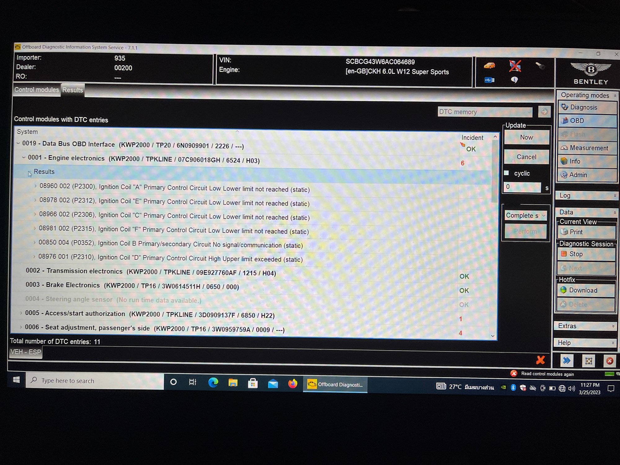

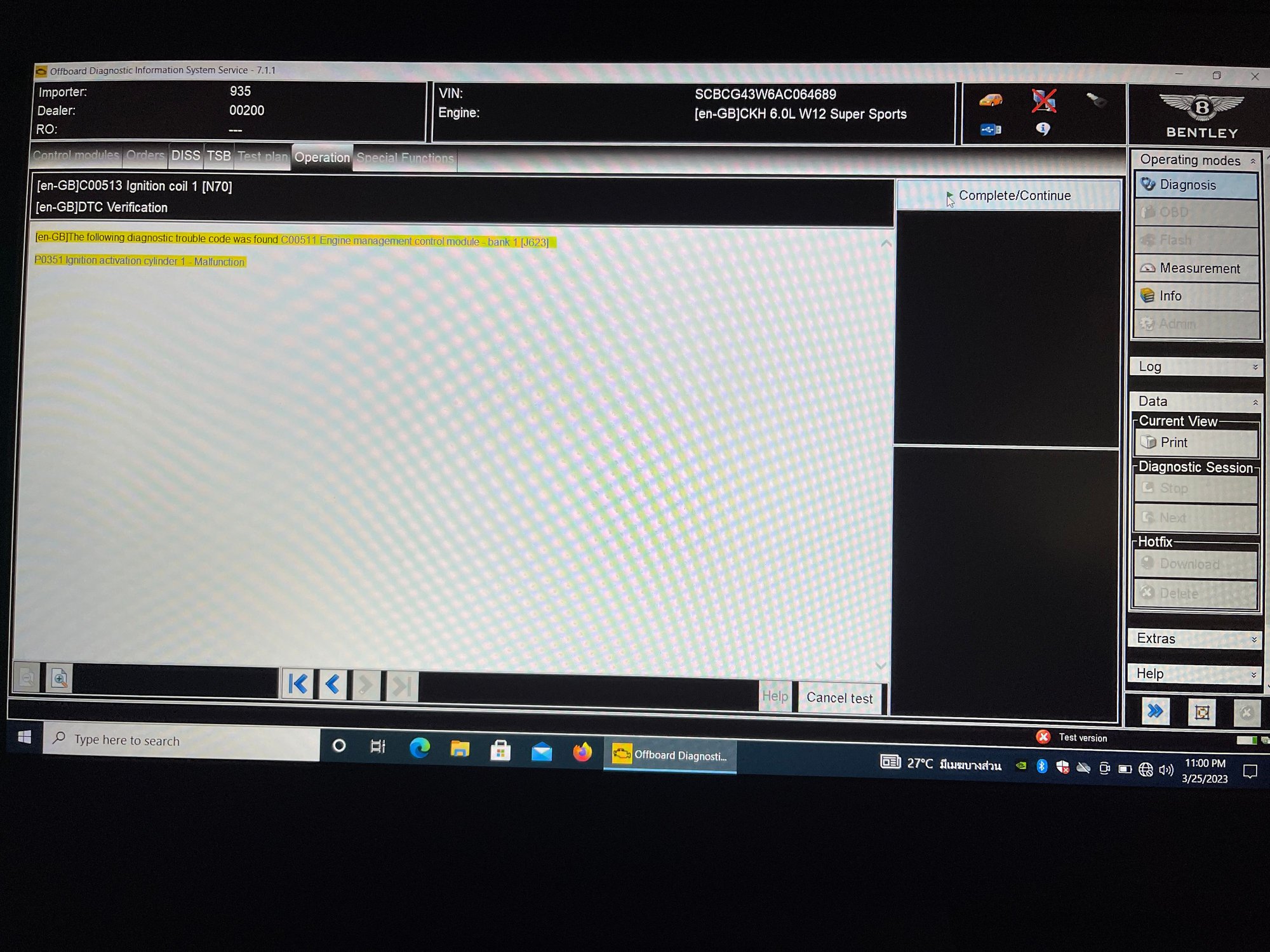

Hi I'm new to the board. My 2010 Super Sports is making me Crazy
About two months ago I developed a bit of exhaust noise on the right side (RHD Car). Turned out to be the gasket after the turbo, so engine was pulled by an independent shop. Changed all the pertinent vacuum lines and all the exhaust gaskets from the front of the turbo back.
Car was test driven and alignment was done, shop said everything was fine. Delivered back on a slide truck, as soon as I started the car to take it off the truck I get en engine light.
I drove it briefly and found it was not running on all cylinders. I ran a scan tool and I got random miss fires on bank 1. I decided to change out the coils which I did myself, and found the connectors were brittle and should be changed, so I got new connectors and swapped in the
existing pins that were in good condition with no signs of corrosion or frayed wires. I then got hold of an ODIS 7.1.1 and ran it and reset all the codes. Started the car & it ran perfectly. Took it for a 15 minute drive, all good, smooth power same as it was before the engine out.
Come back, let it sit for about 5 hours, start it again, engine light & rough idle. Scanned it again & getting faults on all 6 cylinders Bank 1. (Forgot to mention spark plugs were also change when the engine was out, along with the belt & tensioner)Ignition Coil A Primary/secondary Circuit. P0351 No signal/communication
Ignition Coil A Primary/secondary Circuit. P0352 No signal/communication
Ignition Coil A Primary/secondary Circuit. P0356 No signal/communication
849 4 P0351 Ignition Coil A Primary/secondary Circuit (No signal/communication static)
850 4 P0352 Ignition Coil B Primary/Secondary Circuit (No Signal/Communication Intermittent)
These codes do randomly change (see screenshot)
Couln't figure out how to attache the creenshots
Other codes wer as follows
08960 002 (P2300), Ignition Coil "A" Primary Control Circuit Low Lower limit not reached (static)
•08978 002 (P2312), Ignition Coil "E" Primary Control Circuit Low Lower limit not reached (static)
  • 08966 002 (P2306), Ignition Coil "C" Primary Control Circuit Low Lower limit not reached (static)
  • 08981 002 (P2315), Ignition Coil "F" Primary Control Circuit Low Lower limit not reached (static)
• 00850 004 (P0352), Ignition Coil B Primary/secondary Circuit No signal/communication (static)
› 08976 001 (P2310), Ignition Coil "D" Primary Control Circuit High Upper limit exceeded (static)
When I start the car with these codes present I get no heat from the Bank 1 exhaust, but Bank 2 is normal
When I clear the codes, the car runs perfectly, I re-scan with the engine running, no codes, normal exhaust
heat & full power. Test drive the car, all good, park it and scan again. No codes. Next start up after 30 minutes it starts all over again.
The only other code I did get 1 time was a P0491 code, so I ran the test for the fuse/relay & can hear the pump, but I am wondering if it could be the SAI pump sensor or a weak pump
and it causes the ECU to shut down Bank 1 and just stop it from firing the coils.
Any ideas would be much appreciated, I have looked for vacuum leaks, loose or disconnected wires, I cleaned the ECU connectors, checked all the ground wires Etc. I am running out of ideas
short of changing the SAI pump(s) and sensors, and maybe the Kombo valves.
Does anyone know if it's OK to swap the Bank1 /Bank 2 ECU's to eliminate a damaged ECU?
Any help would be greatly appreciated. I have had this car for 5 years & it has been relatively trouble free apart from routine maintenance, but now I am stumped.

As to your issues, I do not see the secondary air injection pump for bank 1 being the issue, I have a SAI fault, it is a wiring issue that I must attend to, but it doesn't stop the engine from running properly, on the other hand, any vacuum leak will cause misfires, but for your whole bank to misfire and then go dead (cold exhaust) as you said, leads me to believe that you have a wiring issue with the coil connection plugs you replaced, which in turn brings up the question of, did you replace all 12 coil connection plugs for banks 1 & 2, and did you replace all 12 coils to match, or did you just do bank 1, and which brand coils did you install ?
As to swapping the ECU'S 1 & 2, I highly suggest that you mark each ECU 1 & 2 as to match the numbers 1 & 2 stickers on the wiring harness plug ends, you don't want to take them out and mix them up, now as to swapping them, I refer to @BWings for that clarification, I recall that a pin #49 may be of a different use, or something to that matter, but if memory serves me correctly, it was BWings that had that conversation with others here.
I myself would swap them to see if the issue goes to bank 2, it may cause another fault, but atleast it would test the firing of cylinders.

Thank you for your input. I did only change the coils & Connectors on Bank 1, I used the original coils from Flying Spares, and ordered the connectors from Audi. I changed the connector housings myself, and I did them one wire at a time, being careful to make sure the pins were in the same sequence. Not sure why there are 2 grounds on each coil connector, but I tested the grounds & ignition leads with a meter, I was unable to test the triggers as I don't have a scope. As there are no issues with Bank 2, I thought it's better to leave them alone. The main issue is that every time I erase the codes
the motor starts & runs perfectly, and will not throw the codes again until the next cold start. This indicates to me that there is no wiring issue, as the engine is able to run normally for a period of time, and makes
good power, no engine light & idles perfectly smooth at 600 rpm. Only when shutting down for more that a few minutes, I will get the issue again on the next start up. I did replace both batteries as well, about a
month before the engine was removed. I am leaning towards a sensor somewhere that has the ability to tell one ecu to shut down, but there are so many sensors & none showing a fault code, I don't know where to start.
