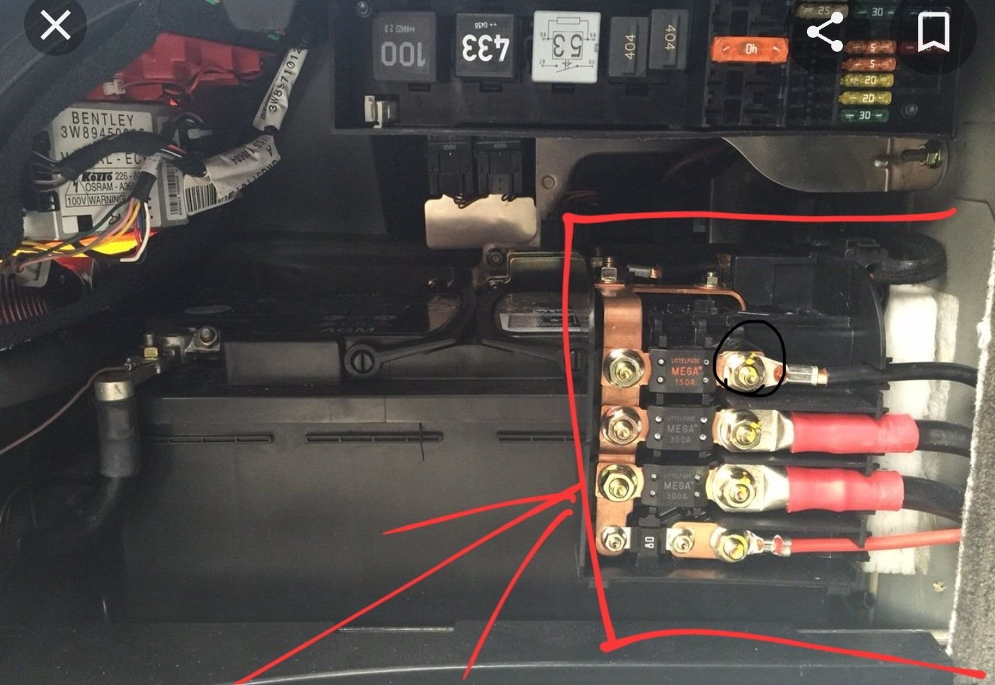

also wanted to ask you what does this cable supple, I tested all of them with voltmeter and this was giving 12v continuously, I must have battery leaking because it drops
first cable with black circle

these are power suppliers for the rest of the car - fuse box in the engine bay, fuse box inside the car, starter, etc.
this car is consuming power all the time - and this is normal if it is below 100mA in the sleep mode.
but when it is wake up it eats much more
what do you mean "it drops"
for the compressor start - if it does not - then check fuse and relay for the compressor and if it ok then try to start it by shorting the power to it to initiate pumping to make sure it is alive but you will end up anyway with vcds tests on the air suspension module
ps. you are sure the leveling sensors are in place connected - if not - the sensor may stay in a possition which is out of range or says to computer that is on highest level so the compressor wont be initiated.

yes I know they supply the front with power, but when I leave the car 10 days no start I test this battery and it’s either very low or dead, other battery is fine no drops, I changed batteries and it’s the same, so I used voltmeter, disconnected those 4 cables and chose DC and connected one side to positive terminal and tried each cable of those 4, 3 came 0.0v and this first shows 12,4v.
so this cable should supply something in the car which is consuming power when it shouldn’t.
level sensors are in place because I double checked them visually.
could you explain more “try to start it by shorting the power to it to initiate pumping to make sure it is alive but you will end up anyway with vcds tests on the air suspension module”
how to shorting the power and if it is alive after is it necessary to use vcds.

i am confused what you did to check voltage - you dont need to disconnect anything to check voltage - you need to do it in you check amperage.
anyway - this cable you are reffering to on the top is to the facial fuse box, so no surprise it gets power
shorting = make the power directly to your compressor omitting any electronic, controls etc to see if motor just runs
vcds = if your air suspension system detects anomalies and fires errors then the system wont start - you need to check these errors clear them check if they come back and if yes you need to fix the problem
you say about battery consumptions so you just have the battery depleted that the electronics gone crazy and you need to power up your battery first - this is super critical before starting any investigations
