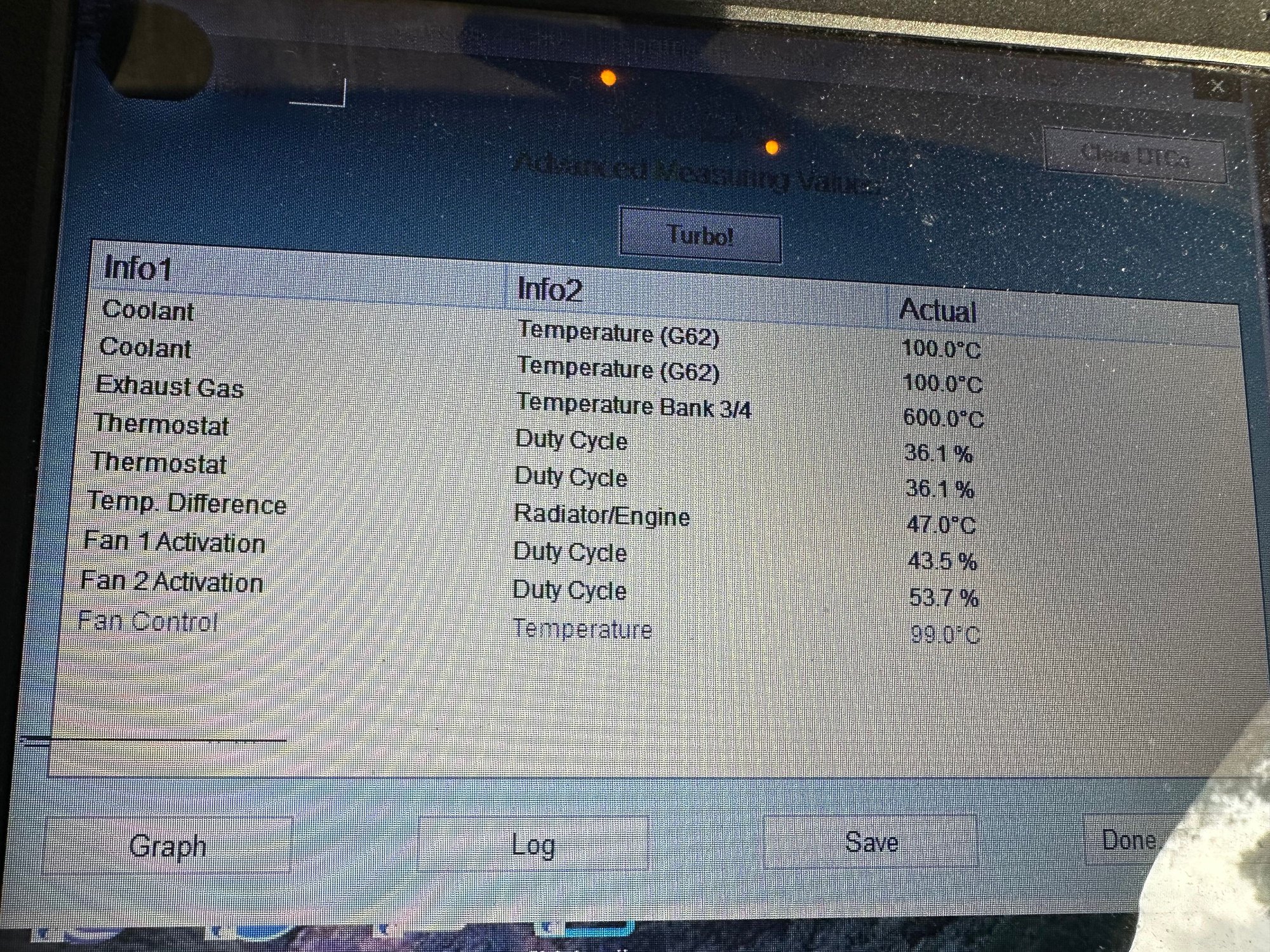

Sorry for the disappearance all this time, I was away and now got my hands on vcds 😎😎
I haven’t worked on the car since installation of the shock absorber mentioned above, here is the scan result of the vcds
@Johnny Hotspur GT @sazam
Address 01: Engine Labels: 07C-906-018-BEB1.clb
Part No: 07C 906 018 AE
Component: BY-6.0L-TT G ª6485
Revision: 63ÿTT Serial number: 000-00010.09.
Coding: 0000173
Shop #: WSC 00000 000 00000
VCID: 6889B8BD3E60259AA73-5160
VINID: 8D34935460E70454C008600424D5A7B019
1 Fault Found
16929 - Sensor 1 for Exhaust Temp Bank 1 (G235)
P0545 - 002 - Short to Ground
Readiness: 0110 1001
Address 02: Auto Trans Labels: None
Part No SW: 09E 927 760 C HW: GS1 904 1
Component: AG6 09E 6.0L W12TT 1903
Coding: 0000101
Shop #: WSC 00083 000 00000
VCID: 303910DDC630AD5ABF3-5160
No fault code found.
Address 03: ABS Brakes Labels: 3W0-614-517-V1.lbl
Part No: 3W0 614 517 D
Component: ESP 5.7 4WD H01 0021
Coding: 0007878
Shop #: WSC 52967 000 00000
VCID: 363526C52454836AE5F-5160
2 Faults Found
01314 - Engine Control Module
013 - Check DTC Memory - Intermittent
01826 - Sensor for Steering Angle (G85); Supply Voltage Terminal 30
000 - -
Address 07: Control Head Labels: 3D0-035-00x-07.lbl
Part No: 3W0 035 007 G
Component: ZAB COCKPIT 0223
Coding: 0400335
VCID: 303910DDC630AD5ABF3-5132
7 Faults Found
01303 - Telephone Transceiver (R36)
004 - No Signal/Communication
01334 - Door Control Module; Rear Right (J389)
00668 - Supply Voltage Terminal 30
002 - Lower Limit Exceeded - Intermittent
01305 - Databus for Infotainment
014 - Defective - Intermittent
00385 - Positive Output Audio Channel for Speech/Telephone
012 - Electrical Fault in Circuit - Intermittent
00386 - Negative Output Audio Channel for Speech/Telephone
00856 - Radio Antenna
007 - Short to Ground - Intermittent
Address 08: Auto HVAC Labels: None
Part No: 3W0 907 040 B
Component: Climatronic BY614 0030
Coding: 0000001
Address 09: Cent. Elect. Labels: 3D0-937-049-V1.clb
Part No: 3D0 937 049 H
Component: STG.Bordnetz 5101
Coding: 0000107
VCID: 2F3B13A1DB0EB2A2A69-5160
2 Faults Found
00907 - Intervention load Management
000 - -
Address 11: Engine II Labels: None
Revision: 62ÿTT Serial number: 000-00010.09.
Coding: 0000173
Address 15: Airbags Labels: 3D0-909-601.lbl
Part No: 3D0 909 601 E
Component: 0P Airbag 8.4E+ H10 0936
Coding: 0012368
VCID: 2517F18989F2F8F25C5-5160
Address 16: Steering wheel Labels: 3D0-953-549.lbl
Part No: 3D0 953 549 D
Component: Lenksäulenmodul 3401
Coding: 0000012
VCID: 2E050EA5DC04BBAAADF-5160
Address 17: Instruments Labels: 3Wx-920-xxx-17.lbl
Part No: 3W0 920 840 T
Component: KOMBIINSTRUMENT RB8 0514
Coding: 0023103
Shop #: WSC 07820 107 60924
VCID: 45D7510969B218F27C5-5160
1 Fault Found
Address 19: CAN Gateway Labels: Redir Fail!
Part No: 6N0 909 901
Component: Gateway K<>CAN 0101
Coding: 0000006
VCID: 70B9D0DD06B0ED5AFF3-5132
7 Faults Found
00778 - Steering Angle Sensor (G85)
004 - No Signal/Communication - Intermittent
00908 - Control Module for Wiper Motor
01308 - Control Module for Roof Electronics (J528)
00467 - TV Tuner (R78)
02174 - Analog/Digital clock
Address 34: Level Control Labels: None
Part No: 3W0 907 553
Component: LUFTFDR.-CDC- 3C1V0 7014
Coding: 0015500
Shop #: WSC 00999 444 64523
VCID: 77ABEBC163DEBA623E9-5160
3 Faults Found
01437 - Control Position not Learned
005 - No or Incorrect Basic Setting / Adaptation
01575 - Control Switched Off
000 - -
Address 36: Seat Mem. Drvr Labels: None
Part No: 3W0 959 760 A
Component: CM Seat Driver 0008
Coding: 0000002
Shop #: WSC 07645 001 1048576
VCID: 3FDB43E10B6E4222369-5160
7 Faults Found
02569 - Control Module for Massage (J740)
009 - Open or Short to Ground - Intermittent
00457 - Central Electronics Control Module / BCM (J519)
00477 - Control Module; Display & Input; Comfort CAN; Front (J523)
00997 - Motor for Driver's Seat Position; Fore/Aft (V48)
01174 - Driver Seat Height Adjustment Motor (V138)
00998 - Motor for Driver's Seat Recline (V45)
Address 37: Navigation Labels: None
Part No: 3W0 919 887 B
Component: NAVIGATION 0168
Coding: 0400000
VCID: 46D5560554B413EA75F-5160
2 Faults Found
Address 38: Roof Electronics Labels: None
Part No: 3W0 907 135 C
Component: Dachmodul 0703
Coding: 0000157
1 Fault Found
00926 - Terminal 30
Address 46: Central Conv. Labels: None
Part No: 3D0 959 933 F
Component: 1Y HSG 0101
Coding: 0000032
Shop #: WSC 00082 106 125727
VCID: 33331FD137269642C21-4B1E
Subsystem 1 - Part No: 3W1 959 701
Component: Tuersteuergeraet FS 0702
Subsystem 2 - Part No: 3W1 959 702
Component: Tuersteuergeraet BF 0702
Subsystem 3 - Part No: 3W8 959 703 A
Component: Tuersteuergeraet HL 1002
Subsystem 4 - Component: TSG HR No Answer
Subsystem 5 - Part No: 7L0 907 719
Component: Neigungssensor 0020
12 Faults Found
01341 - Control Module in Instrument Panel On Comfort CAN (J285)
00576 - Terminal 15
008 - Implausible Signal - Intermittent
01503 - Bulb for 3rd Brake Light (M25)
00316 - Bulbs for Rear Illumination
00932 - Electric Window Motor; Drivers Side (V147)
00929 - Locking Module for Central Locking; Front Passenger Side (F221)
00934 - Electric Window Motor; Rear Left (V26)
005 - No or Incorrect Basic Setting / Adaptation - Intermittent
Address 47: Sound System Labels: 7Lx-035-4xx-47.lbl
Part No: 3W0 035 456 C
Component: 12K-AUDIOVERST 4121
VCID: 34311CCD3228917ADBB-5160
Address 53: Parking Brake Labels: 3W0-907-801.clb
Part No SW: 3W0 907 801 A HW: 4E0 907 801
Component: EPB BC6HX21 HC6 X210
Coding: 0022413
Address 54: Rear Spoiler Labels: 1C0-959-733.lbl
Part No: 1C0 959 733 H
Component: Heckspoiler 0002
VCID: 303910DDC330AD5ABF3-51A6
Address 57: TV Tuner Labels: 3D0-919-146.lbl
Part No: 3D0 919 146
Component: TV Tuner H07 1205
Coding: 0000010
VCID: 6597B189C97238F29C5-5160
1 Fault Found

I have managed to raise the car using vcds, took me a while but succeeded at the end.
Regarding the smoke, a friend of mine works as a mechanic but not with big engines checked the smoke and confirmed it’s oil burning, and suggested to look for vvt solenoids or pcv as he said this could be the problem.
I remember when I started the car first there was no smoke at all, switched off then turned the car on again and I heard a blow sound inside the encounter like a balloon exploded and immediately smoke started to come out.
could his diagnosis be accurate, if so would you mind guys to instruct me how to check them/replace needed parts.
thanks a millions for all the help provided

I just checked the car again, first try to start the car it shows immobile activated, car starts and cuts in 2 seconds, tried second key and it worked successfully
I checked all spark connectors and no evidence of oil in the connectors( did not remove spark plugs)
double checked all wires, all good so far
the smoke is still coming from exhaust of driver side only, scanned via vcds- image attached-
exhaust temp sen 1 p0545
Could this be causing the grey smoke from driver side ??
if yes, is there any cross reference part to replace it cuz on flyingspares it’s quite expensive.
and would need help to resolve immobile activate thing 😅 I would assume I need to visit a dealer 😒😒
I haven’t drive the car to test the level height, car parked in my garage and no I can’t change level so far, vcds helped me to level the car and output test managed to test pump and 4 suspensions, no leaks detected via soupy water test after rebuilt.

after I forced the car to go up and down via vcds, and then drove it a while, now it changed the level 100%, upon scanning via vcds it shows level is not learned, so I guess I must do adaptation with vcds, which I need the security access for this ( any help appreciated)
one strange things is happening while the car is running which is overheating, coolant cap was replaced oem and attached pic showing parameters for coolant, yet the car is overheating even when thermostats os functioning as in the pic attach.
hopefully is not the head gasket needs to be replaced
any suggestions for this matter @Johnny Hotspur GT
