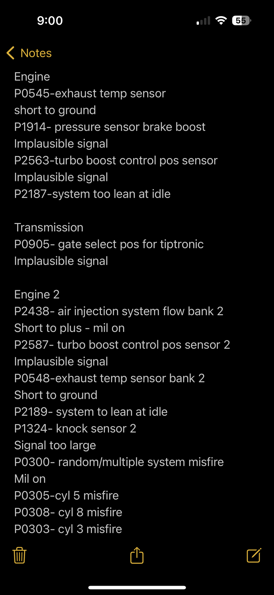

Ok guys,
got my Ross-tech and here are my codes that it read I broke them all out with fault code and description. Any help on anything would me great!

hi,
clear all errors and rescan to see only the ones which are actual.
unless that are actual.

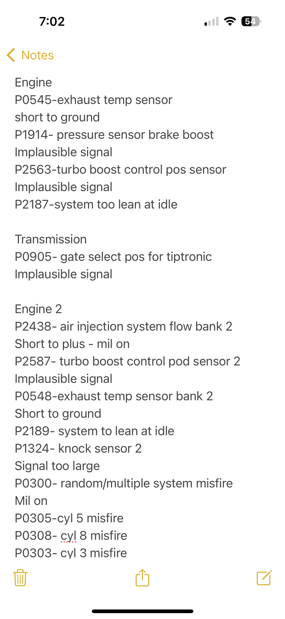

Cleared the codes, batteries are at 100%. Still getting codes (see pic attached). I did verify the exhaust temp sensors are bad and have ordered those. As far as the others guys have any suggestions or what parts and where to buy?
thanks Again

too much errors which may indicate vacuum leak issue.
do you have any physical symptomps - your car is weak? hangs/delayed reactions on acceleration, floating rpms?
you have to do the smoke test if not done yet.
pls share with us your steps etc to fix the problems - it is super interesting. looking forward to see your info regarding egt sensors replacement

Ok guys needing a little more help, got the exhaust temp codes for both banks to go away with new sensors. And I had two vacuum leaks both were top plastic hose cracks up behind intake manifold and those have been repaired.
i cleared everything and drove the car for about 40 miles and had the engine light come back again. Scanned with my rosstech and here is what i have
p2563 & 2587
p0300 0303 0305 0308
what should i look at next?
thanks again guys for the help with this

Hello,
Inorder to rule out unnecessary replacement of parts a smoke test is recommended. The listed codes are likely another vacume leak. The cracked vacume lines that you repaired highlight the overall condition of the lines. The "V" lines are brittle and beginning to leak somewhere else. The EGT replacement was an unrelated problem that is typical of these cars of that age...to be clear.
