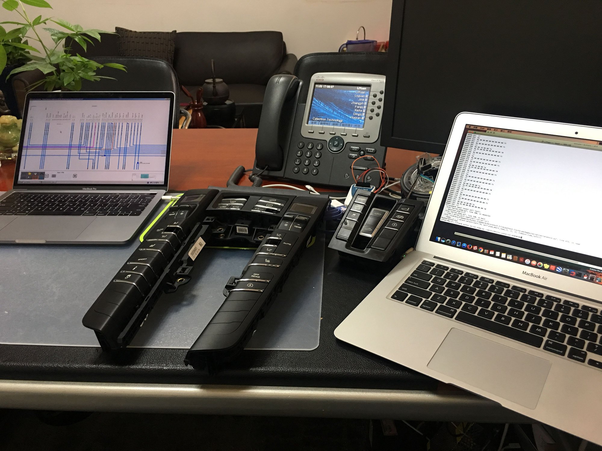

Originally Posted by liybalance
https://youtu.be/R5o_NGnRkDM
Mode switch dial can't support change S S+ now,because old clock spring control module didn't support process mode switch dial signal.I'am developing process and transfer dial switch signal to center console adapter by Bluetooth,center console adapter inject S S+ signal to control module.This feature will support at 991.1 and 958 first,970 center console button module works mechanism restricted,need more research.
https://gpsadapter.us/blogs/news/my-...steering-wheel
Very Nice project !! i will wait until the dial switch is functional

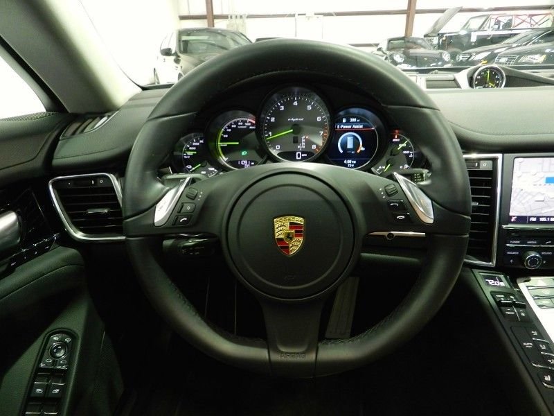

Before and After...What color top center band would you prefer if it were you?
My 2014 came like the picture above. I got this red one below as a gift. To make this work, I had to order the adapter kit from Paul Li. Thank you Paul.
To keep the heated function, I have to replace this little surface mount resistor.
Red is nice, but my interior is black. I have to do something about it. Oh well, since it's a e-Hybrid, might as well go green.
After hours of struggle, here is the final product. Now that I am a pro, I am available to do the install for anyone who are interested in the U.S. Please PM Paul or myself. If you are in Atlanta, I can even do the complete job for you.

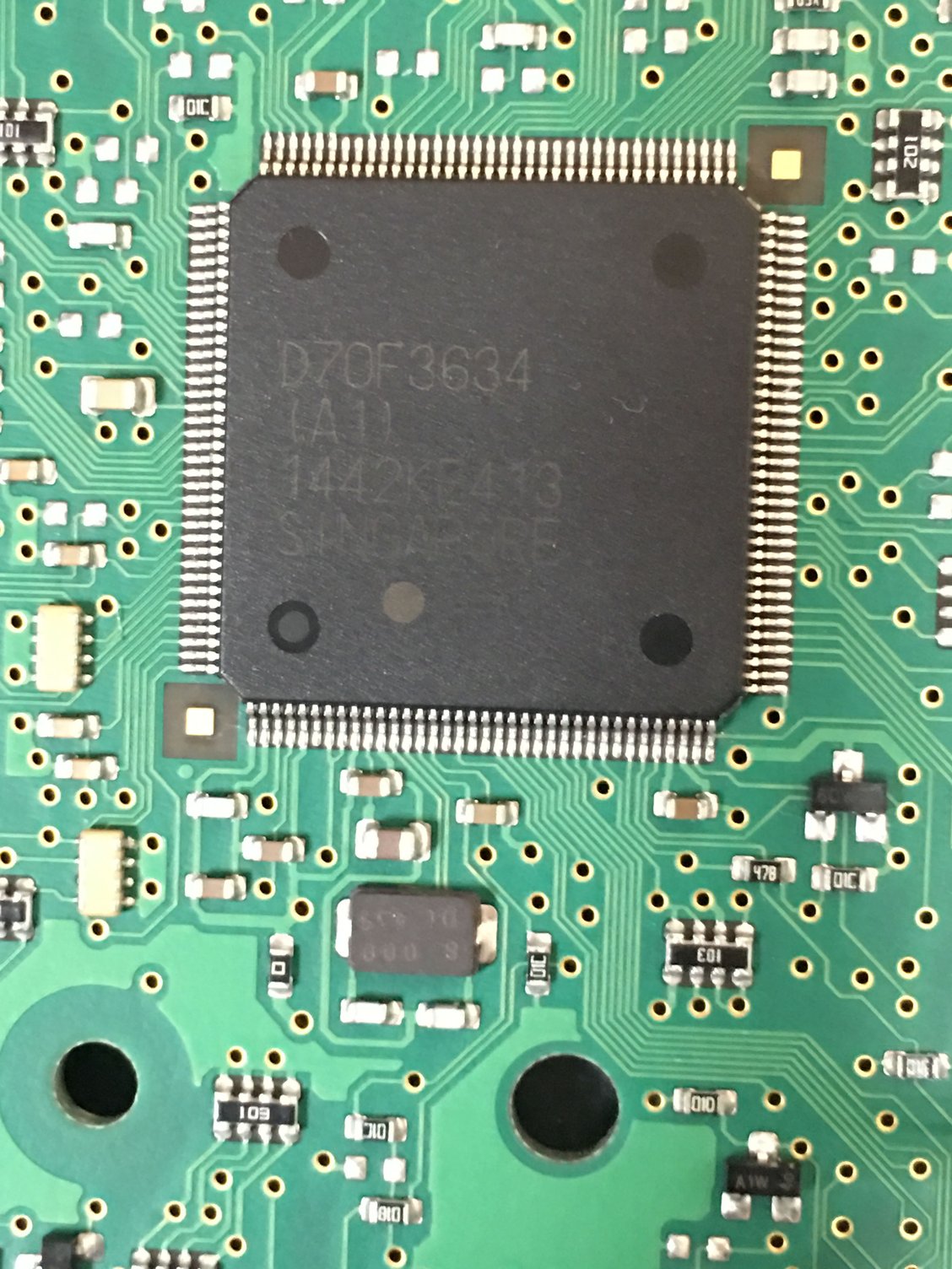

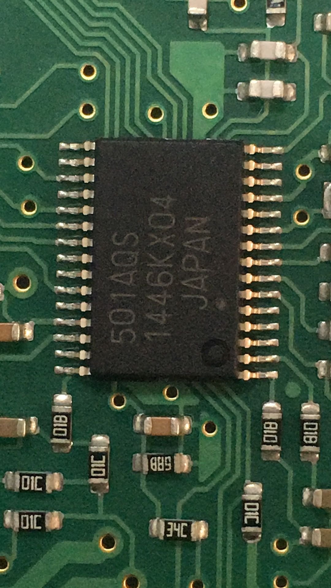

Have a big challenge developing dial support,panamera and macan connect sport mode keyboard to central control module use MCU to MCU link(Maybe use SPI or I2C),can't find those two MCU chip data sheet.It's NEC chips.Anybody could help me find chips data sheets?
Can't find data sheets about this button control chip.
NEC MCU,can't find data sheets about this MCU
