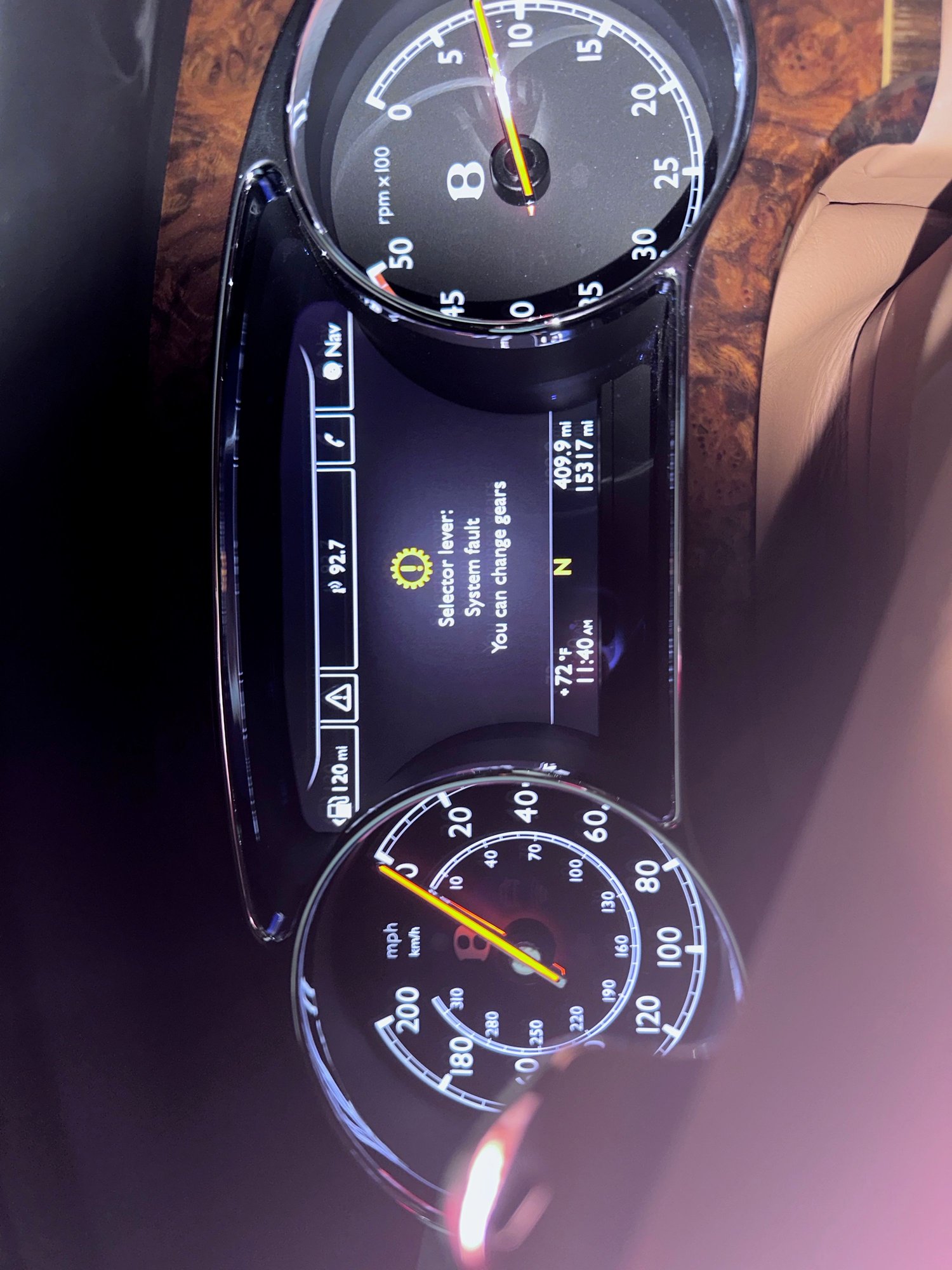

I purchased a 2012 Mulsanne in May 2022. I drove the car for about a week and used the paddle shifters for the first time . Then an Orange shifter unlock button warning light appeared in the center screen in the dashboard. The Orange warning light has an exclamation point with a dashes encircling the !
My Ross Tech VCDS shows "Address 81: Gear Shift (J587) Labels: 3Y0-927-731.clb Part No SW: 3Y0 927 731 A." 4.9 V
1 Fault Found
10022 Unlock Button
P17EC 00 [137] - Electrical Malfunction
Has anyone had this problem? How did you clear the code. Any advice to solve the problem would be greatly appreciated too. Thank you.

So, here it is again, the 2010 to 2013 Audi A8L/W12 had the same issue according to customer complaints, there was/is a software update to the shifter control module (81), whereas the software version changes from version 81, to version 83, it would be interesting to see your software version, so, could you post a screenshot of all of the RT VCDS information as shown in the Audi A8L W12 screenshot below, I would also check in with your local Bentley dealership for the status of any such software update for your Mulsanne.

The car runs and drives like everything is OK except for the Orange gear and !. The message that comes on the dash when you first start the car in in the photo below. The file from the scan is also attached.
I read the technical memo for the Audi you attached? The Mulsanne has a very similar message to the Audi message.
