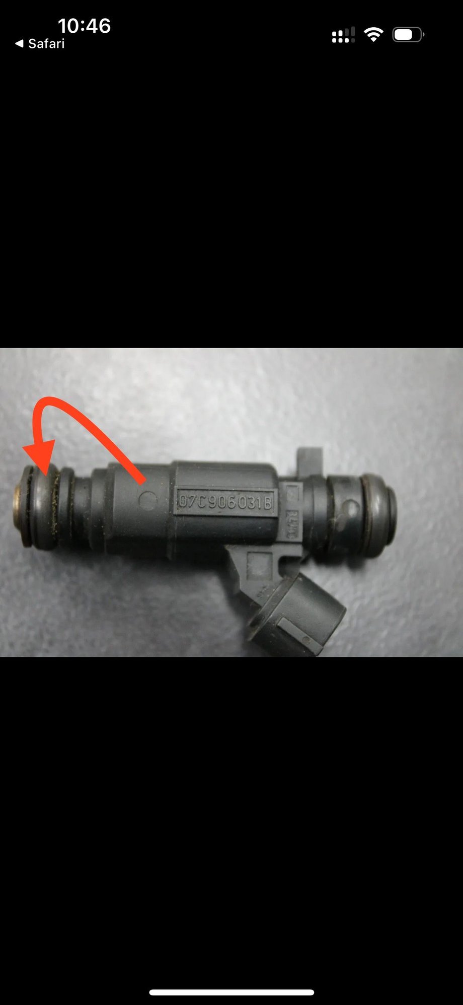

Can you olease share pictures ?
red arrow, this was my case, won’t hurt to double check yours
