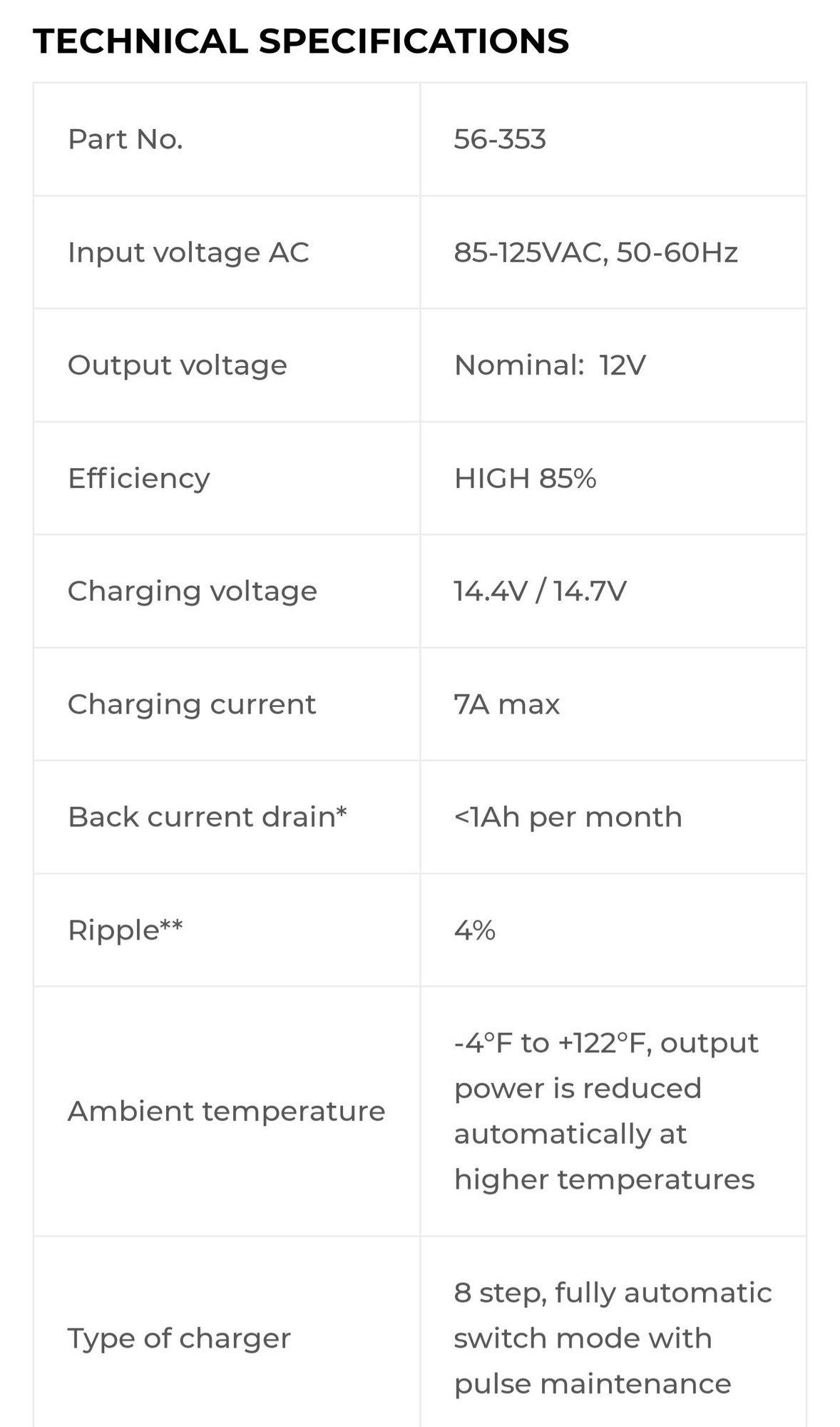

What are you using for a charger, I had the same issue last night, somebody unplugged my CTEK US 7002, therefore my house battery was stone dead, the CTEK, eventhough it appeared to be charging, could not do the job, even after an hour plus, the house battery would barely light the trunk and interior lights, I had to hit the ignition to the left a few times to engage the parallel solenoid, then my trunk latch locked on it's own, the alarm kept going off, I had to run up to the shop to grab my other charger, I gave the house battery a couple of 75 amp charges for 3 minutes at a time, then set it to 10 amp charge / maintain, then by pushing the boot close button, the lock mechanism went through it's cycles and reset itself, all good now as for as lid operation.

Well, the CTEK is still charging the main/starter battery - so I guess thats a good sign. I had the ctek (maserati branded) hooked up to the magnetic charger overnight. I came out this AM to see a RED led indicating no charging.
I'm hoping that the starter will get teh car running, but if the main battery is DEAD - wont that throw all sorts of codes? as the the car needs the main battery to run?
I dont want to worsen the predicament. I have a regular old school schumaker charger. I heard that AGM batetries need a special charger for them to not fry a battery. Truth or fiction?

Just to clarify, as you just stated that your CTEK is still charging the "main/starter battery", not batteries, or the house battery, versus the starter battery, I just want to be clear that you are charging the battery on the left facing the trunk, that is the house battery, the right side battery is strictly the starter battery, or it becomes the emergency backup by way of parallel solenoid switch, just as, if the starter battery was dead, then by turning the ignition key to the left the same would happen for the starter battery, the house battery in parallel then sends power to the starter battery to start the engine, I hope I didn't make that confusing 😳.
Once the engine is running, the alternator is putting out the power to run all accessories, the vehicle is not just running off of the house battery, the alternator and the battery work together.
As to a special charger, the CTEK US 7002 says that it does "Wet, MF, AGM, GEL, and Ca", so I am not so sure on a specific charger needed, I have used my standard 2/6/10/75 AMP charger with maintenance cycle on both the standard and AGM batteries, I have seen no issues.

Two things, being that your charger is kicking off, as in, it cant supply the demand required, then remove both negative cables from their batteries, then try your charger on the house battery, your may have an issue with a large draw from the vehicle, therefore kicking out your charger, or the house battery may have internally shorted, therefore kicking your charger off, so let's test that.

Ok, so I got home and the starter battery got fully charged with the CTEK. I picked up a new H8 and a new style AGM compatible charger. I hooked that one up to the main battery and saw it had 6.8V. The slow charge got it to 7.6V in a few minutes. There was none of the weird relay sounds or anything. This was a huge plus.
Then I understood what @Johnny Hotspur GT was talking about re: the alarm going off. that started. Then I saw light on in the car, and the ignition released my KEY!
I Think im making progress. I'll let this new charger run its 30A boost mode, then it will drop into trickle mode. I'm hoping that the H8 battery can be saved. Hopefully...it can. At any rate. I've learned a LOT of lessons through this all!
UPDATE: Battery is not holding a charge, its back to 6.5. i think its toast....kwaaa kwaaaaaaa
