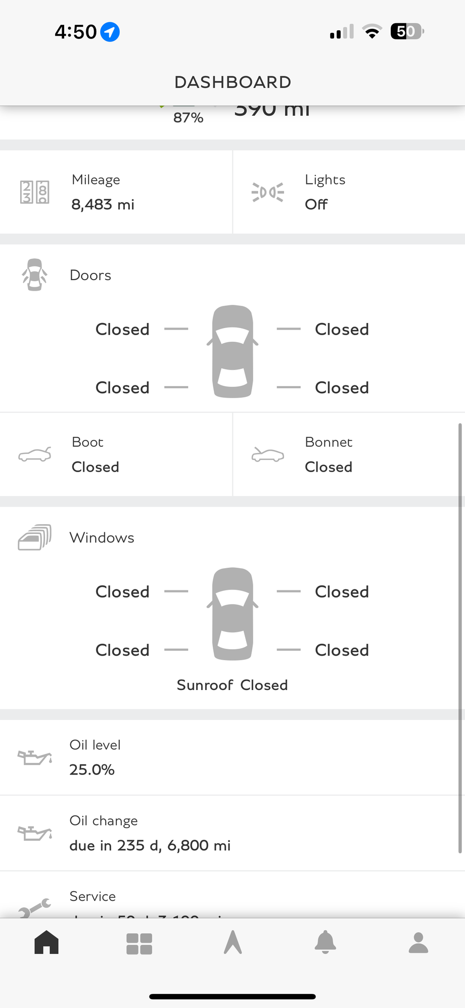

Bentayga Low Oil
My 2020 Bentayga V8 showed the oil level bar at the bottom(maybe 25%) but it didn’t actually show up as a warning or anything. The car has had an oil change in November and has only been driven 2,500 miles since. It doesn’t look like it’s leaking as the level has been the same for a while now. Should I get it topped off or is this normal? The car has 8,500 miles.

No the engine was fully warm and it shows the same reading everyday. Especially in the app, it shows 12.5% when cold and 25% when warm. But there are no actual warnings or anything saying that the oil is low.

Thanks Johnny. I will upload a picture right now with the readings.

Sorry for the late response now the oil level is even lower. On the app it shows 0% and it shows just a little bit in the display screen. There is still no low oil light. Also in the manual it doesn’t show anything about oil level or percentage.

*UPDATE* I got a low oil warning today. It said add oil max 2 quarts. You may continue driving. I attached 2 pics.
