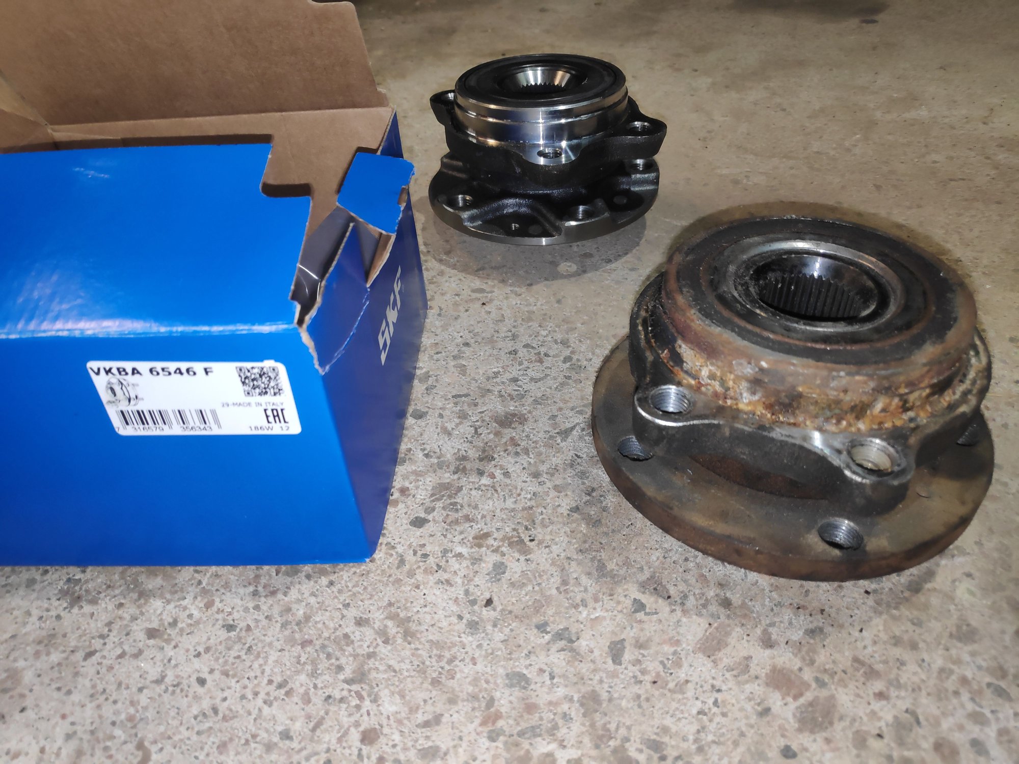

On our Easter trip up north the very slight wheel bearing noise escalated, eventually to a howling every time there was a right turn on the road. So it was time for a replacement. After some research I concluded that the Phaeton/A8 bearing a local parts shop had in stock will probably fit so instead of ordering one online and waiting for shipping, I got to work right away.
Visual inspection and side-by-side comparison was promising. All measurements are identical.
SKF doesn't state that this bearing (VKBA 6546 F) will fit Bentley applications but it does. The only additional step required is to drill a new hole to the brake rotor securing screw. You can see the original hole in the bearing through the screw hole at 9:30 o'clock and the one I drilled and tapped at the top, with the screw in place. A 5mm CO5 drill bit and M6 tap made it a one-minute fix.
I took the car to a 10-mile spin last night and everything works perfectly. Even the slight brake vibration I've experienced earlier was completely gone.
Perfect.

great finding - how you concluded? any info from internet, smb confirmed they mount this to bentley and no complains? or you just did a blind shot and took measures (all of them are exactly the same???)
hope the only diff is the hole you had to drill and the material is exactly the same quality.

A tiny bit of background work comparing the dimensions and coming to a conclusion that it most likely is an identical part without the most expensive bit, ie. "Bentley" -labeled cardboard box.
SKF bearings are of very high quality, I most likely wouldn't have attempted this with a generic shop brand bearing. Drilling the hole with a regular HSS bit didn't work and I had to switch to CO5 cobalt + cutting oil so the materials are pretty tough.
It's even possible that SKF is an OEM manufacturer for Bentley because their customer service declined any further conversation when it came up that the bearing is going to a Flying spur.
