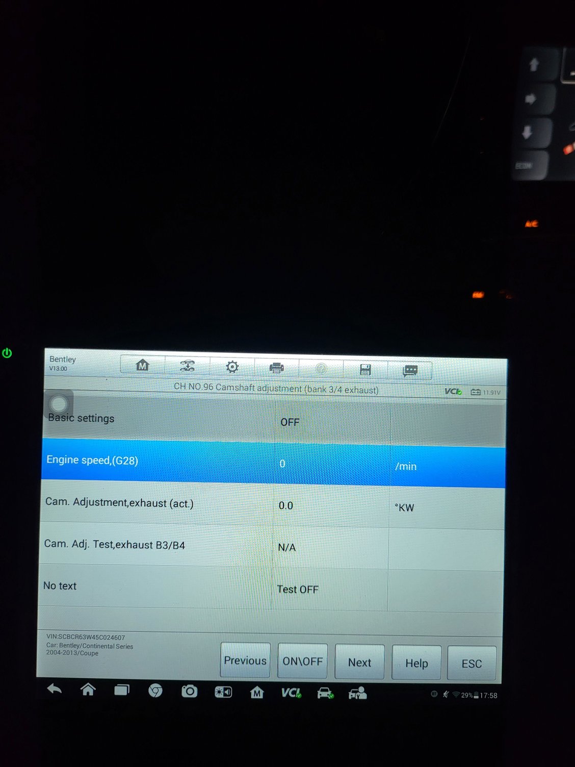

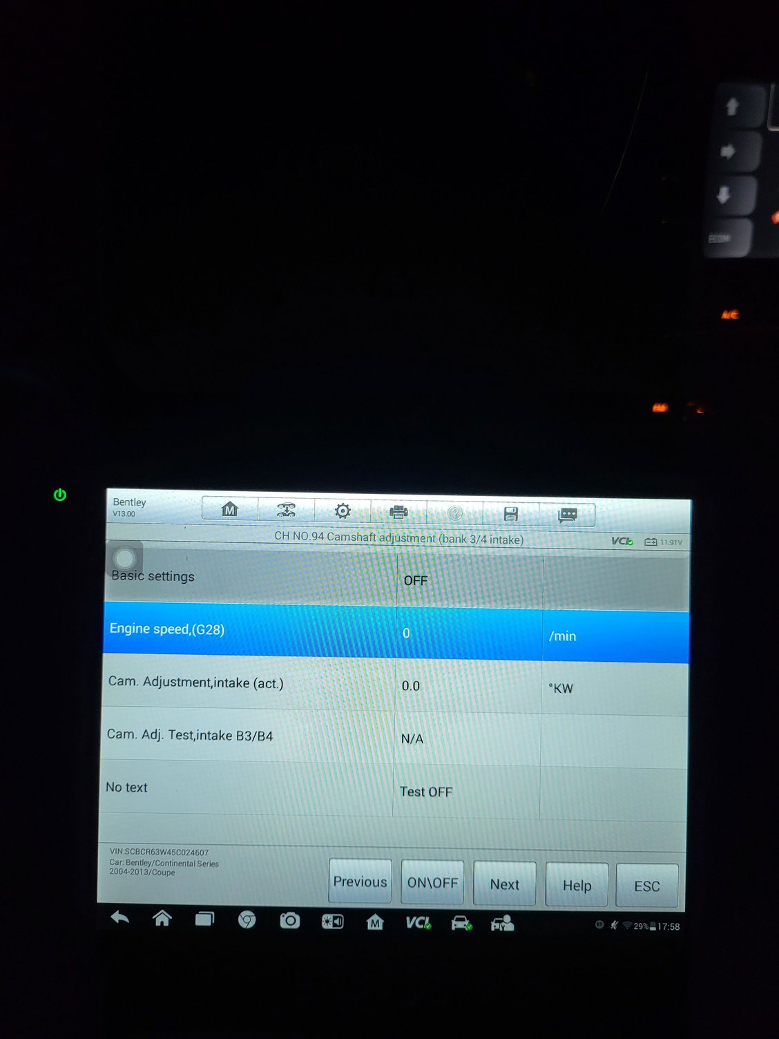

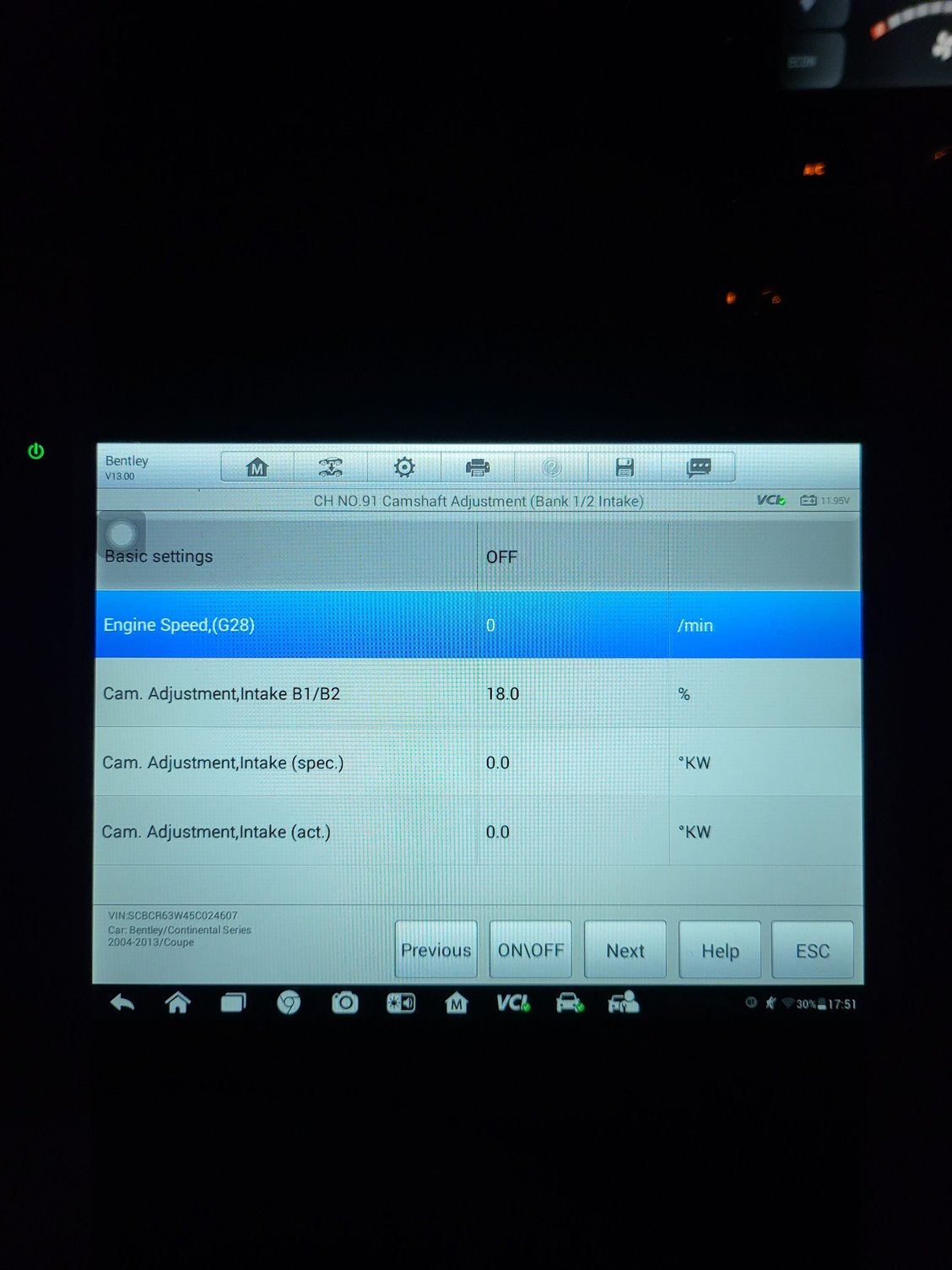

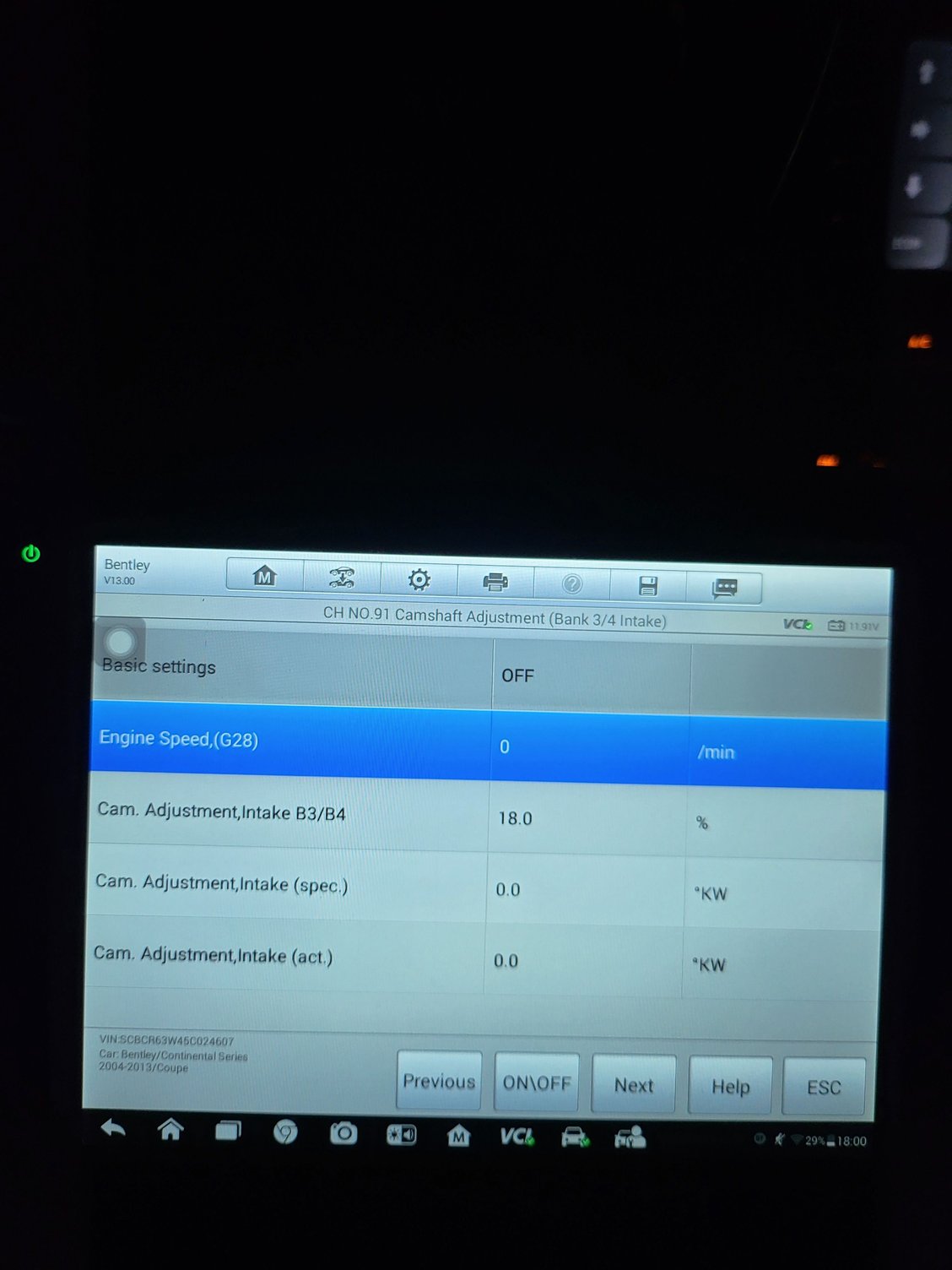

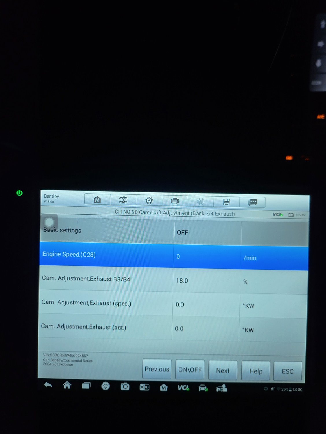

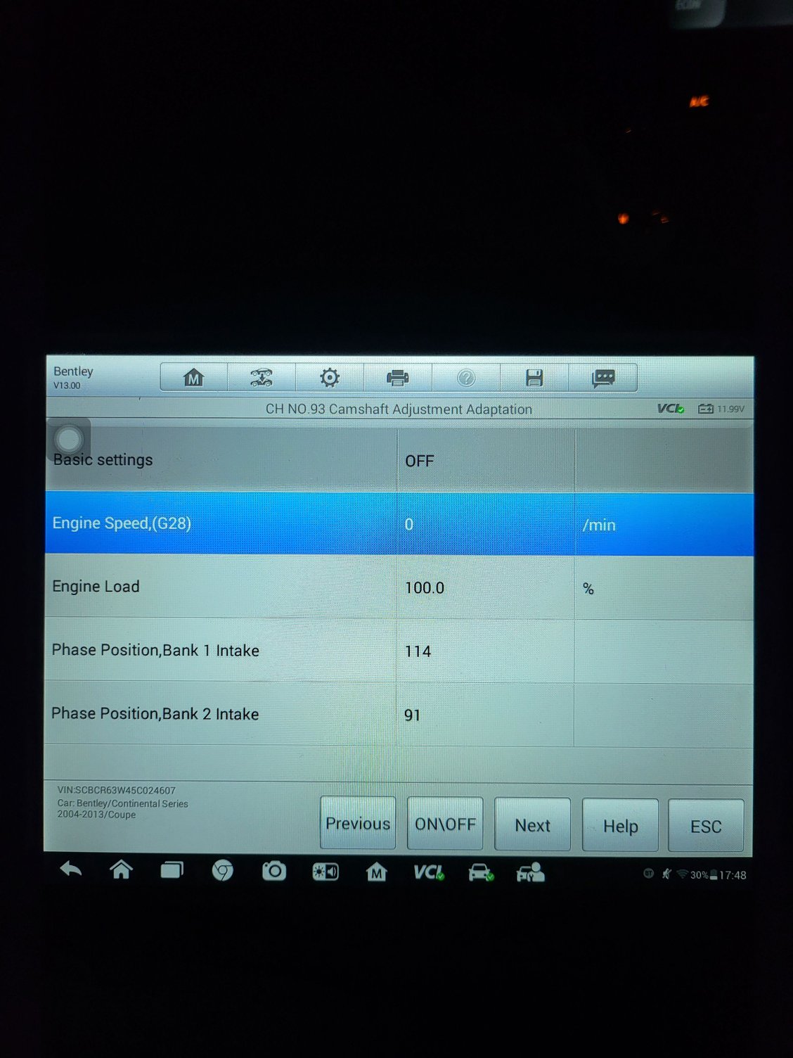

​​​​​This are the values of my Bank 1 timing chain, I don't really know how to interpret these values, any help is appreciated...

Good start repairing the stated vacuum lines. However something else is leaking. Your codes are misfires as a result of a vacuum leak. Keep looking. There are many possibilities for other vacuum leaks. Make sure your air boxes are seated properly to the turbocharger down pipe and that the "o" rings are not damaged. The PCV hard lines to the intake manifold are sometimes brittle. So check these lines and the "o" rings inside the connector on the intake manifold. Anyway you have to keep exploring...sometimes the obvious is hidden on our B's.😏
Forget the timing chain theory unless there is more to that thought.

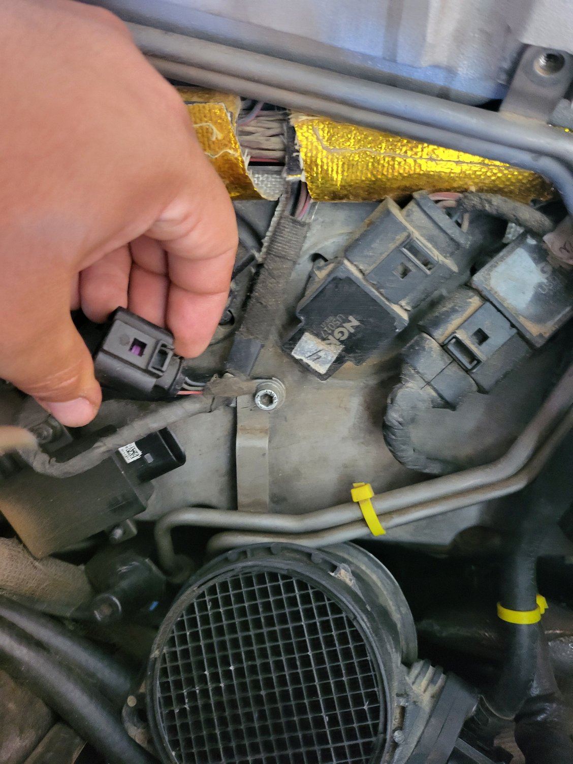

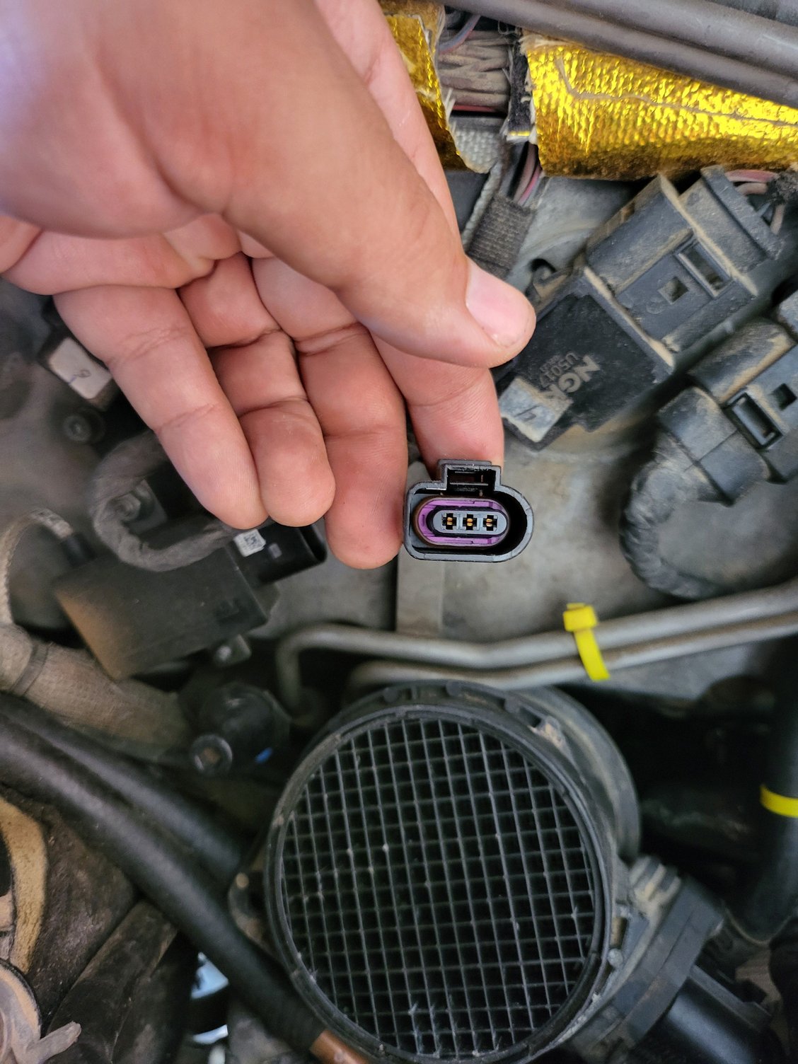

Hello Johnny
*First image is a 07C103474P for Bank 1, I replaced the whole assembly, I ordered this exact part.

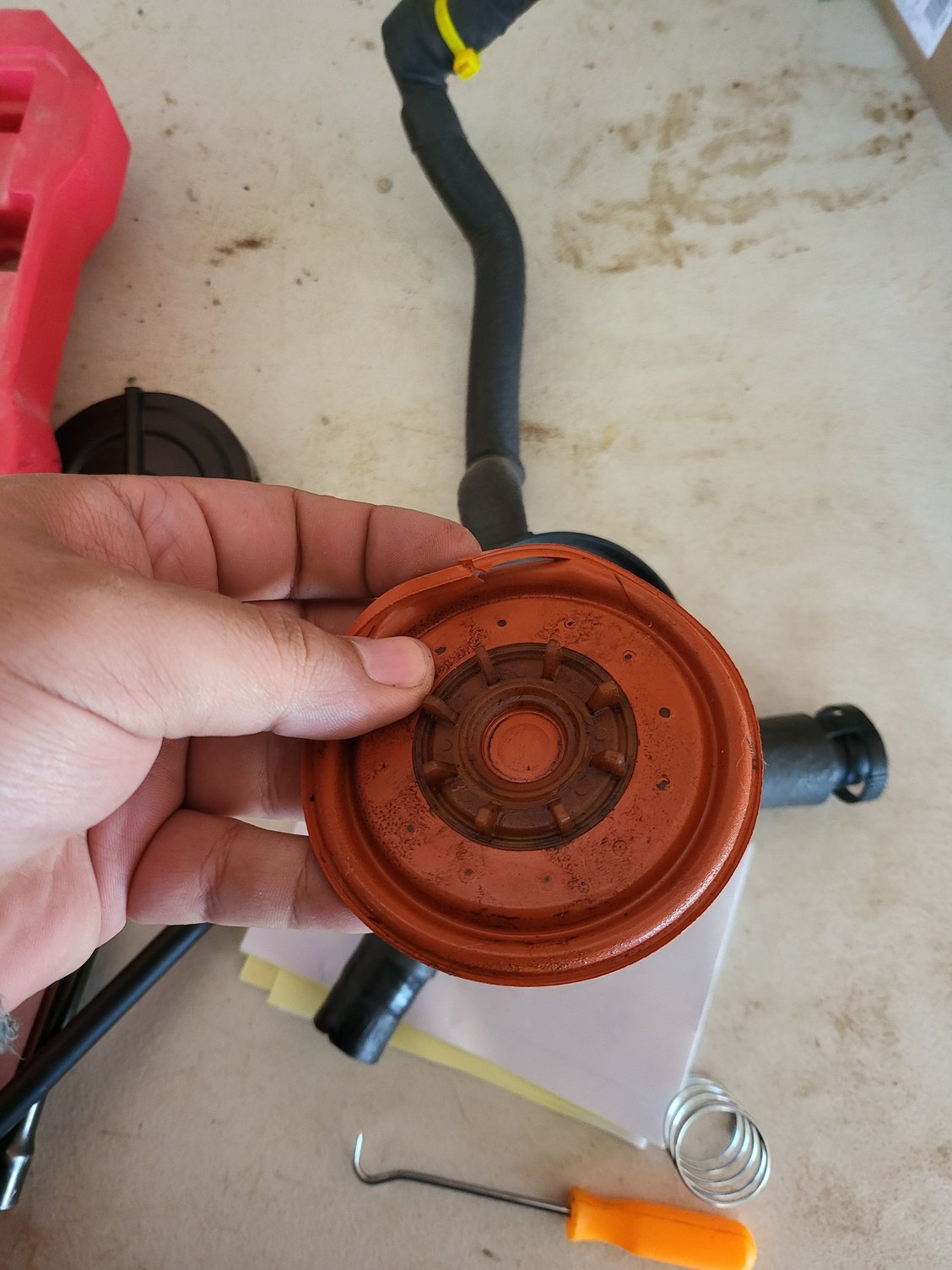

*Second image is the Dorman kit I bought to replace the diaphragm in Bank 2 PCV.
*Third image is the original diaphragm in any of both PCVs, both were in the same condition.

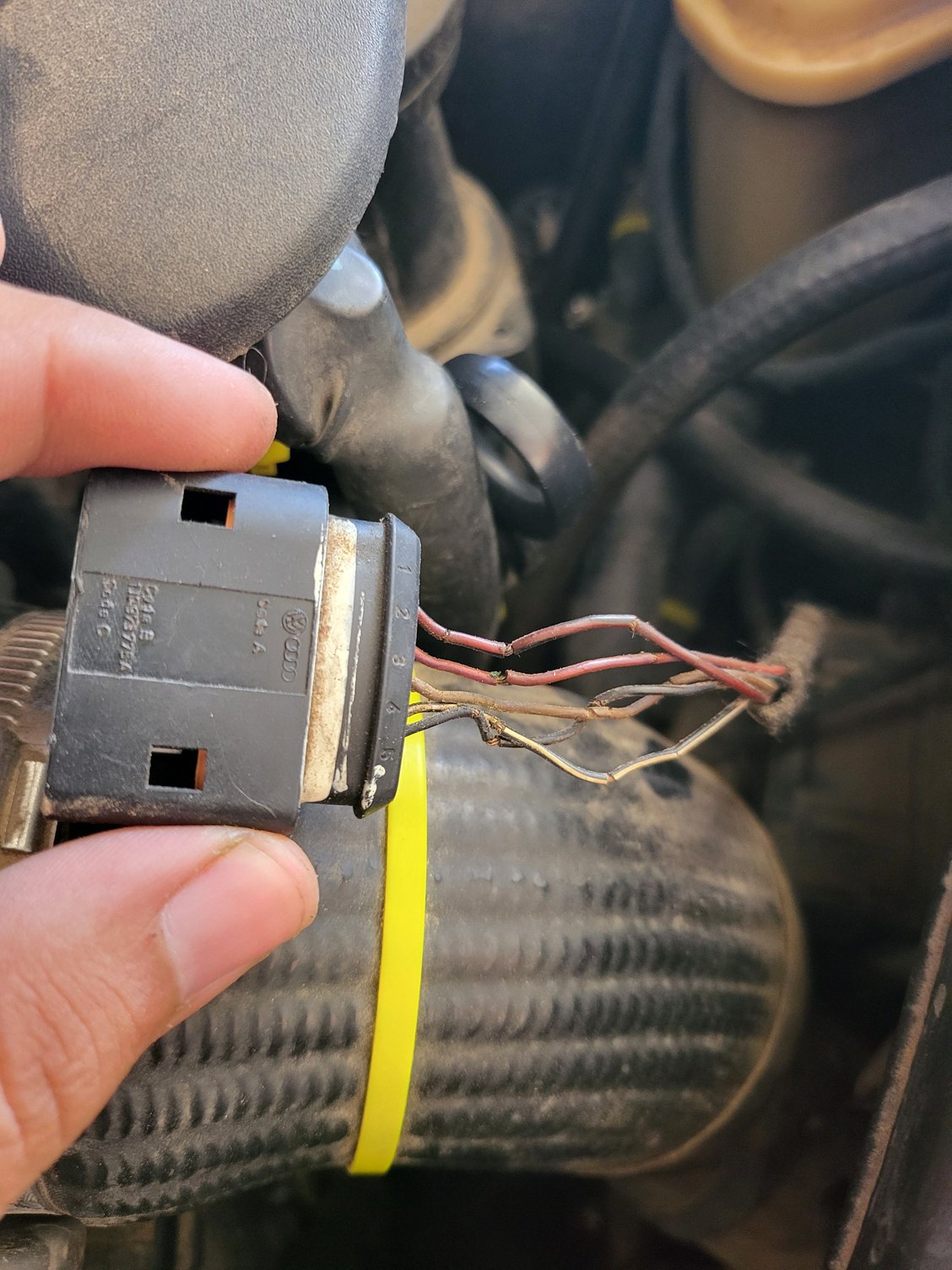

*Fourth image shows the condition of the wiring from MAF harness (This is why I'm thinking to replace the harness).
*Fifth is the codes I just erased (ambient temp. sensor is because the bumper is removed out of vehicle and there attached is that temp sensor).

Old Apr 10, 2024 | 12:00 PM
Johnny Hotspur GT's Avatar
Administrator
Joined: Jul 2014
Posts: 3,946
From: Montgomery NJ
Rep Power: 1002
Johnny Hotspur GT Is a GOD !Johnny Hotspur GT Is a GOD !Johnny Hotspur GT Is a GOD !Johnny Hotspur GT Is a GOD !Johnny Hotspur GT Is a GOD !Johnny Hotspur GT Is a GOD !Johnny Hotspur GT Is a GOD !Johnny Hotspur GT Is a GOD !Johnny Hotspur GT Is a GOD !Johnny Hotspur GT Is a GOD !Johnny Hotspur GT Is a GOD !
@Jurgeenh Borbon ,
Thank you for the pictures.
As to that MAF wiring/plug, yes, definitely 100% in need of replacement, seeing the condition of those wires, I would be concerned about the condition of the O2 sensor wiring, as well as the EGT sensor wiring, possibly even checking the wiring condition and pins at both ECU'S.
BUT, being that you have P0134 for the O2, did you check the fuse for said O2 sensor, I do not know the year of your vehicle, so, prior to 2007 the fuse is the 25 amp F13 fuse in the E-Box in the engine compartment, BUT, this fuse is listed as being for both bank 1 & 2 O2's, whereas from 2007 the fuse for bank 1 O2 is a 15 amp fuse in position F9 in the same E-Box, and F13 becomes a 15 amp fuse for bank 2's O2.

Originally Posted by Johnny Hotspur GT
@Jurgeenh Borbon ,
Got a call... BBS.
Johnny
I did as suggested, fuse #13 is good, I checked wiring and harness of O2 sensor and EGTS, all seems fine, also I cleaned them (again) with electrical connector cleaner in can.
