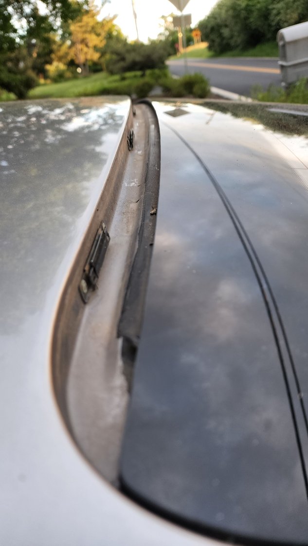

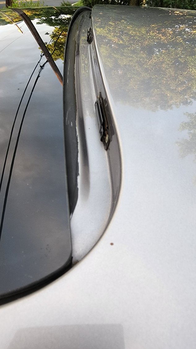

If you are still with me here 😁, let's talk about the high mount brake light.

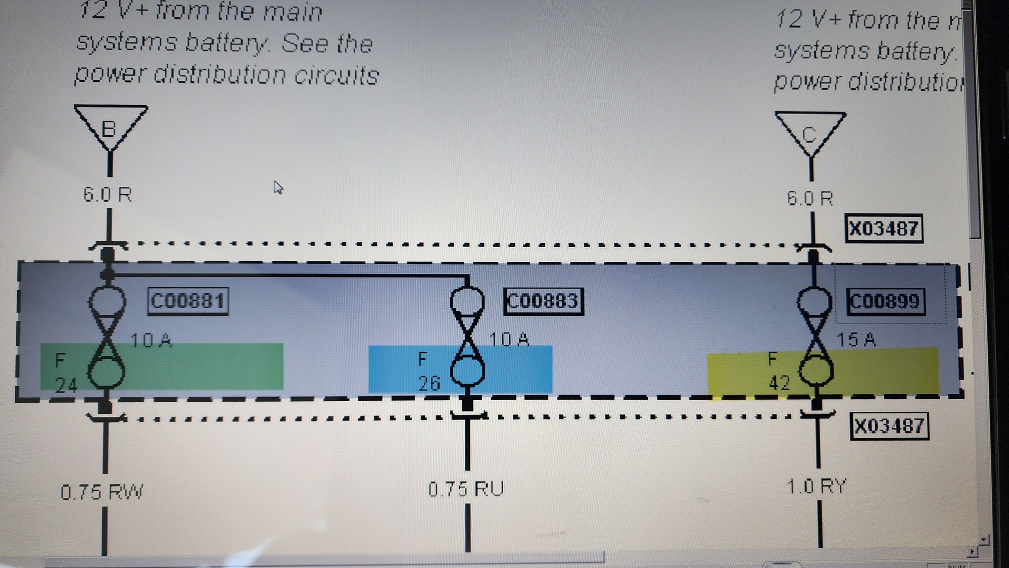

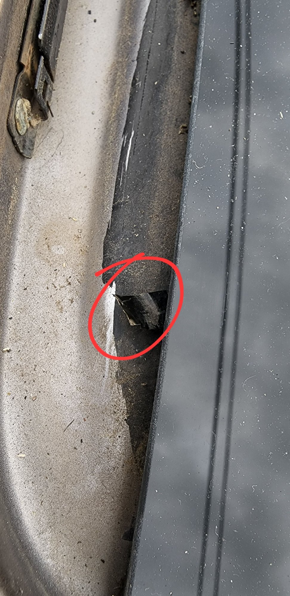

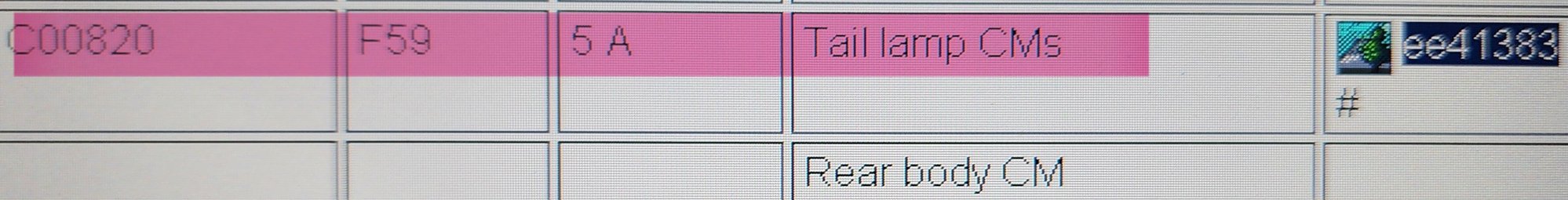

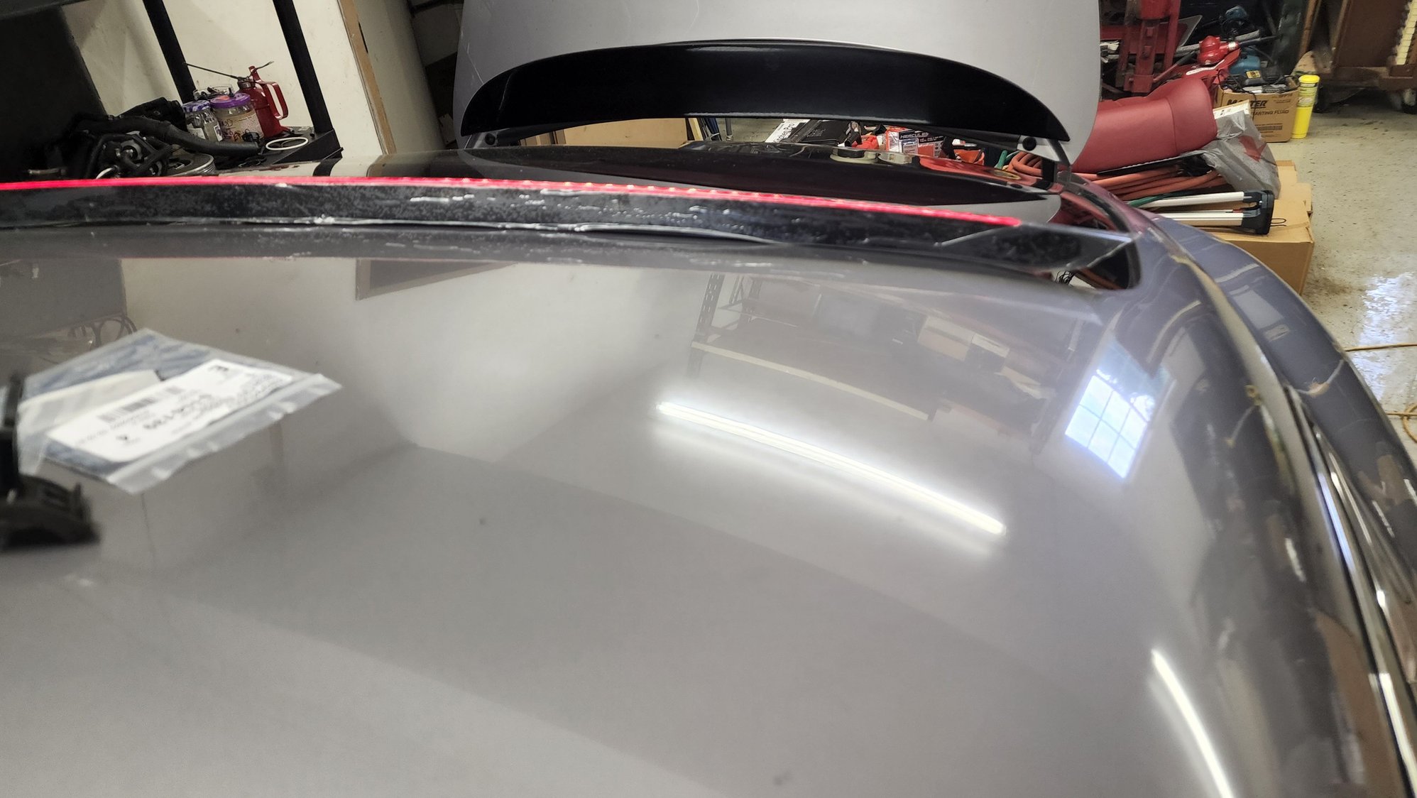

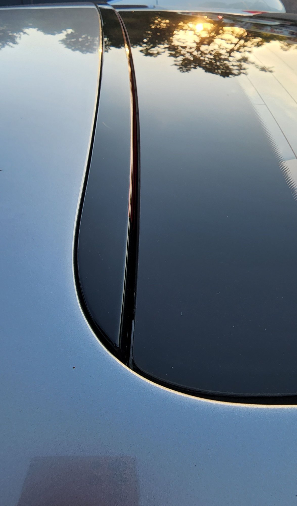

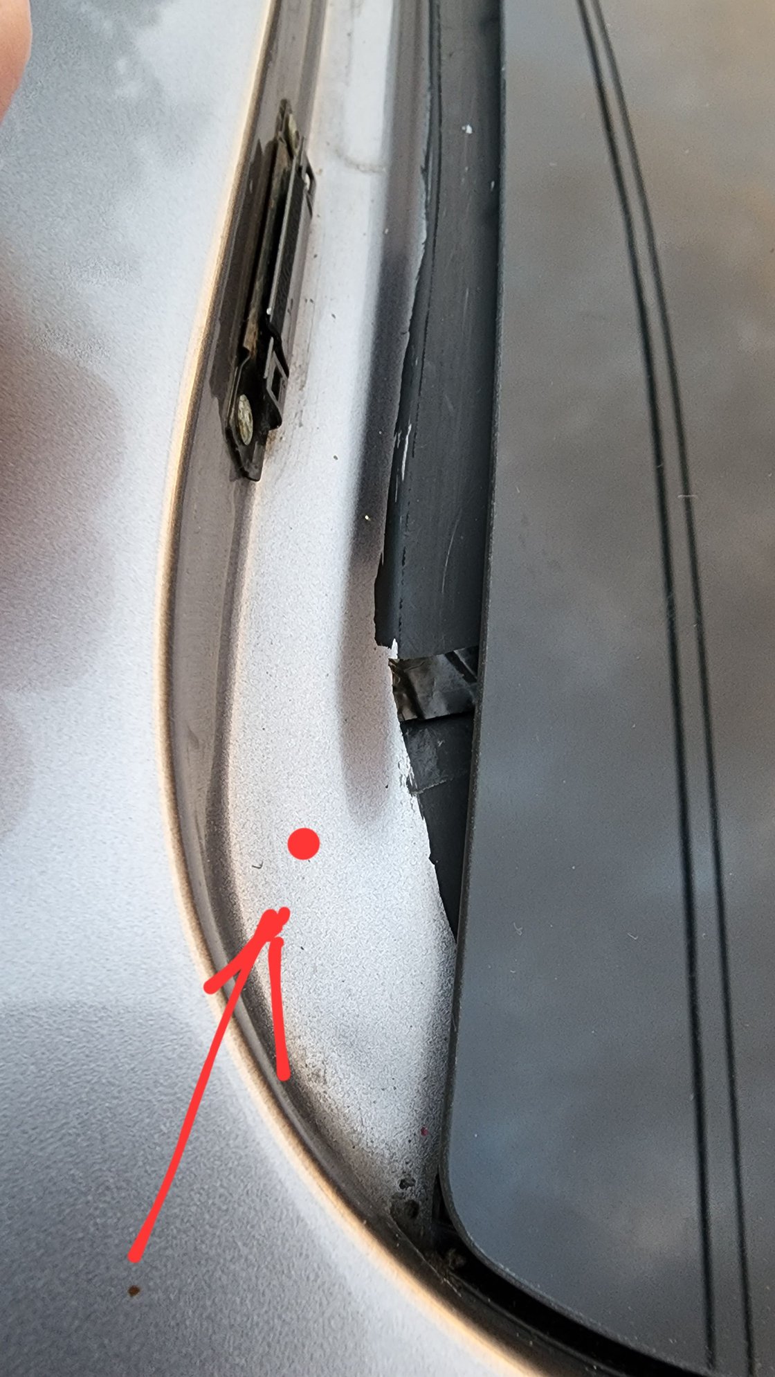

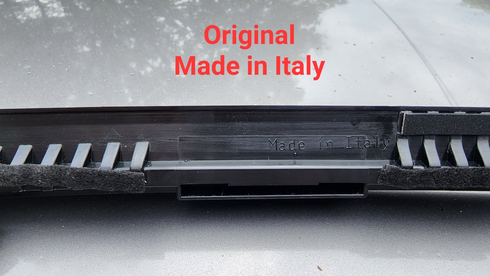

As to a seperate fuse just for said light, no, there in no dedicated fuse for it, although, there are 4 fuses that supply power to the rear body control module located in the boot, one fuse (F59) is located in the driver's facia fuse box, the other three are located in the boot on the left side facing the boot, they are fuses F24, F26, and F42, now, if everything thing else is working, I don't believe that you have a fuse problem, more likely like you stated, a resistor installed to kill the warning on the dash, said resistor would be installed right at the plug for the CHMSL, said plug in as shown in my rebuild thread and pictured below, accessible by dropping the headliner a bit, and a side trim.

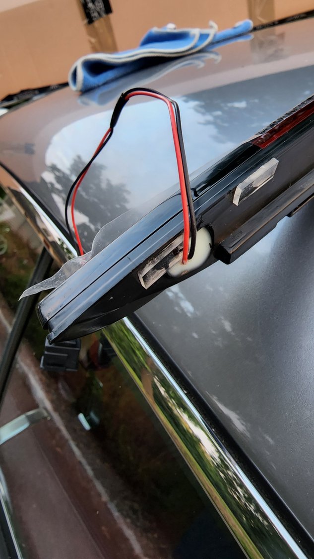

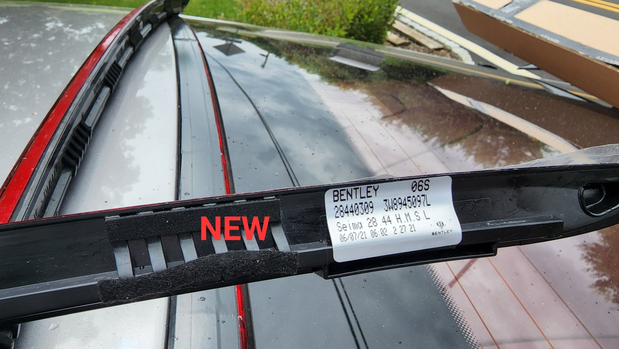

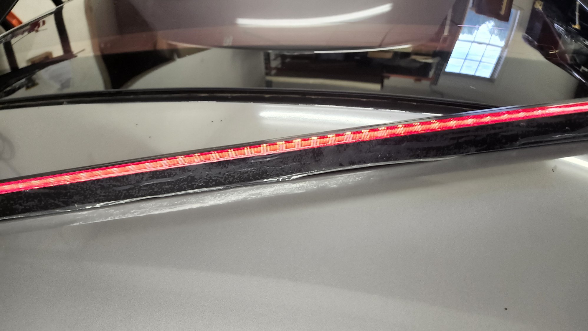

As to you installing a new or used light, the new one from the dealership cost me $619.71 plus a $21.63 surcharge for using my debit card, yes, seriously, a surcharge... If you want new, I will price it for you tomorrow at my cost, and see what drop shipping to you would be, so either post or pm your zip code if you want.

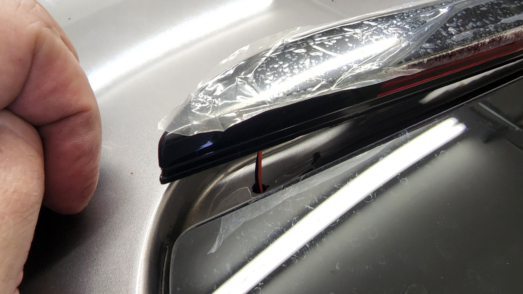

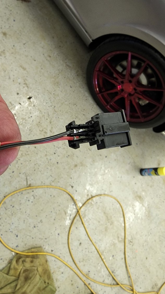

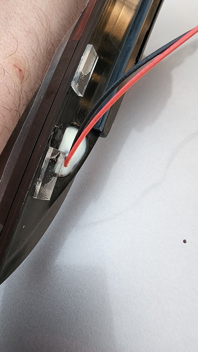

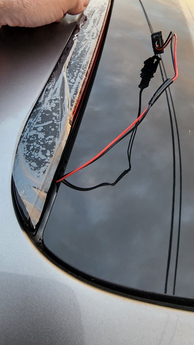

The next issue with the light is, your light most likely has the flat ribbon cable as factory, whereas the new unit from the Bentley dealership has the standard 2 piece cable with red and black as shown, but, it also has connection plug/socket that in no way will go through the butyl caulk between the glass and the body, so I decided to drill a small hole as pictured, remove the wires/pins from the plug, fish wires through the hole, then reassemble the plug and wires on the inside of the vehicle, I know others have worked the wires between the glass and body, but I wasn't taking that chance, I had already cracked my spare glass from the parts vehicle..
If you have some pictures of the light, please post them, does it have any cracks ?
Johnny
