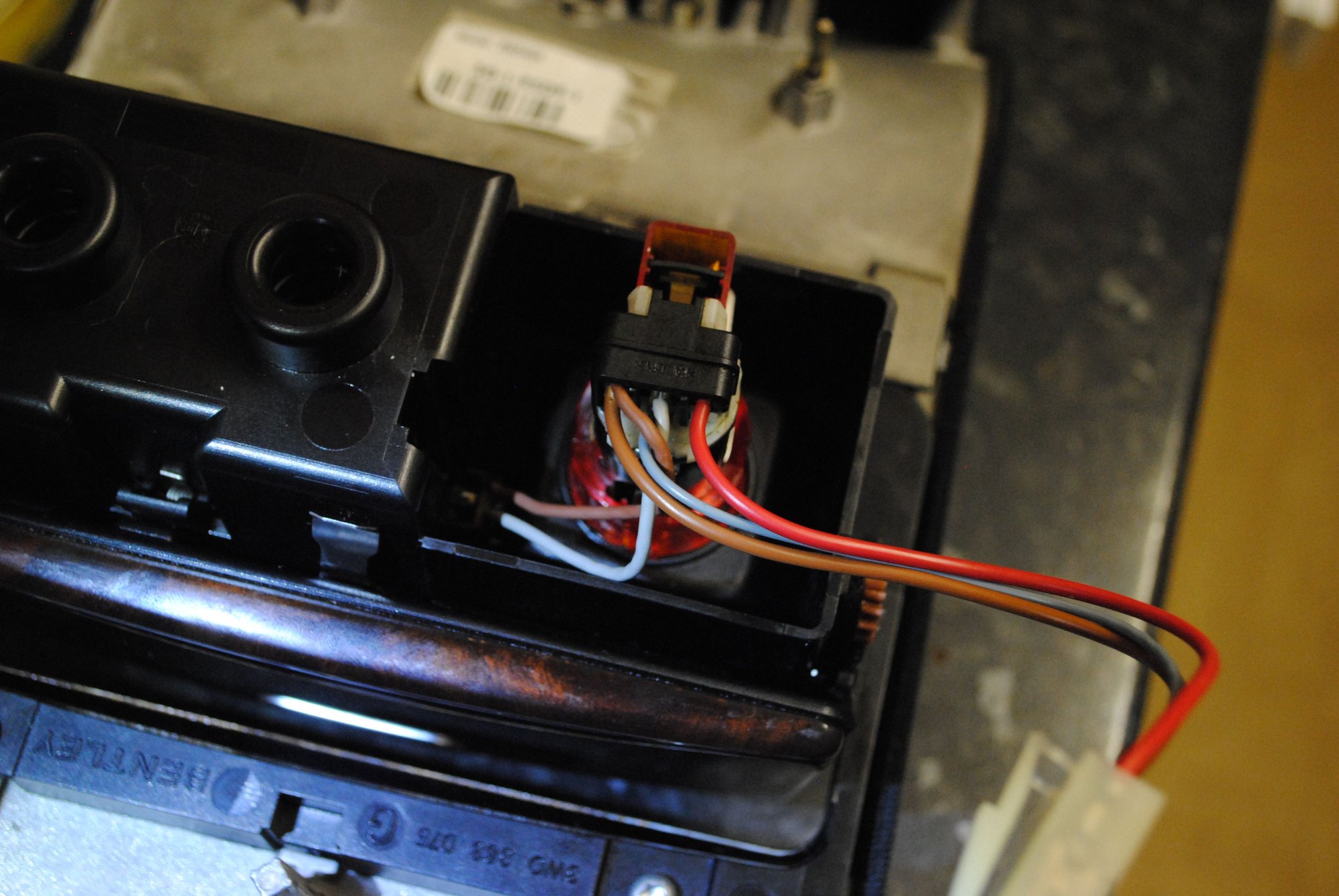

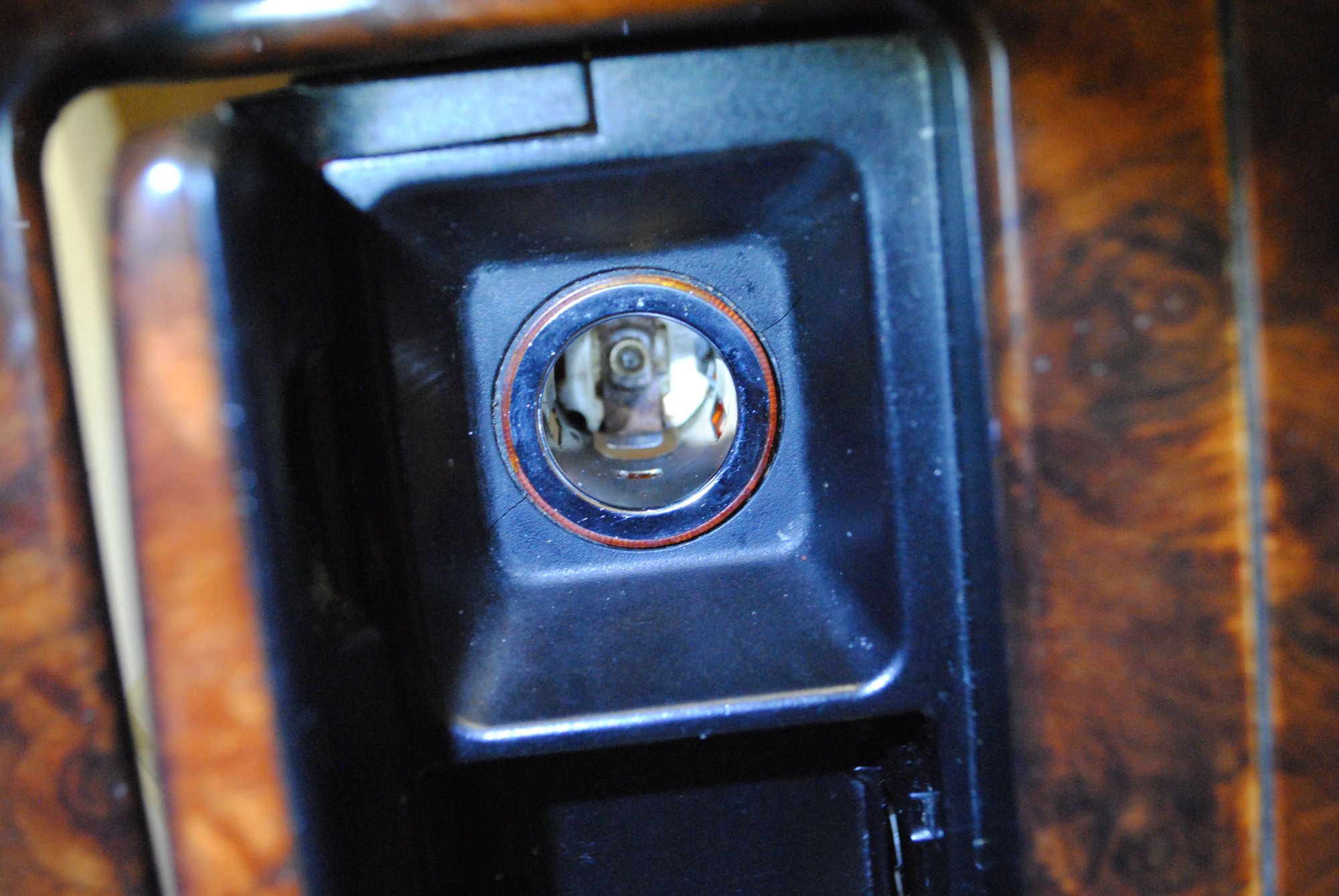

Anyone ever managed to remove the lighter socket on the Mk1 Bentley 2003 -2011
Mines a 2005
Or is it a main agent job again .....Just ike the gear shifter dust cover that they wont sell you FFS

Yes Johnny i did read all of that post bro before i posted ....everything except how to remove it ?
My post Wanted to find out how anyone would go about removing it ..
I have switched out loads of lighters power points etc...
THIS ONE HAS ME BEAT
HELP as ive looked everywhere online
scrinja

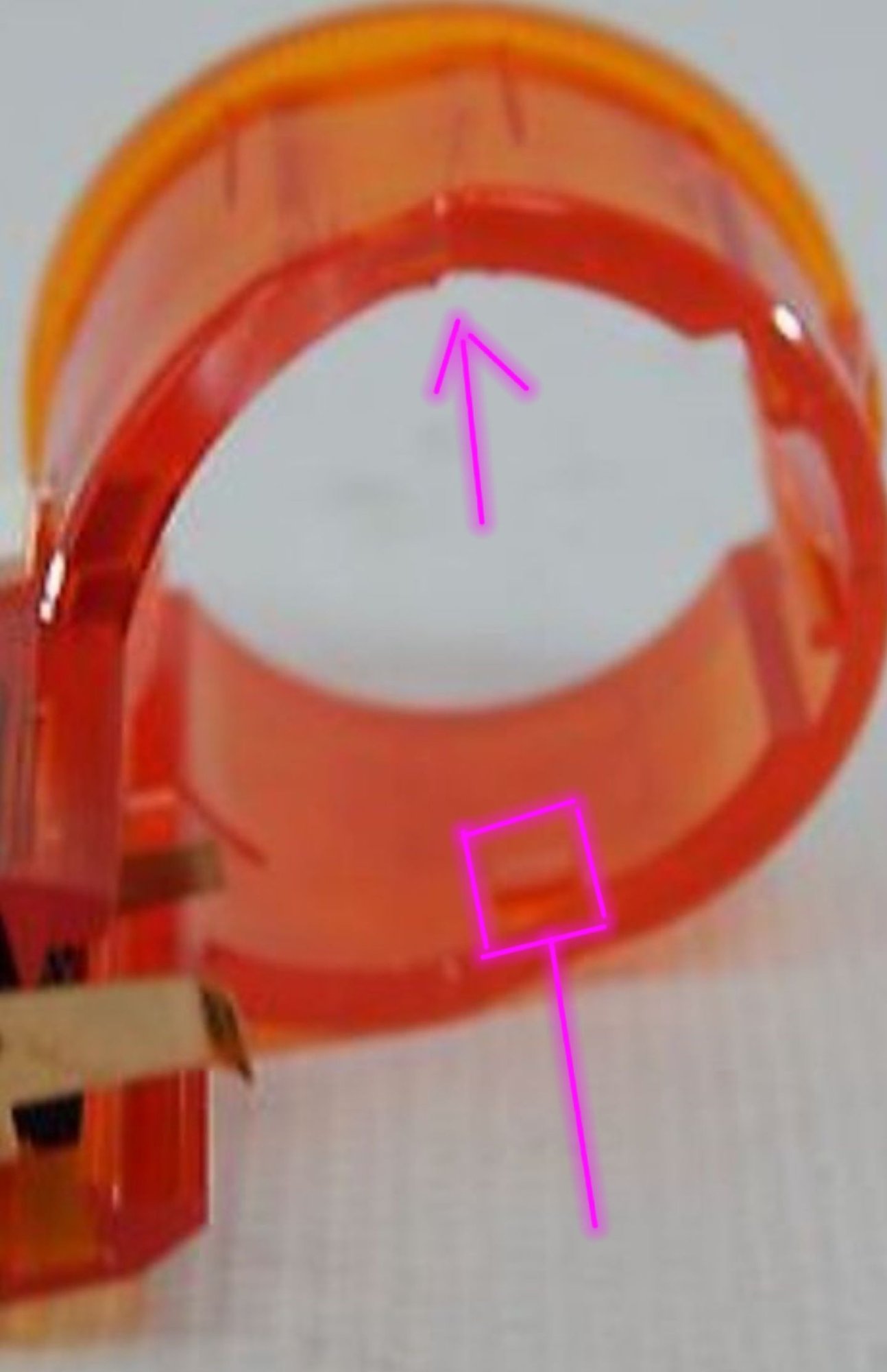

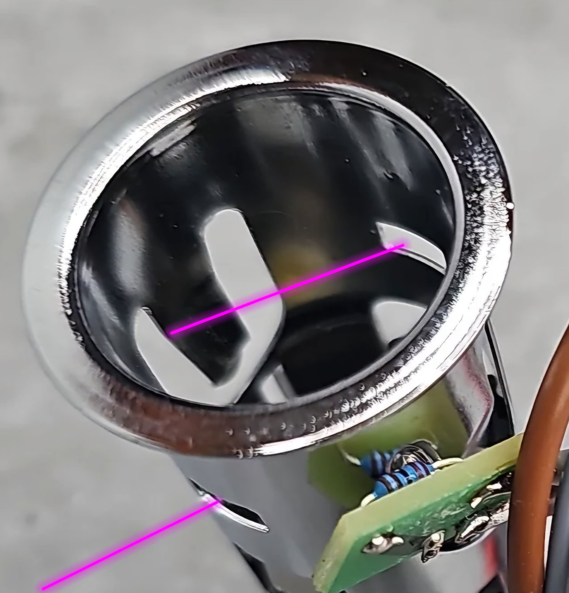

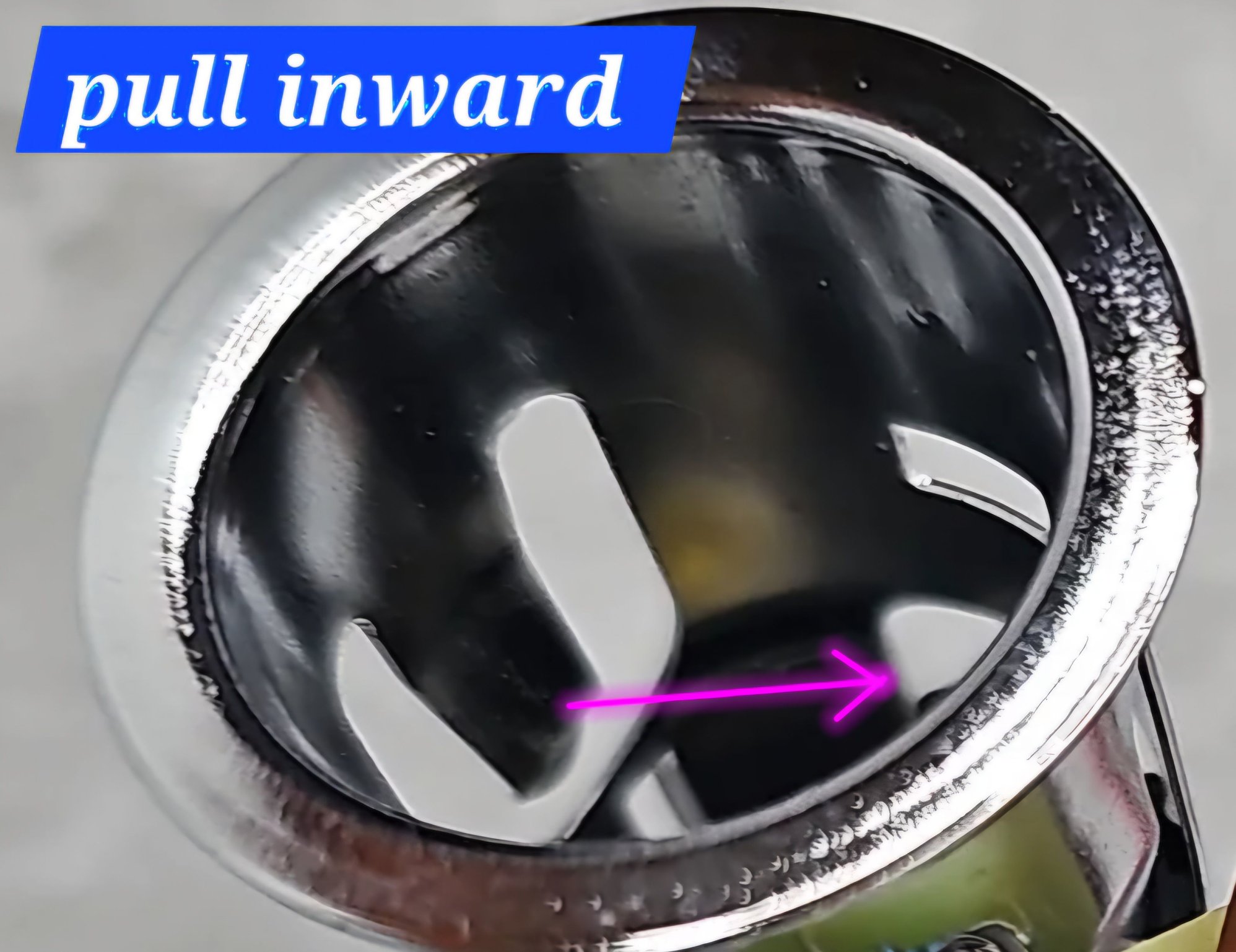

I do not have the unit in front of me to double check the removal procedure, but, just from looking at some pictures, I think this may be how, you would pull the metal tang/s inside the lighter element socket inwards, and lift it out at the same time, as there are two tangs, it's the one on the deepest side of the orange/red lighting housing, after the socket is pulled out, you will see on the underside the two tabs to push in on the orange piece, that will then let that piece come out through the top also.

I think it may be the two nubs holding the socket in place, I would gently push them in as lifting the socket out, then the two tabs on the orange piece are as described previously.

Yes Johnny i was thinking the same as alot of VW are removed that way with the orange tangs ....I have put all the consoles back in now so it will have to go on the back burner for now
The problem is the recess in the location of the lighter.... trying to press in the two tangs it is very restricted to get access to get in there and i was worried about damageing mine
I did look all over to try and find out how to remove it
I dont have access to the Bentley repair manual i would have though it might have been in there ...
If they sell them you can fit them easily when there out ! ,,,,Even If broken already you would still struggle to remove them i feel Johnny

if you need to remove one it is definately the Orange tabs that locate it in the holder As in the pics .. Bro
