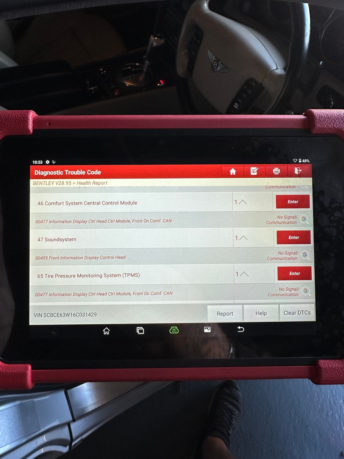

this is my first post as I’m completely stumped. I have a Bentley GT 2006. It has the aftermarket head unit and ac controls.
the car went to the paint shop where I believe the battery went flat and they’ve got it started some way. This is where my problems came from. Now the radio/ac panel don’t work which in turn I can’t adjust the suspension. I can also hear my interior heaters working where I last had them set too 22degrees but can’t see or adjust it. Start button works plus heated seats and hazard switch.
I’ve checked all the fuses and nothing. Is there a control module that runs that system.
can anyone please help.
thanks Andy

Hello @Dickson440 ,
Welcome to 6speedonline !
As to your issue, please post a picture of the aftermarket unit you have installed.
Have you pulled the unit to check for a self contained fuse, just as the original head unit has a 10 amp fuse on board.
Johnny

Hi Johnny.
No I haven’t pulled the head unit I’ll try that in the next few days. I’ll post a picture of the system tomorrow. I was just thinking more of a module due to the fault codes of no communication with entertainment system.
cheers Andy
