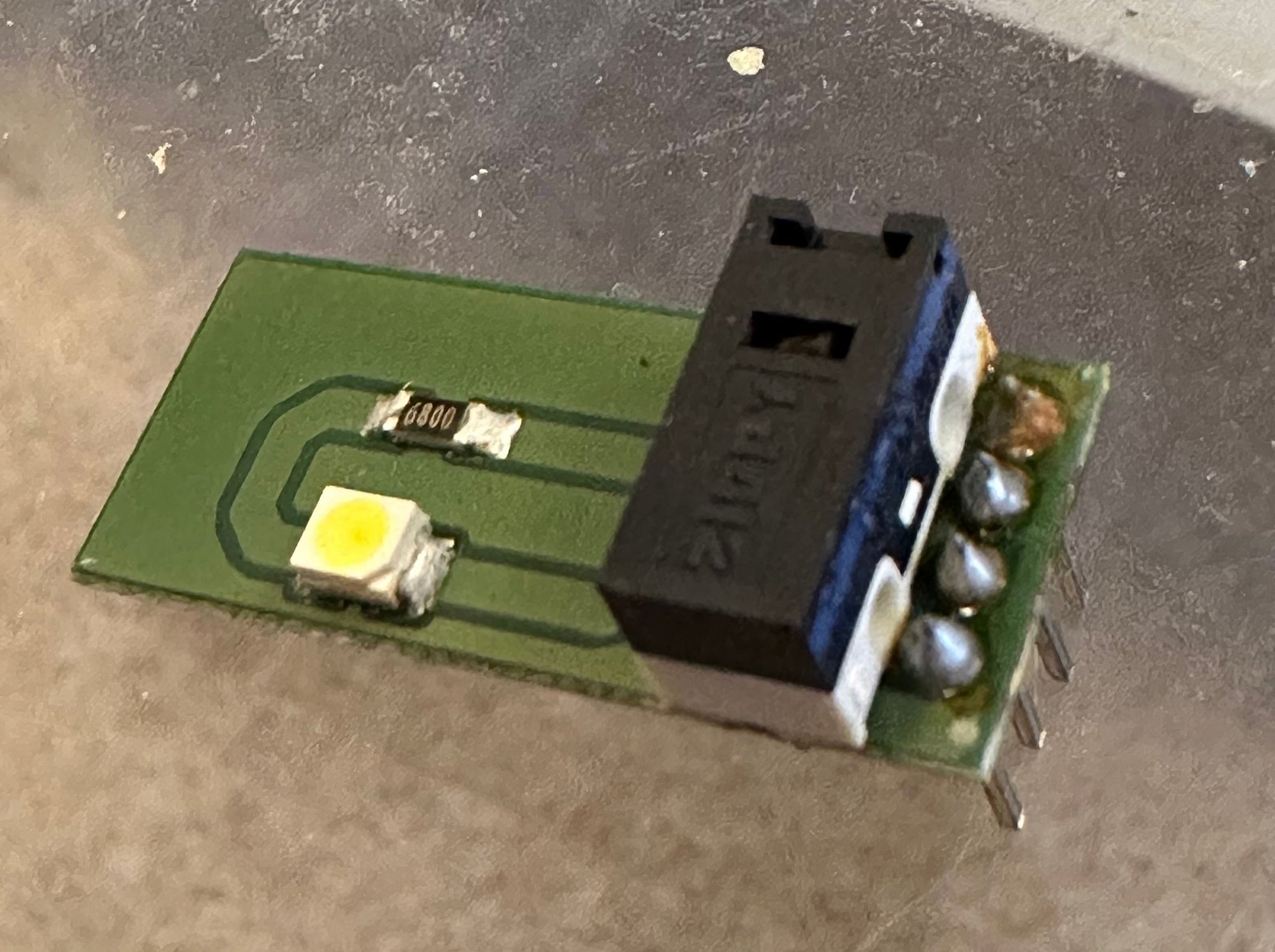

I took the Boot Close switch out of the lid and tested it. It has a 4 pin connector, pins 2 and 3 are for the switch contact, 1 and 4 are for illumination. There was no continuity between pins 2 and 3 when pressed. A brand new genuine replaced from FS is currently UKŁ140 - not paying that for a switch. I opened it up to investigate further…
As you can see, the little plunger near the top of the microswitch appears to be missing or pushed right in. That’ll be the issue then! A quick search reveals this…

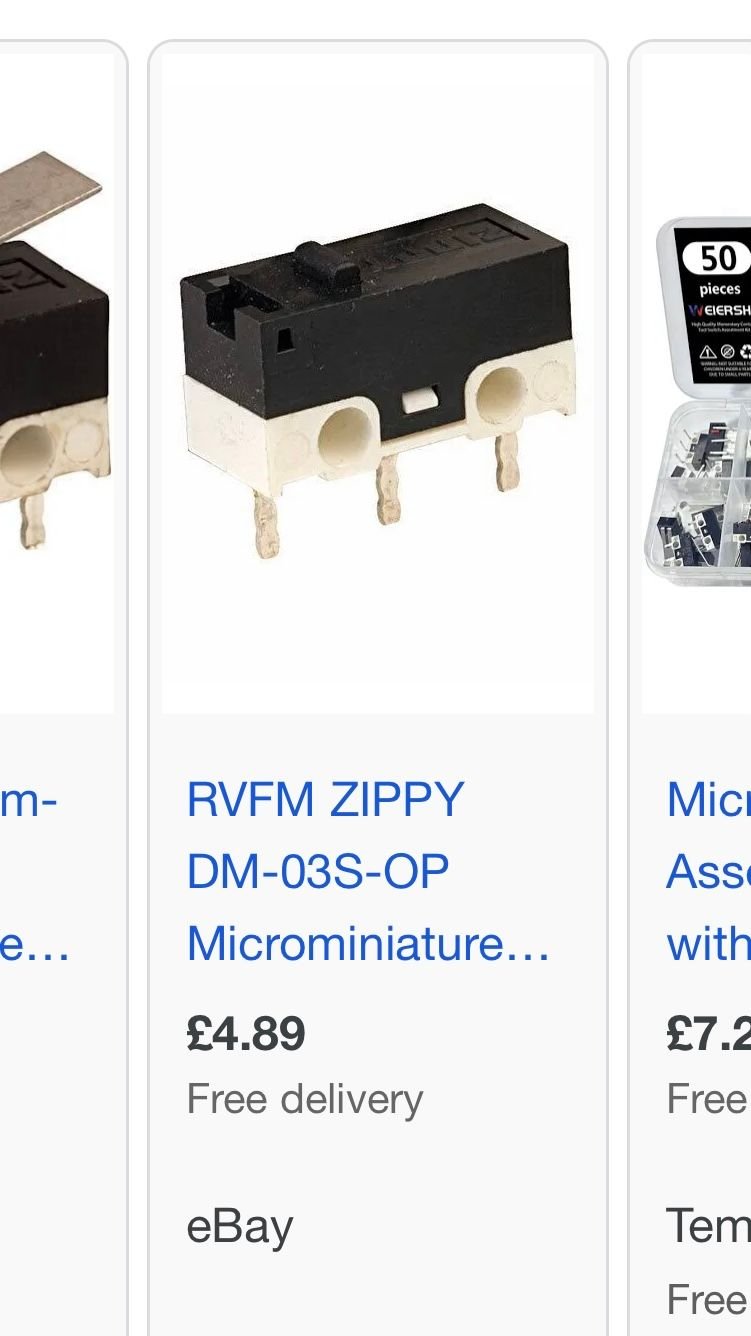

An exact replacement microswitch, readily available, for the princely sum of UKŁ5. Four solder joints and I imagine the problem will be solved. Might be worth bearing in mind when you’re presented with a 3 figure repair bill.

Got my switch today, soldered it in and it works perfectly. Be sure to get the one without a lever. Not sure if this eBay link will work but if not, a google search on the details in the photo I posted above should yield results.
