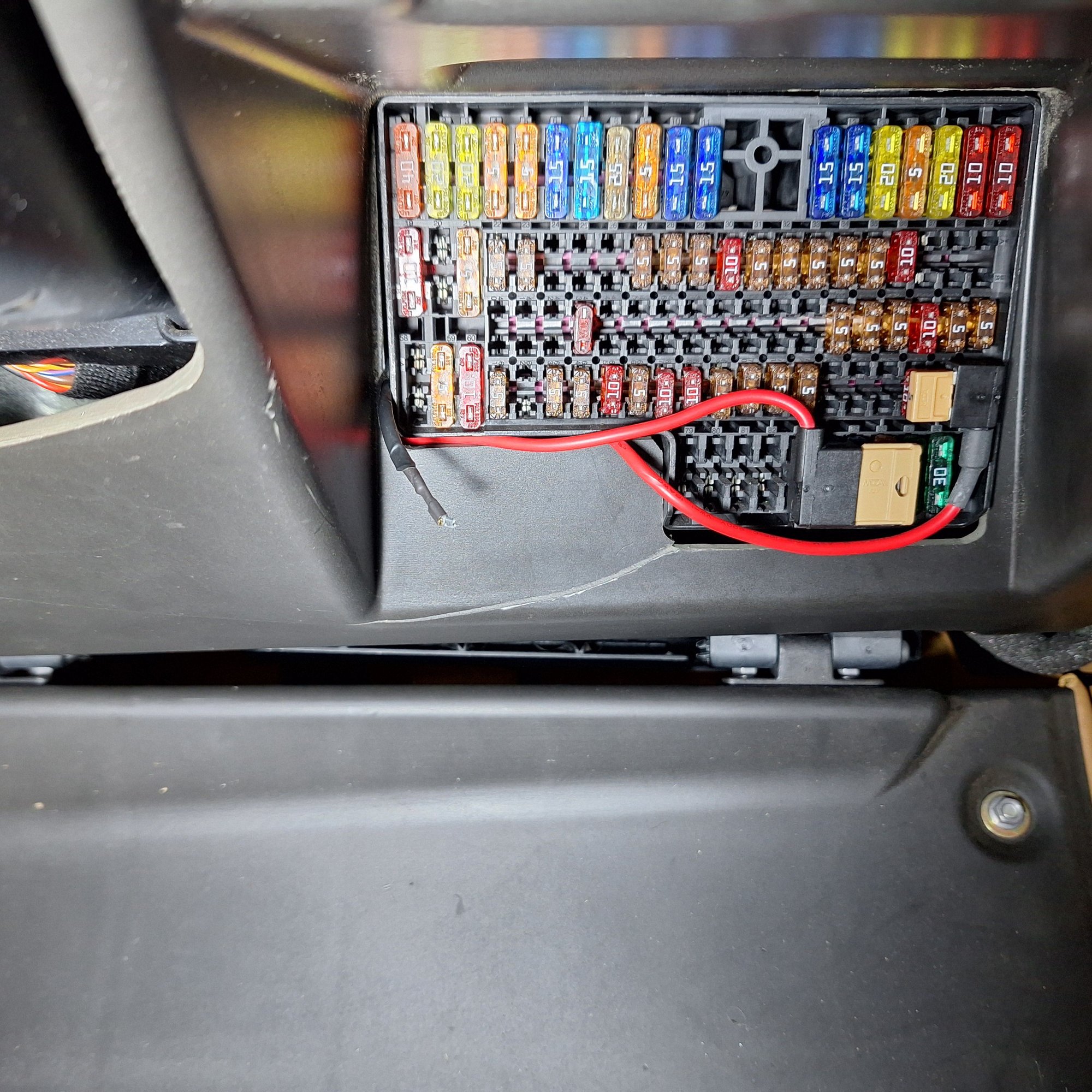

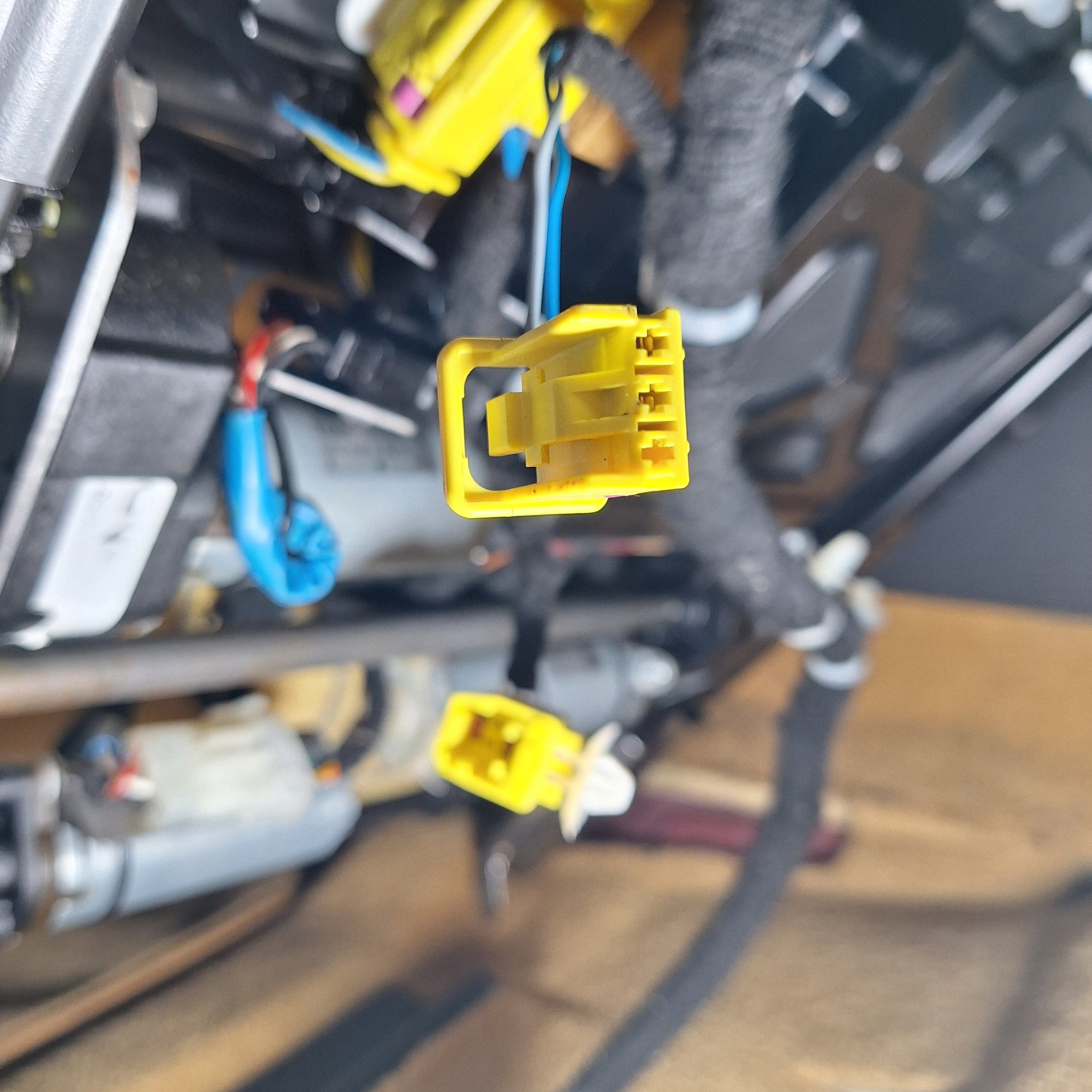

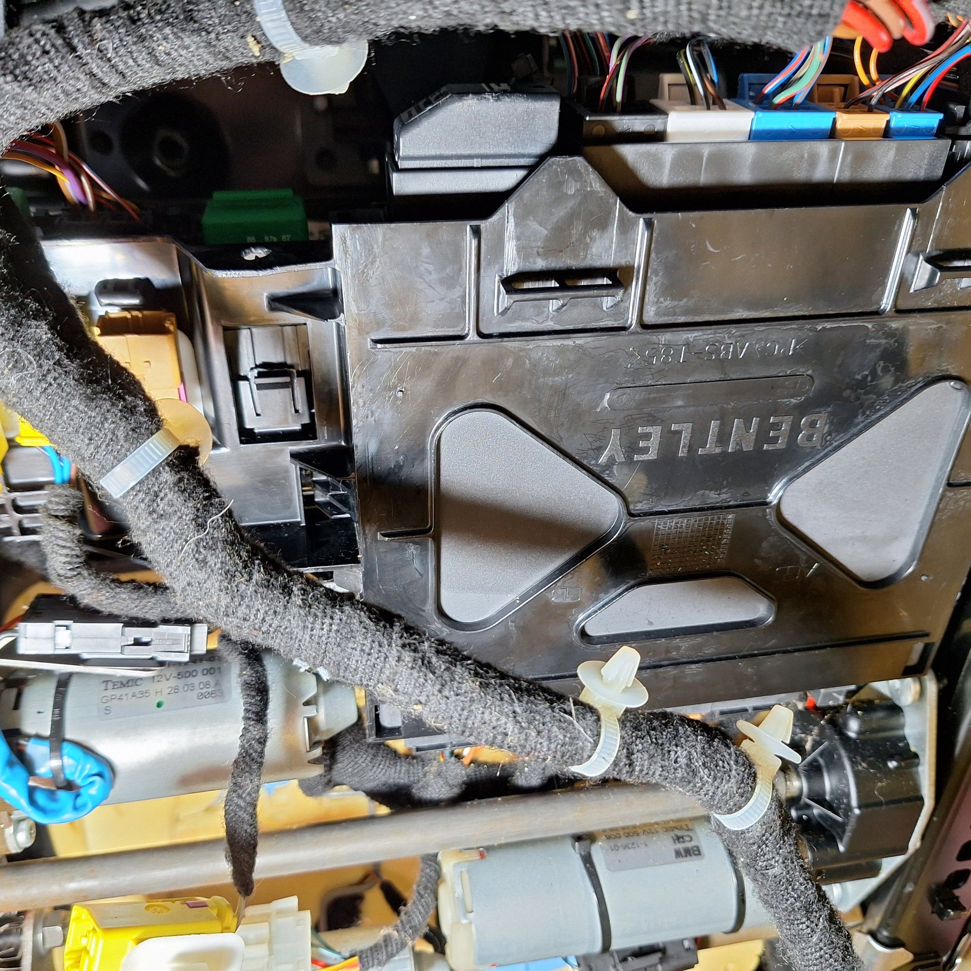

Hi Johnny, I undid the seat bolts & tilted it back for better pics as you suggested. You can see the loose Plug & Socket that do not 'marry'. The Socket has a fixing stud, as does the cable (2 in fact) but can't see where they go?
Checking the fuses, I.found that the R/H Fuel Pump has no fuse, which I am bery confused about as the car goes like a dream!?

Please retake some pictures of the seat wiring area, your pictures are too close, and do not show everything, take quite a few if you would please, also, you never posted the picture of the sensor you say was in the glovebox.
As to your fuel pump fuse comment, you post a picture of the front facia fuse panel, whereas the fuel pump fuses are in the boot fuse panel, numbers 34 and 35, see the attached manual for all fuse locations.

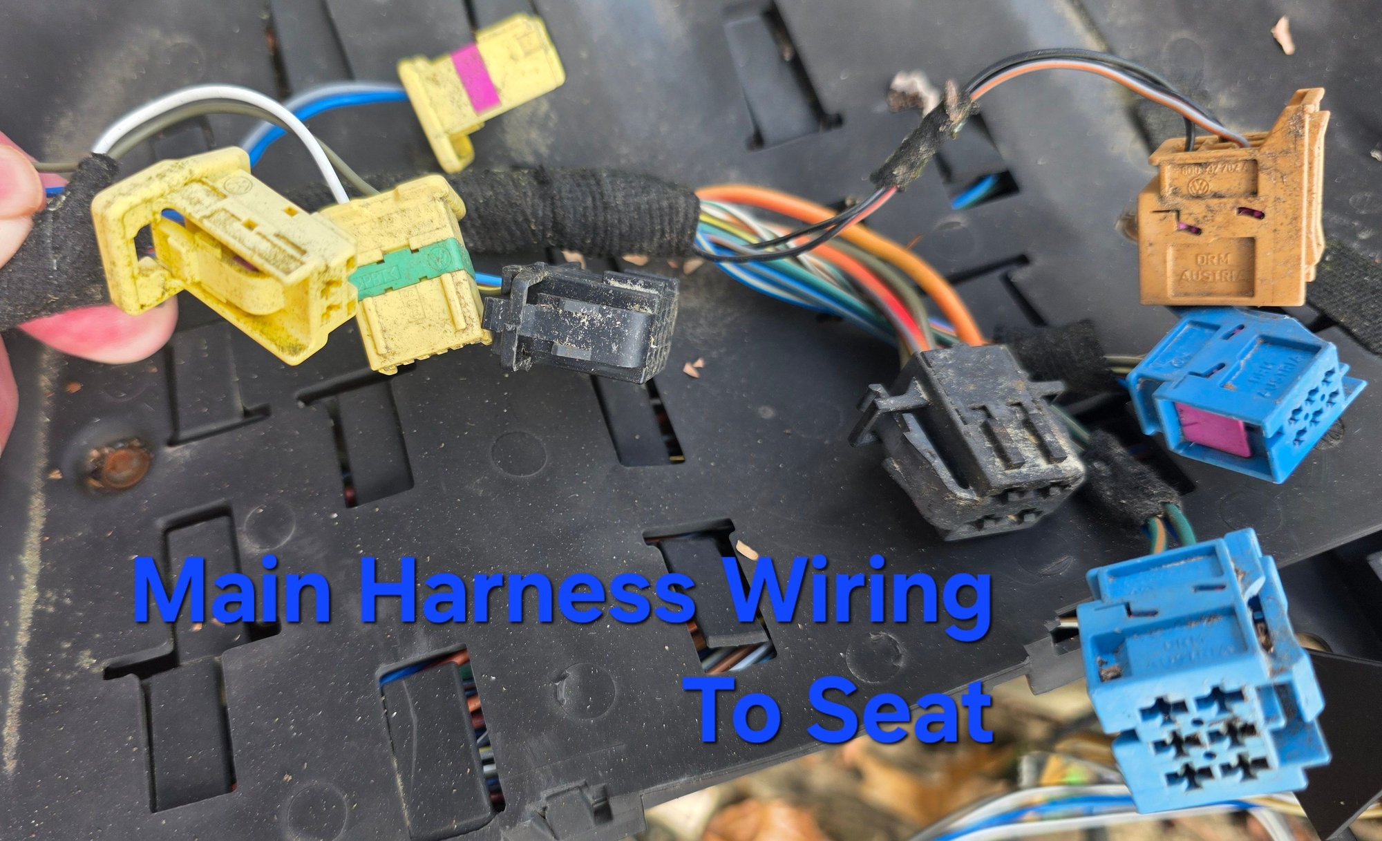

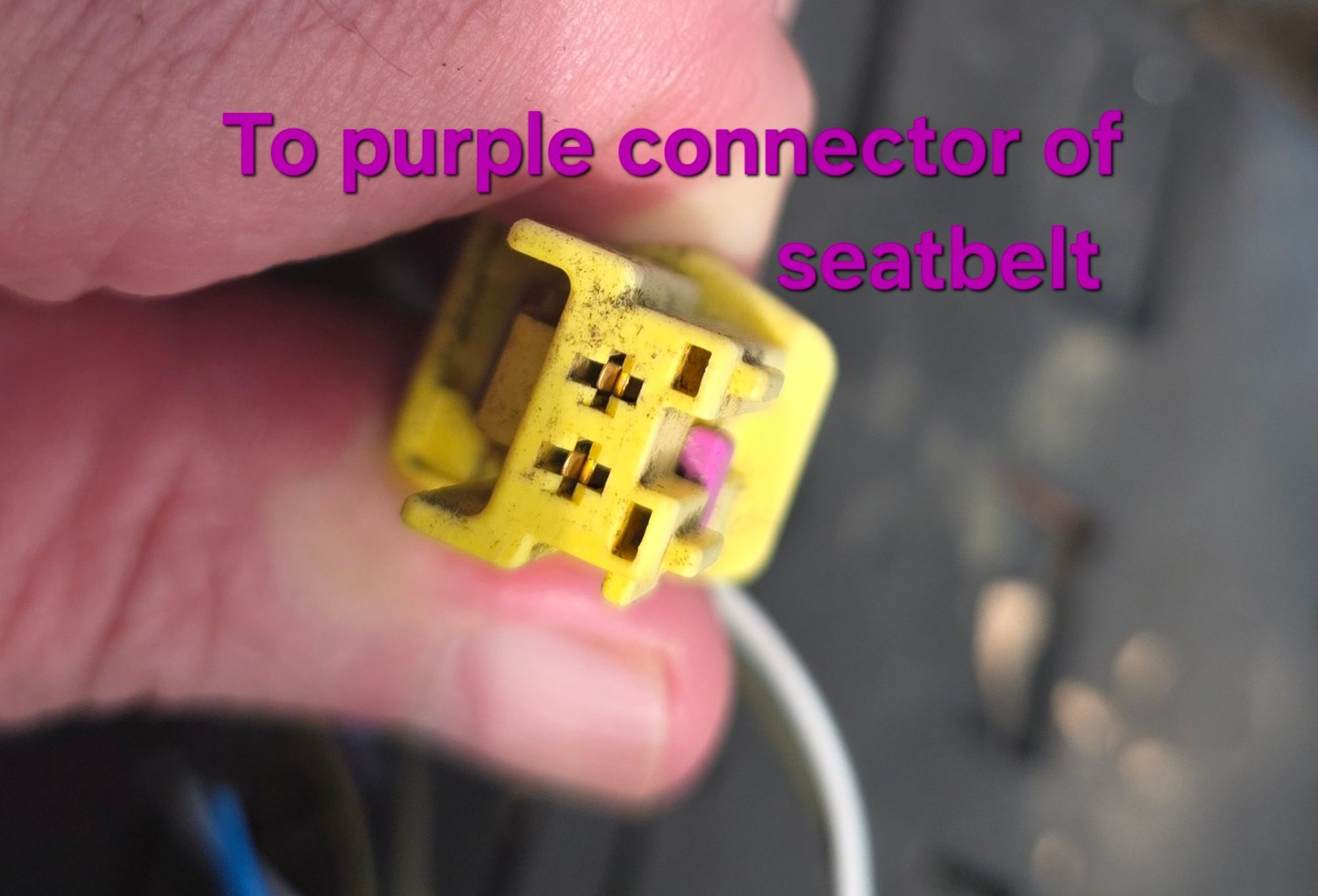

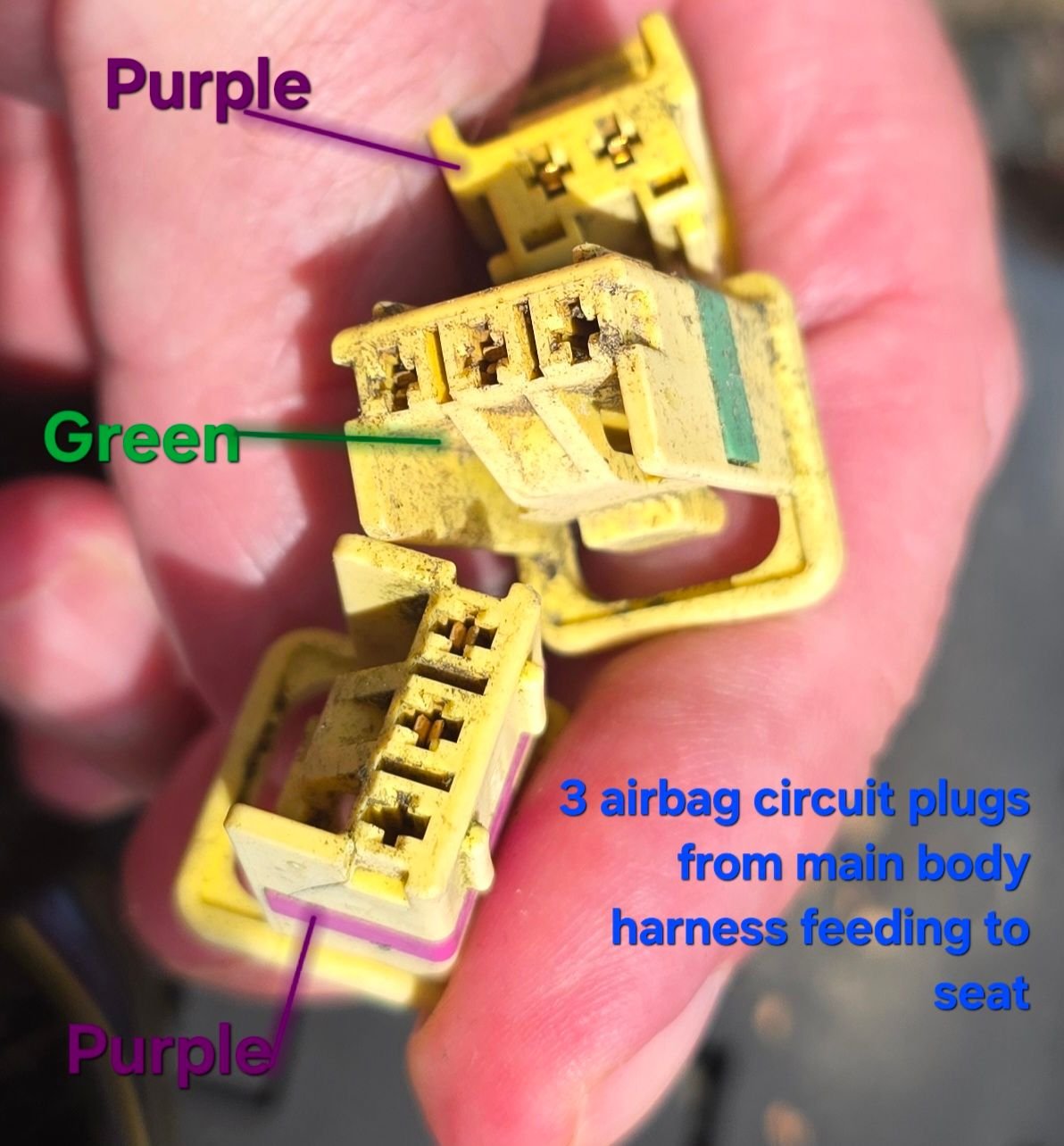

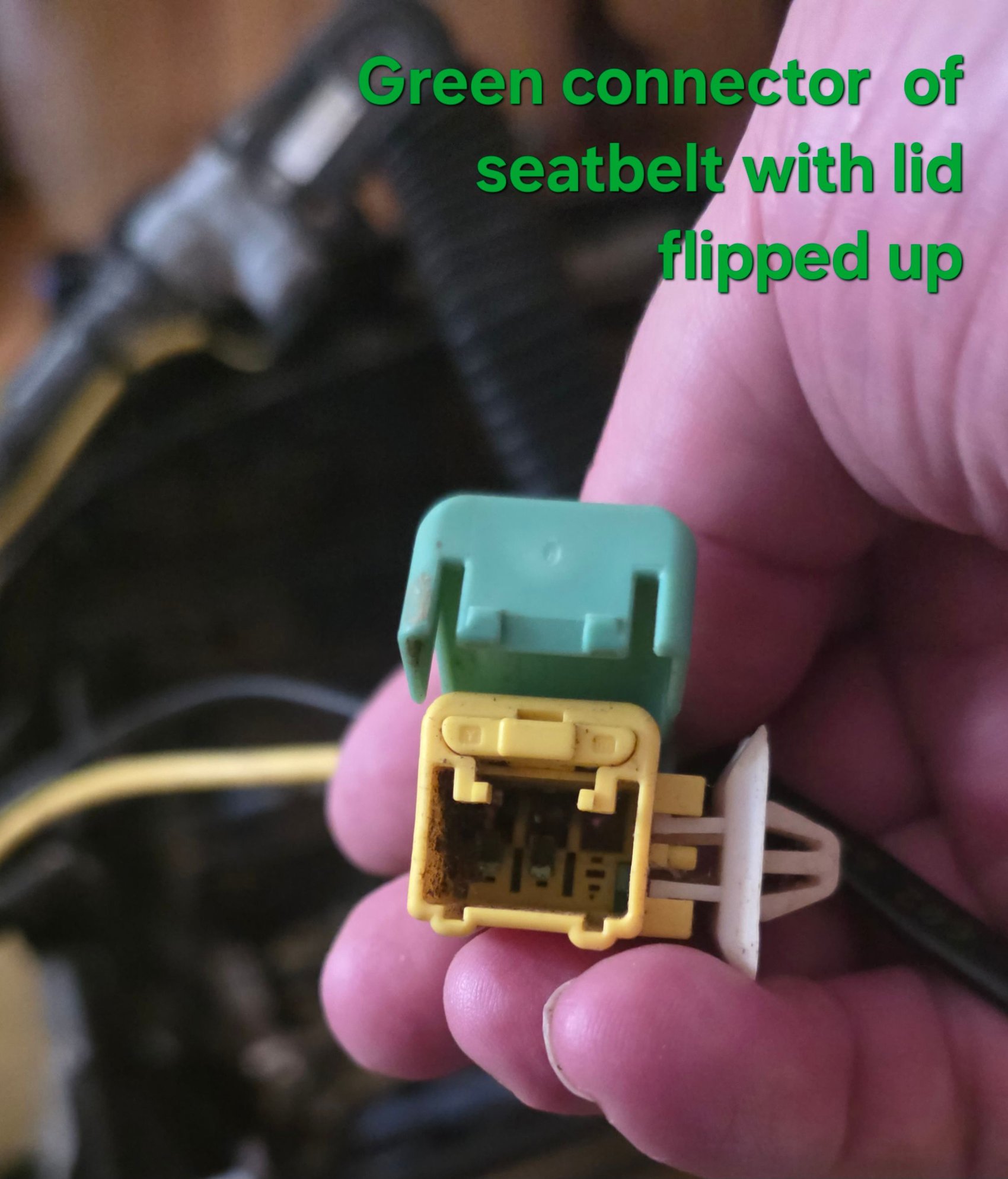

Hello @Precizion ,
Please see my previous post number 28 if you haven't, as I posted twice in a row.

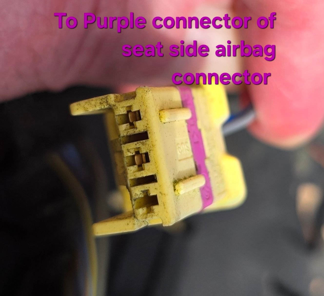

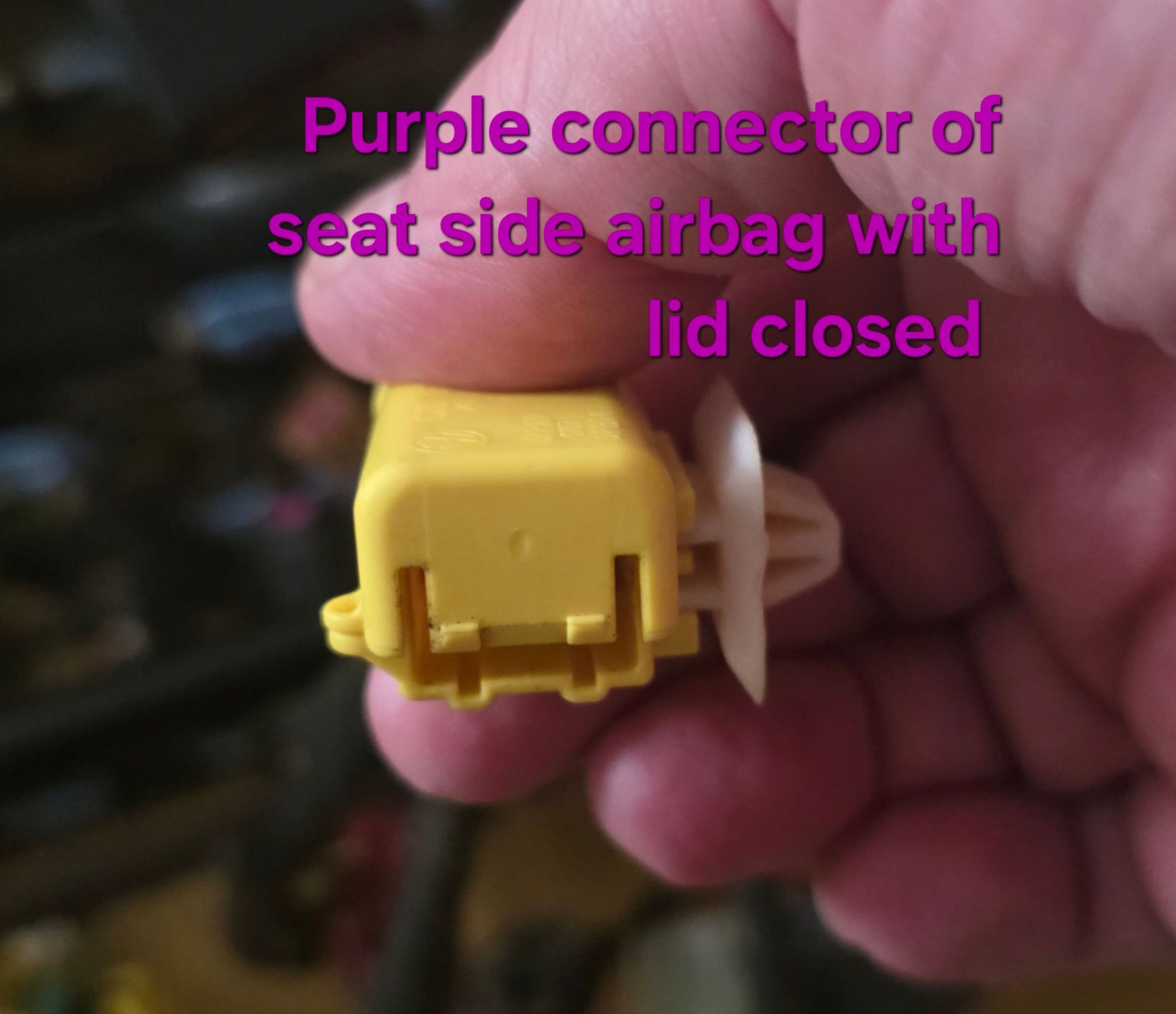

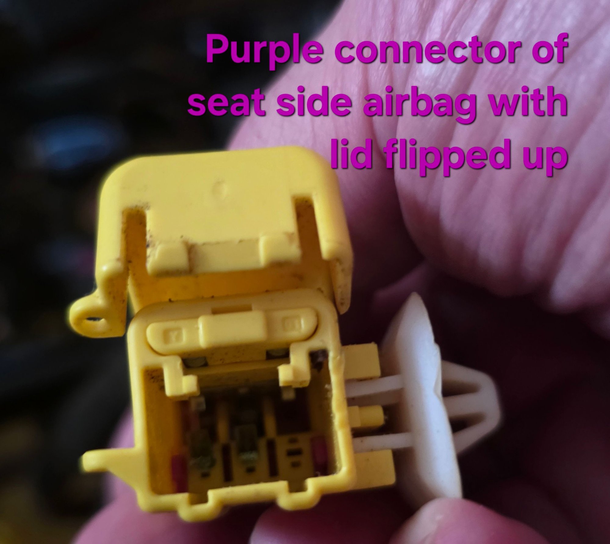

Here are the airbag connectors on my 2005 GT main wiring harness, seat frame/side airbag, and the seatbelt clasp/igniter, please take your pictures in the same way as so we can understand just what plugs you have, if indeed they are different.
There are only 3 connections, 2 for the seatbelt clasp/igniter, and 1 for the seat side airbag, they are as pictured, 1 green connection for the seatbelt igniter, 1 purple (2 pin) connection for the seatbelt clasp sensor, and 1 purple (3 pin/slot) for the seat side airbag.
I am not sure if you knew that lids on the green igniter and purple side airbag connectors have to be pressed at one end to flip the lid open, so I showed it in the pictures.
Johnny

Thanks Johnny, I will retake pics & study your pics. Brilliant! The pic of the facial Fuse Box was to show the strange cut off black wire.
