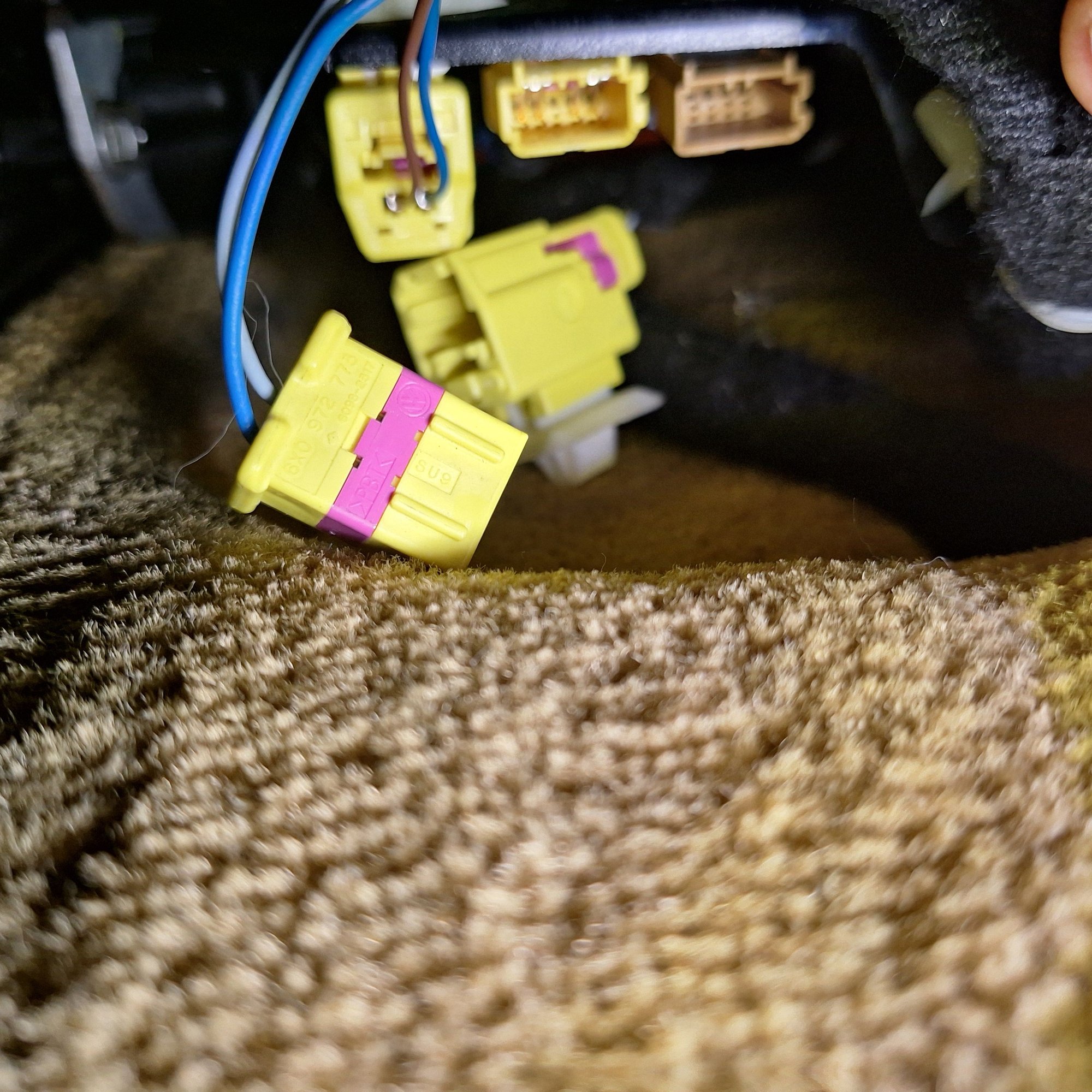

Hey,
I am a Bentley newbie! My Air Bag Warning Light is on and (coincidentally while valeting!) I found a Yellow plug with Purple band and Blue & Grey cable under the Driver's seat. I eventually also found a spare Socket,also with Purple band but with 'Pink' & Grey cable. It doesn't look as if they fit?
Any ideas out there?

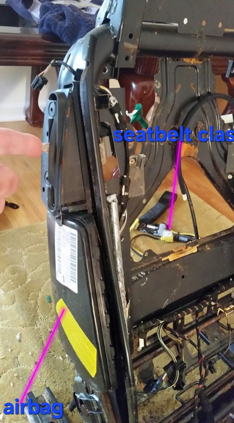

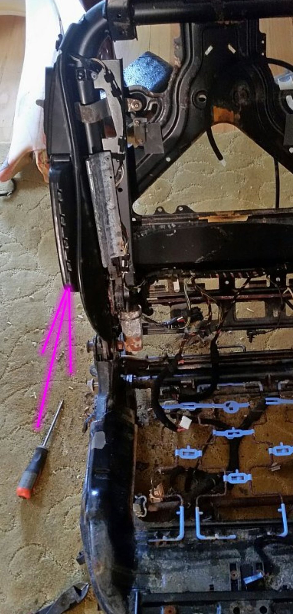

Hello @Precizion ,
Welcome to 6speedonline !
As to your issue, have a good look under the seat, move the seat to it's furthest back and highest height positions, you should see 3 yellow plugs/sockets on the bottom of the seat, and 3 plugs/sockets that come from the wiring harness that comes up through the carpet.
Sorry my pictures are not the best as to focus.
Did you just get the GT with the airbag light on, or did this happen somehow during ownership, anyone working on the seat ?
You will have to remove the black plastic cover as pictured to gain access to the seat control module and airbag plugs/sockets, that is, if it is still in place.
Johnny

Sorry, I'm struggling with the technology. I took a pic of what I found. There is an empty Socket, Yellow with a Purple band + Grey & Pink (?) wire. The spare Yellow plug has Blue & Grey wires & doesn't look as if it will rut the empty socket.

Thanks fir your reply. No, I was doing a bit of valeting when I spotted the Yellow plug! As I said, You can see an empty Socket, also Yellow, with the Purple band but Blue/Pink wiring rather than Blue/Grey on the plug. As mentioned, it doesn't look as if they fit together unfortunately. I will try to take a better picture.
I
I've got the seat as far back and as high as it will go & this is the best pic I can get.

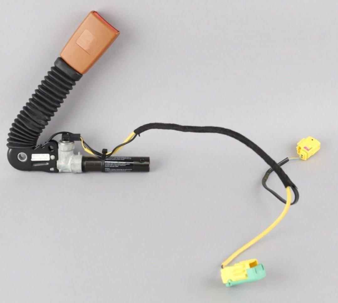

Ok, you have a 2004, and there in lies some confusion for me, as the two sockets you show to the right appear to be of multiple pins, meaning 4/8 or 5/10, it is hard to tell as the picture is out of focus and shaky, so a better in focus picture will help, as would a picture of the face of each plug laying on the carpet, as to show it's pins or pin socket count, as the three plugs/sockets I have on my 2005 original seats, as well as to 2006 seats from the parts vehicle, all have only 2 or 3 pins/sockets in each.
The three plugs are in this order as shown in my pictures, the blue/brown wire 3 pin plug goes to the seat side airbag connection, the other 2 go the the seatbelt clasp/igniter, this is one 2 pin plug and one 3 pin plug.
Now mind you, when I say 3 pin plug, I mean the the 3 pin plug is made to hold 3 pins, eventhough it only has 2 pins in it, whereas the 2 pin plug has just 2 pins/sockets.
Post a picture of this sensor you say was in the glovebox, it's probably an impact sensor for under the bonnet, or for the rear seating area behind the side panels.
From you comment, I take it that the airbag light has been on since you acquired the vehicle, and by the sensor in the glovebox, and disconnected plugs under the seat, the prior owner had issues with same, therefore, it may come down to you removing the three 12 point M12 bit bolts at the rear of the seat, then the two 16mm nuts at the front, and tilting the seat back for better observation.
