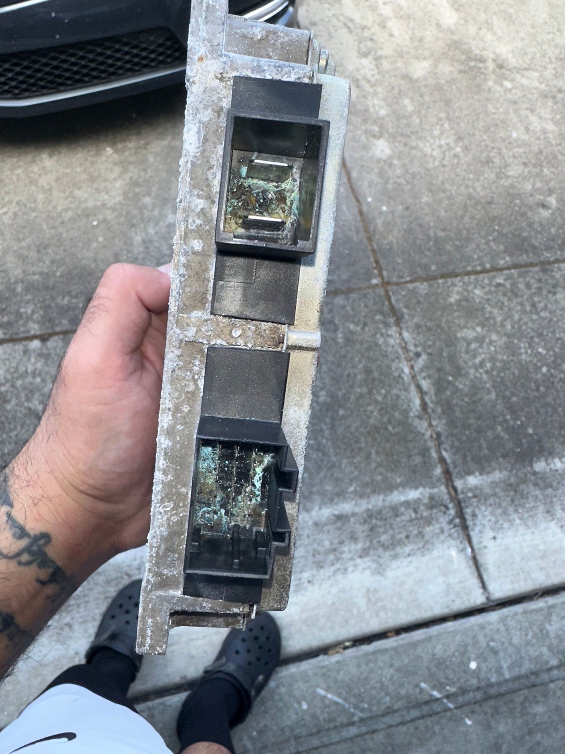

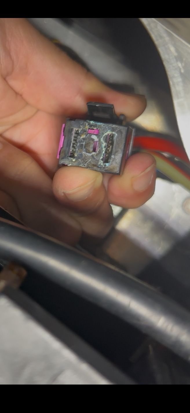

so I removed the battery control module and there was a lot of corrosion on the connectors and module. Also I heard a rattle in the old module. I cleaned the corrosion on the connectors and put the new module in and it still has the same issue.
