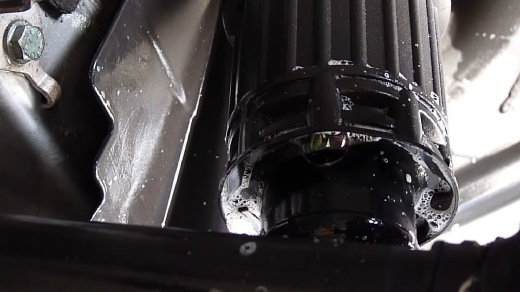

Anybody have any idea where the valve block vents- I have really small leak and all the struts/lines seem to be ok-thought maybe the valve block might be leaking internally, but can't seem to find the vent for valve block. It has 6 lines- 4 to struts, 1 from compressor and 1 to air tank. When car lowers from high mode to normal or from Jack Mode to normal the valve block must vent somewhere-any ideas?

The venting happens right on the compressor assembly itself, the black line I am blocking with my finger not only feeds the valve block (6 lines) from valve on the compressor, but it releases air from the valve block also, you can see the larger air intake tube into the valve mounted to the compressor, this tube has a muffler/filter, it is both the intake and exhaust for the air as I understand it, the the venting portion of the valve is on the bottom of the valve I show in my second picture, the 2 wires for the venting valve are in the brown connector plug shown in my third picture.
I would spray the entire valve block itself with soapy water to check for bubbles.

OK, that is not normal for your compressor to run every 45 minutes 3 times in a row, that's a definite leak, and yes, as I showed in my video, the compressor has a temperature sensor mounted by the head of the compressor, if it runs to often or for long periods, the suspension control module will shut the system down until the next restart of the engine.
So let's see what your compressor output test comes up with, also, as I suggested, I would check the very top of the front right strut as I pictured with the bubbles.

Ok, that makes sense, just seems like compressor wouldn't get too hot running for 20 secs and then off for 45, but maybe it's a number of times it runs vs heat alone.
We did check the top of the RH strut- sprayed everything on right hand strut after replacement. What's weird is it's never consistent, the more I drive it the less it drops over night, but even with that sometimes it will go 2-3 days and hardly drop and then sometimes it will drop a lot in one night. For an example, I might move it from one bay in my garage to another one so I can get another car on hoist and then it might drop a lot that night, but if I drive it a fair amount for 2-3 days in a row, it might hardly drop at all overnight. If it was more consistent, I would think a strut issue, but the other seems like valve block sticking. Where does the intake/muffler terminate? maybe I'll stick a balloon on it and see if it blows up over night, LOL
