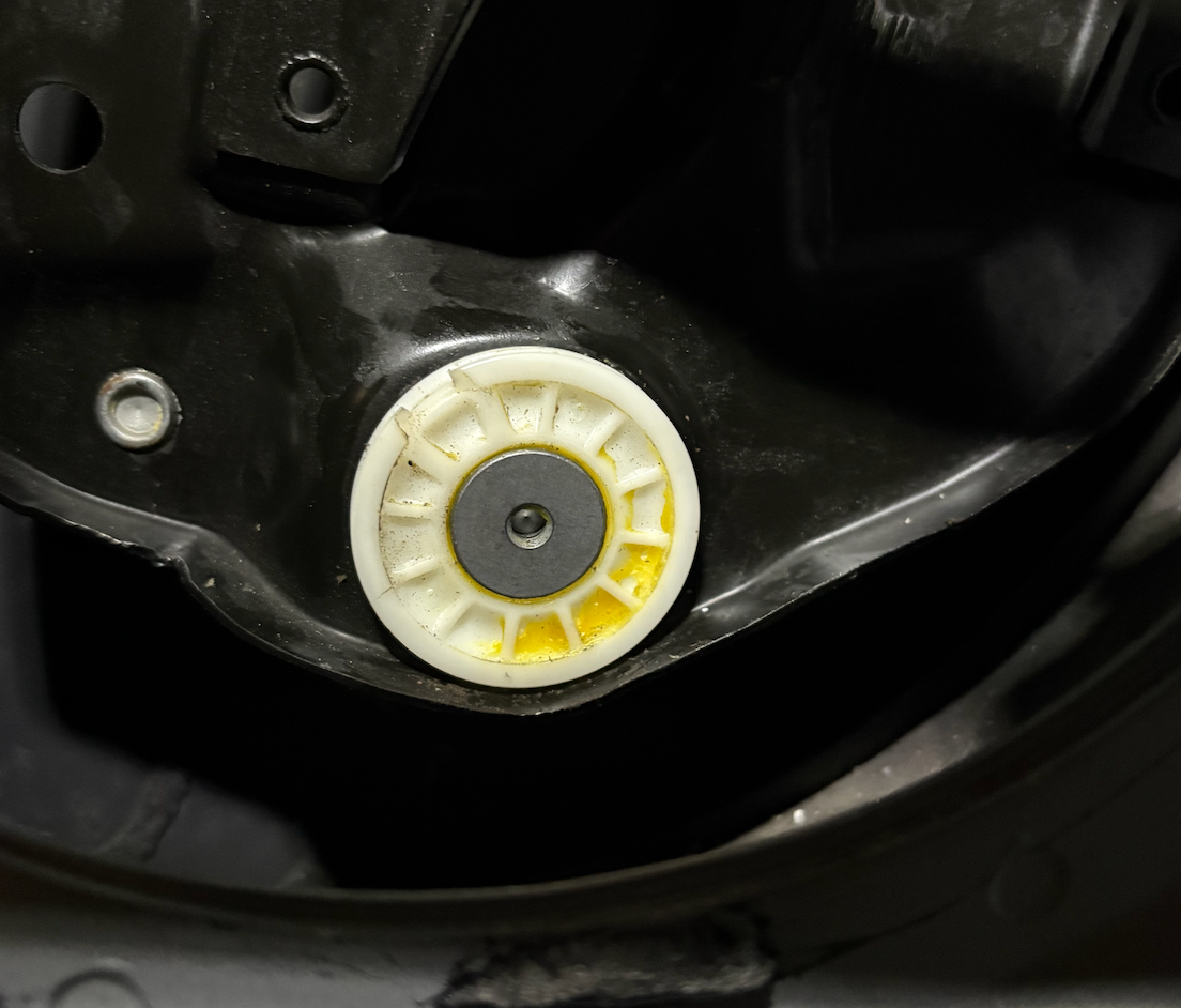

So it looks like now I have spotted what actually shattered.......the top pulley......the top version of this (bottom is pictured)
Is this replaceable or is it new window Regulator time? Raging as regulator repair kit seemed a good option!!!

Actually this looks like what I bought, which looks like it has one pulley so I maybe saved!!!
I maybe now just need to remove the window and the regulator in total to repair it.......

Originally Posted by 1eapplebaum
That's the kit ...umbrella not needed.
You dont know how you get the top wheel out thats the white one in that kit, do you @1eapplebaum ?
Is it drilled out?
