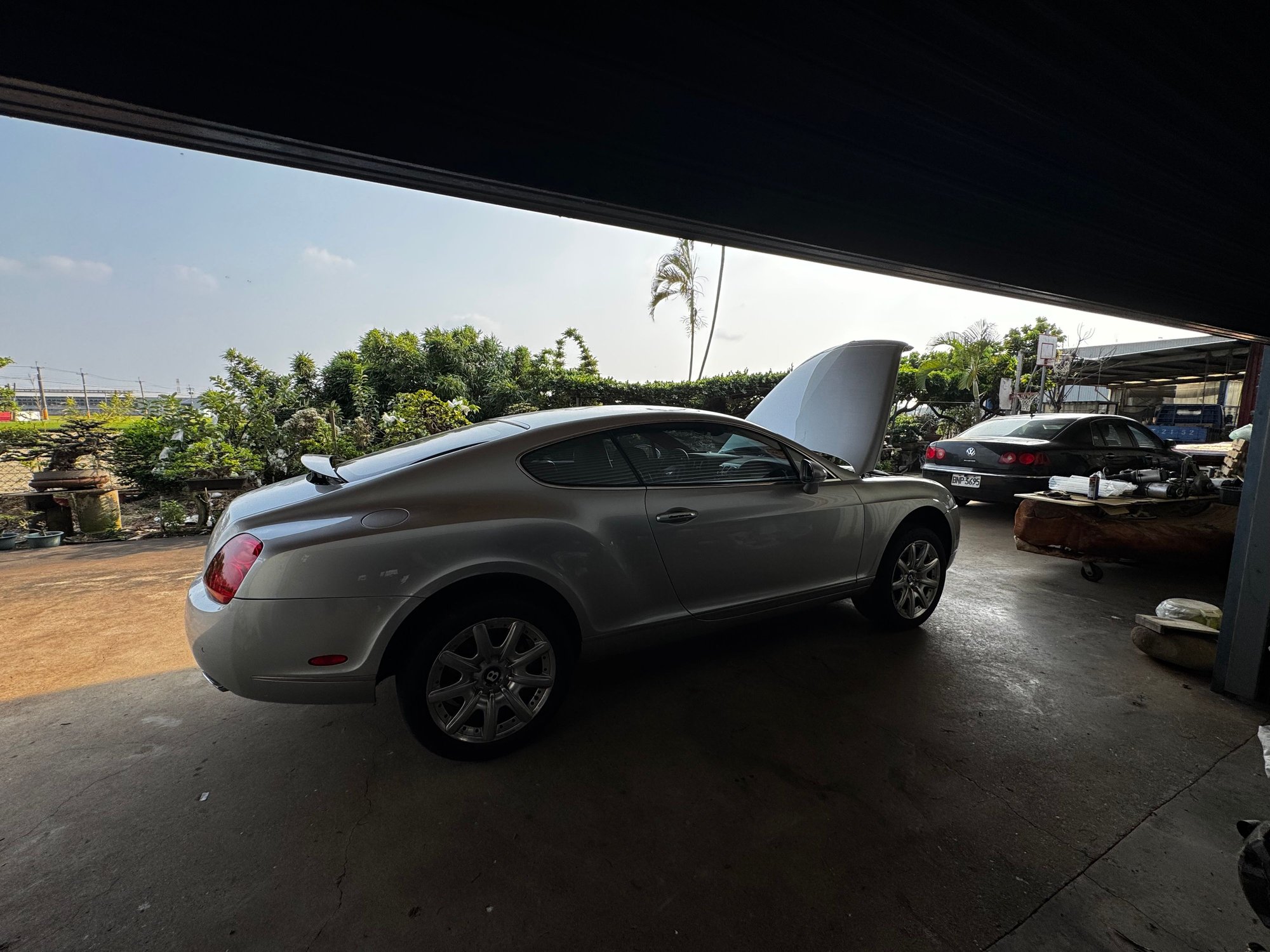

I got a 2006 Bentley continental GT
I replaced all the height sensors about one month ago, the suspension runs okay and smooth, but a little bit unbalanced. Left front is higher about 2 cm and the rear ones become lower. (BUT drivable)
Therefore, we used height adaption function through computers. After that, the suspension locked in safe mode (highest position). I almost become in-drivable, extremely hard and bouncing all the time.
From the VCDs, THREE height sensors appeared wrong ( all -127 mm something) The faculty code of the three sensors cannot be erased. It appears even we erased them, again, again, and again. It appears that the values of the height sensors are not reliable/ they are wrong
It locked in the heightst position, is not drivable now, too hard and bouncing all the time
It locked in the highest position, is not drivable now, too hard and bouncing all the time

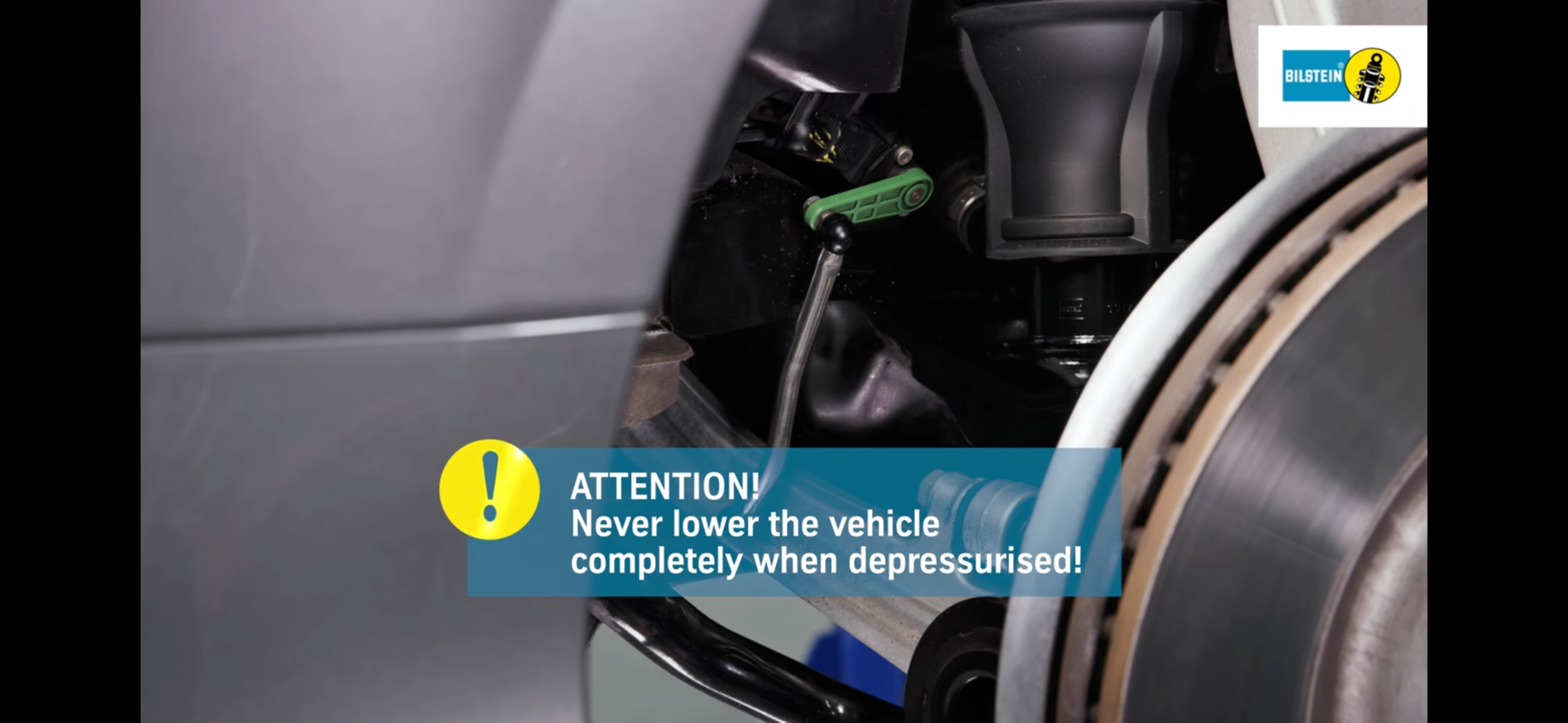

I replaced the front sensor like the photo (taken from youtube)

(4) Do you guys have the picture showing the correct way to position all the height level sensors?
