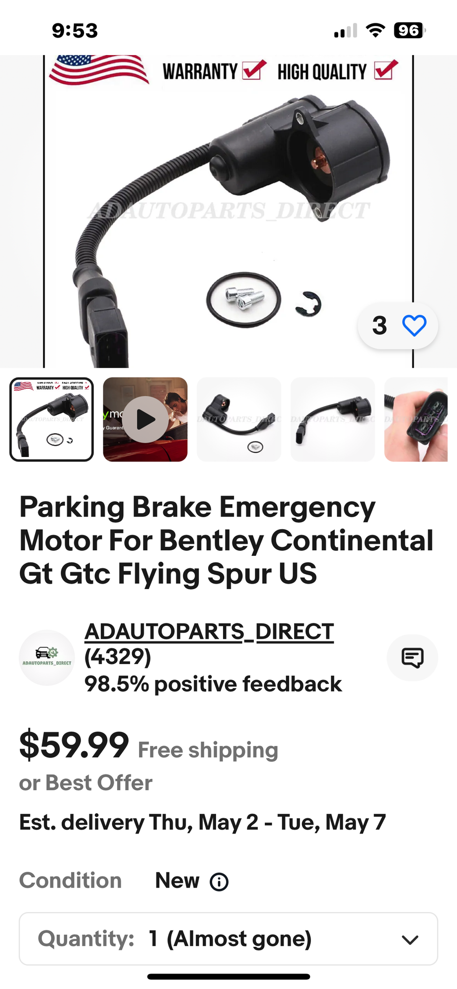

3. Started Shopping for the parts...Part Number: 3W0698996E ... Scuderia Parts had those motors for $648 each ( https://www.scuderiacarparts.com/par...operating.html ) searched some more and various prices till...$59.99 on eBay (https://www.ebay.com/itm/39411795653...Bk9SR5LEiqHlYw)... I called my independent mechanic in Florida that does all my work in the Bentley he said "GL this is a common failure the housing cracks and water shorts out the sensors, buy the cheapest on you can find and buy two of them, since they are $60." So I ordered the eBay ones for a total of $120.

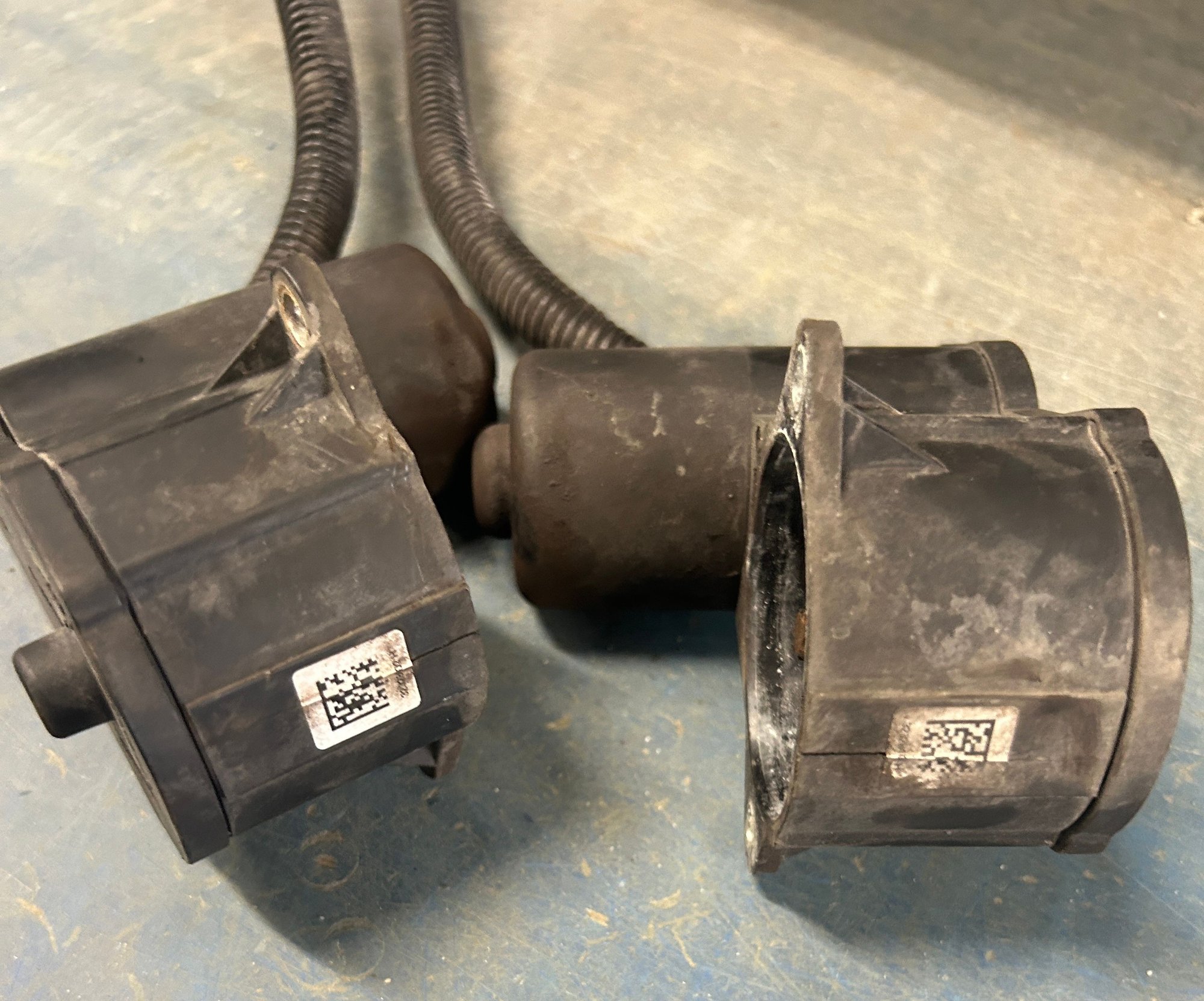

6.This Saturday a friend who owns a small mechanics shop here in Vermont called said he had time, I had asked him if he could do it and he came in Saturday to do it while we shot the **** about boat racing and all kinds of stuff. Took him about an hour and a half. He did have to brush the area on the calipers where the motor seals (Part came with new seals) and greased everything so water would not come in. He did observe that the housing of these motors were cheaply made and we noticed that the old ones were both cracked in the same place.

Shopping for parts....Scuderia...Seriously!!!The eBay listings for the same parts....

The two old motors cracked in the exact same spot. right through the QR sticker...

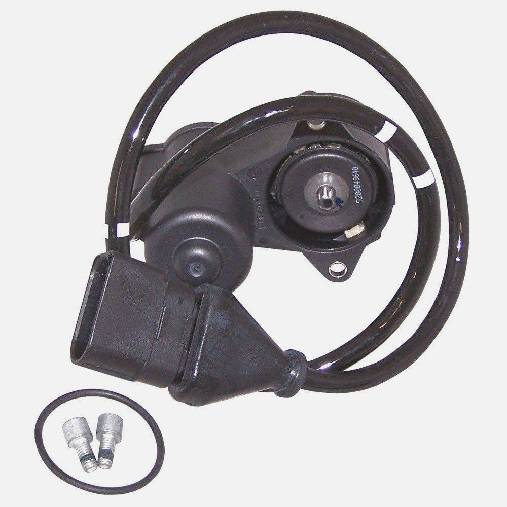

They upgraded the part for the 2015 MY. Note the much larger wall thickness where it usually splits:
Up to 2014 is 3W0 698 996 E, from 2015 is 3C0 998 281 A.
A pic of the original part for reference:
