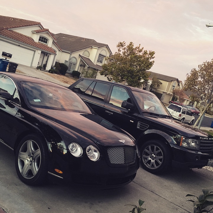

So I have owned my first Bentley GT for 2 months now
Specs:
2005 Bentley Gt
68k miles (I know alot :/)
Stock
