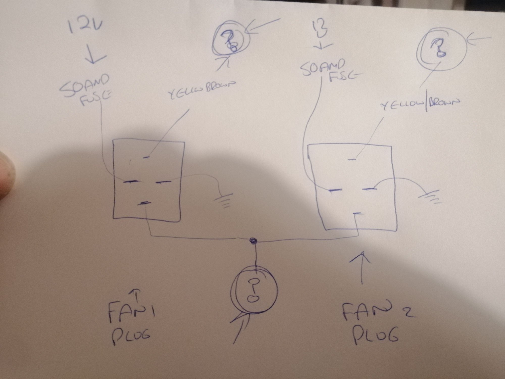

Hi. I have checked the fuses in the fuse board both 50amp are ok. I hace checked wiring on eacj fan plug and all wires jave continuity to the same pins apart from the yellow/brown wire which has no continuity to earth or live or even together on fan plugs.
​​​​I need to find where they go in the fuse board or ecu and which pin and location if anyone can help please. Photos are better.
Cheers Simon
Old Jun 13, 2023 | 03:47 PM
Mitchy1971's Avatar
Joined: Jun 2023
Posts: 16
Mitchy1971 is infamous around these parts
Fan plug diagram attached. 2 thin wires from the plug. Where do they go

@Mitchy1971 ,
Give me about 10-15 minutes to post.
Edit, is your vehicle LHD or RHD ?
Johnny
