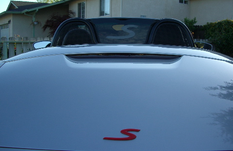

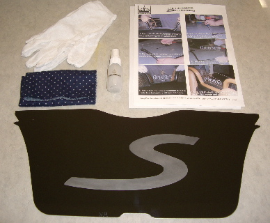

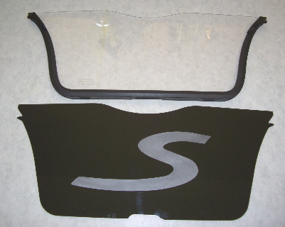

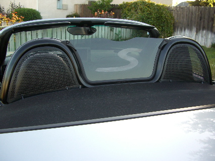

Windrestrictor Review
I received my Windrestrictor today and as we suspected you do reuse the Porsche mounting hardware. In fact you just snap off the whole plastic surround that goes around the edge of the Porsche OEM windscreen and then snap it onto the Windrestrictor. It's a pretty easy job. I did it without tools and had it installed on my car in minutes. The quality is excellent, I really couldn't be happier and they did a great job of creating a custom design for me based on some digital photos that I sent them. My ***istant is just disappointed that I didn't get pictures of her stupid dogs etched on the windscreen.
