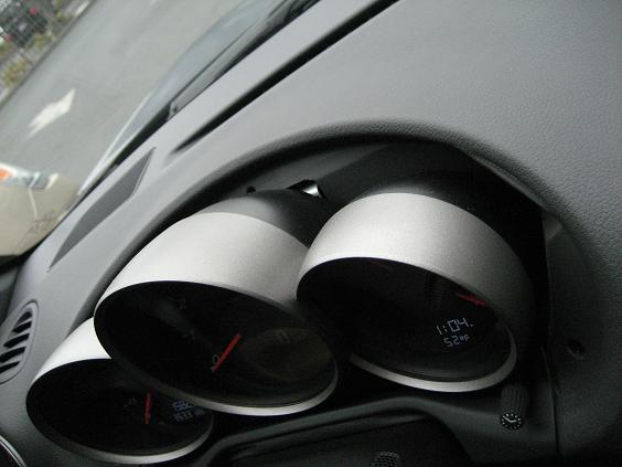

Pic Of My Instrument Cluster
This is how it will look before you get the trim piece from suncoast .. Kinda like Riding a Motorcycle .I must say after only 2 days of driving with the Removal I really Like it .It just feels different and I like the fact you can see the top of the Gauges from outside the car ..

Bigger Picture
Other one was too small to see ..

side View Picture
Side View Picture Before adding the Suncoast Trim Piece.No painting Needed gauges look really great just how they are ..
