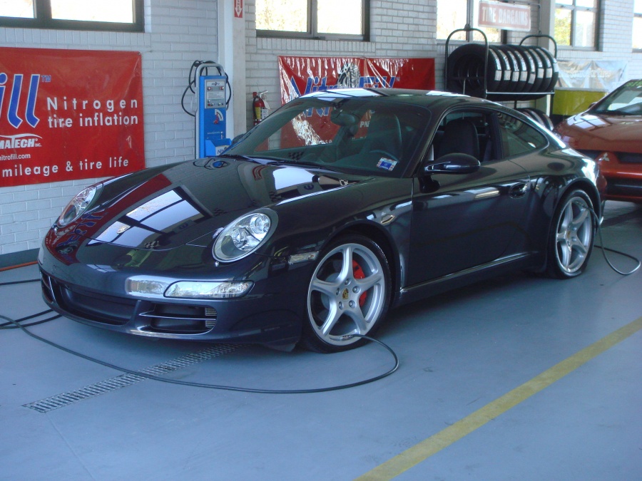

Nitrogen is more consistent across temp ranges & leaks less. Still needs to be checked though.
Old Mar 25, 2009 | 05:19 PM
H-MAN's Avatar
Joined: May 2007
Posts: 209
From: Raleigh
H-MAN is infamous around these parts
Nitro. For me it's about extending the life of my tires.
