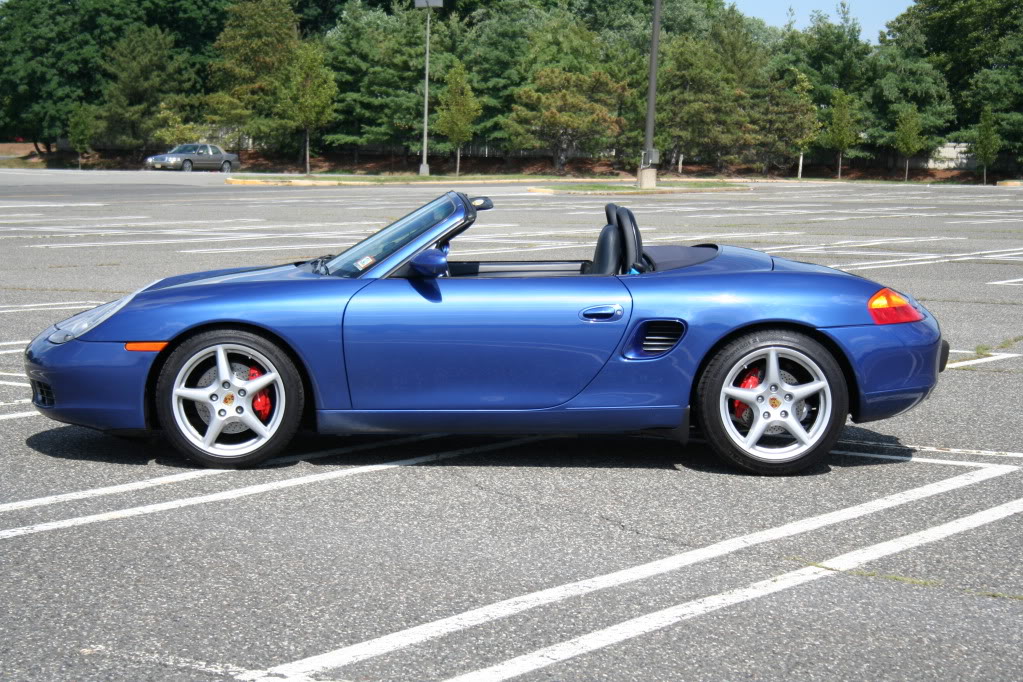

NO NO NO 997 wheels do fit!!! 18 x 10 (15mm spacer) fit. 19 x 11 do not fit. Its not the off set. YOU can't run 11,s 10 is the widest. I use 18 x8 and 18 x 10 997 wheels on my boxster

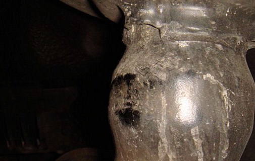

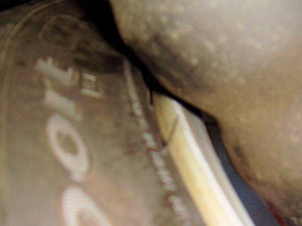

those black spots is where the wheel or tire is rubbing
