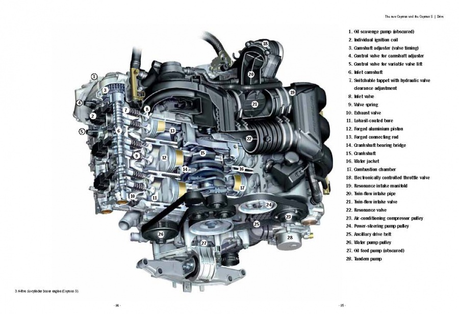

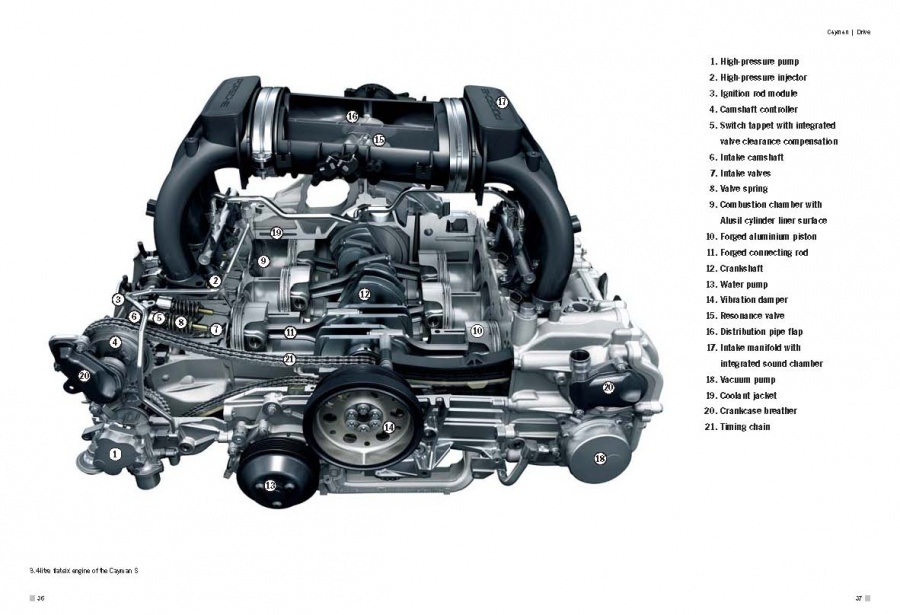

From looking at MY09 3.4 engine, camshaft is driven at front of the engine but MY07 engine has timing chain at the back of the engine. I cannot see IMS in 09 picture. Does this mean no more IMS problem in 09 engine? Does 09 engine still has RMS problem?

No IMS or RMS... 40% less moving parts... Big step for porsche.

A much better design, but now it has a "vibration damper". Wonder why that is? My 07 Cayman has a tad bit of vibration around 2.2k, maybe this engine was bad enough to add the damper. Maybe they changed the flywheel too?
Also noticed they got rid of the single bolt on the pulley, have heard some reports of the old one coming loose when replaced with LWP.
