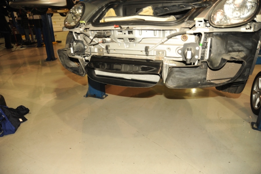

Wanted to take a moment and announce that we have been working pretty hard in bringing to market a system that we consider to be superior in quality and parts than most would expect. We are producing everything state side with parts that are made in the USA.

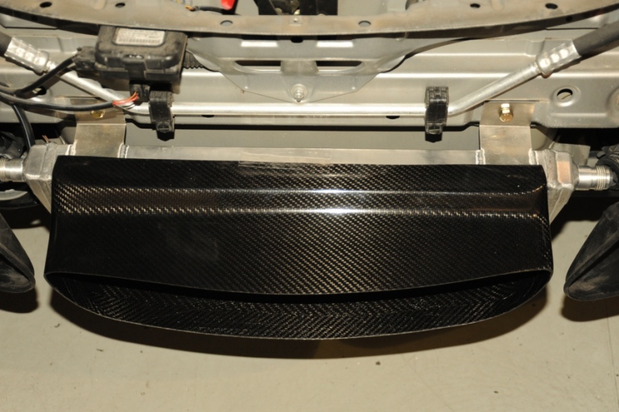

I have attached some pictures to show some of the development and progress that we have accomplished with our vision. Notice that we have a radiator coming with the kit with its own custom design radiator duct made in Carbon Fiber. We designed and made the plug for the Mold and we hired Crawford Composites(one of the best) to make us a real nice part.

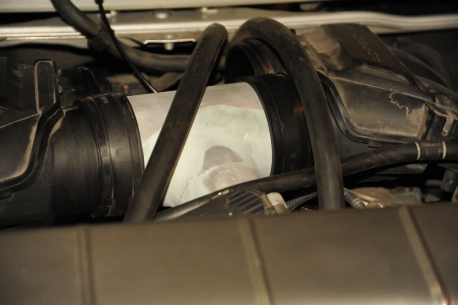

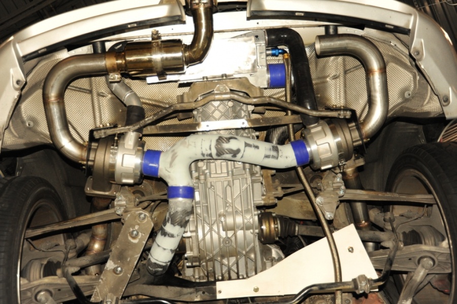

The inlet and outlet tubing to and from the turbos as well as throttle body is also going to be made in carbon. No the easiest thing to do but you can see from the pictures the routing of the tubing. From these pieces we will give the a mirror like finish and use the to make a mold. Doing it this way ensures consistent fitment with having to weld the tubing in aluminum. Easier to make after mold is done and the parts will look incredible.

The turbos that we are using are variable turbine nozzle.This means that they will build boost under 3000 and all in by 3200. 5-6 psi is all we are currently running in the GT3 kits we have done and 996's. Also the turbos are not difficult to install since the oiling is self contained. That was something that we thought was a pain to do and also having to rely on an external electric or mechanical device to return the oil to engine. Having tried the it already and not having that great of luck. This is just perfect IMO.
The radiator and intercooler will be circulated by a water pump that can flow 23 g/min a lot higher than the Bosch pump available for such application which is delivering 5 g/min without head pressure. The water will be carried around with Brown and Miller stainless braided hose with a convoluted teflon core that will not kink or pinch in tight corners and will also add protection against rubbing. It also looks the part of a nice designed kit.
