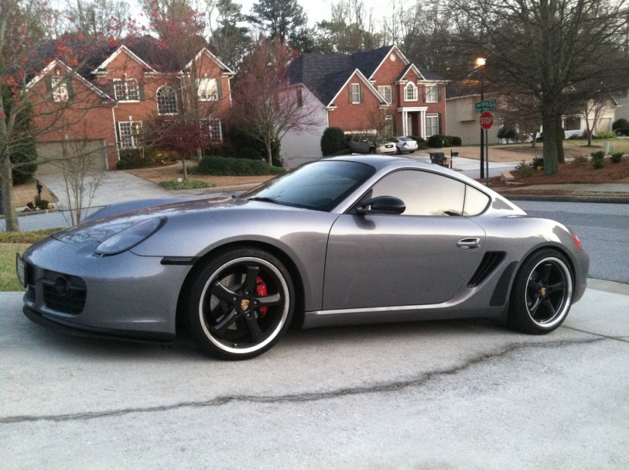

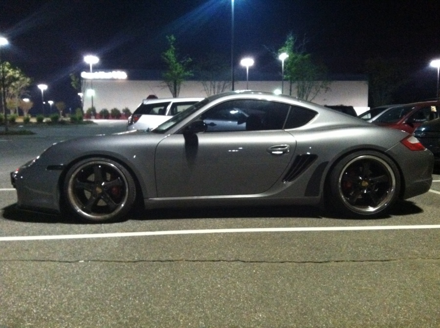

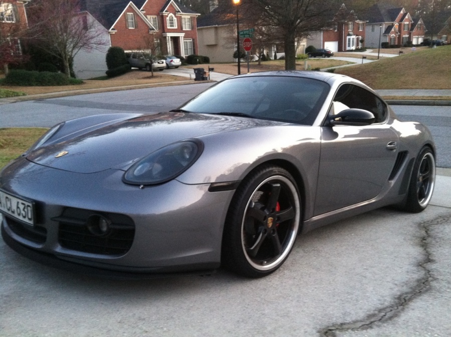

19x8et30 with 225/35's up front
19x11et 25 with 265/35's out back
First pictures are lowered on the H&R springs and the last picture is lowered on PSS9's. I'll get some 3/4 shots and post those up sometime soon.
I rub just a tiny bit on really large dips but gonna dial in a little more camber and that'll fix the rubbing issue. Also going to roll the rear fenders as well.
