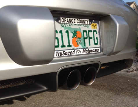

Weird, I just put on the exact same exhaust tips and I didn't cut anything. I would say though that I completely removed one side of the exhaust and removed the retaining bracket of the other muffler to get enough room to put the whole thing together. It fits perfectly. I like the gloss black tips. I angled mine slightly higher than yours from looking at the pictures. And I wouldn't say its just you, definitely more of a growl on start up than bone stock. Also, have to say Fabspeed quality is one of the best I've seen. Even the clamps are far superior in quality than anything I've seen on the market.

I'm very happy with my decision, it's exactly what I wanted.
We took the the entire exhaust off to fit it properly, then again I wasn't overly excited to bang around with my ceramics at risk. I'm surprised you were able to fit it the piece on fully without cutting the pipe, as the wider diameter piping causes contact with the curve of the Fabspeed piece and it can only go on the stock pipe so far. We only cut about, say 2 quarters stacked on one another's worth.
