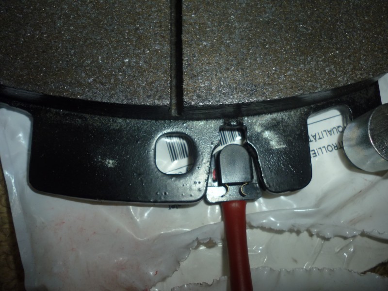

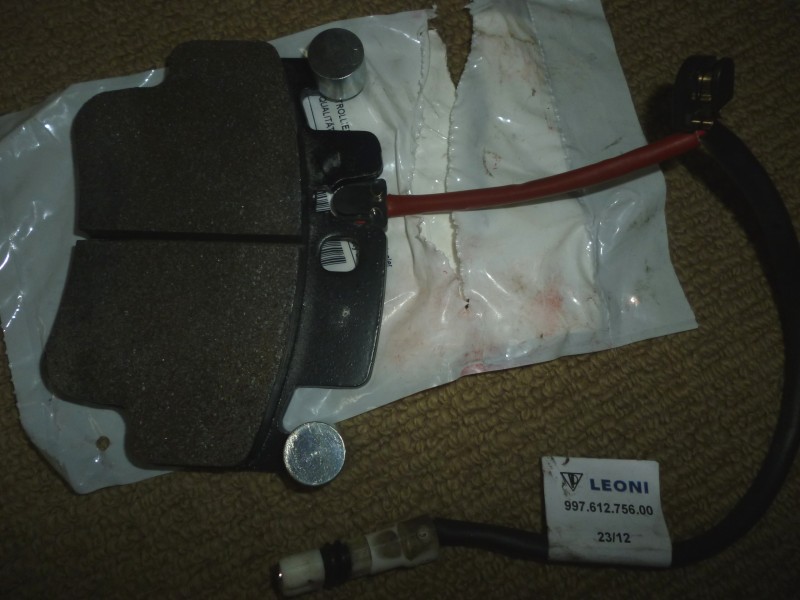

I've been doing some research and found some nice instruction guides with pictures for replacing the pads and sensors. So I think I have a slightly better understanding of what is what and where it goes.
So for one, I think you're right - the Hawk pads I have do seem to have the slots for wear sensors. Though, the factory wear sensors do not fit into these slots. It seems the slots are too small. Or the thickness of the backing plate is too wide for the sensor. See pics below (front pad).
Has anyone else had this problem? If so, any suggestions (besides disabling the sensors)? I would love to make them work with the sensors considering they seem to have some sort of slot for the sensors.

Attachment 194172
Attachment 194173
In a pinch you can zip tie the sensor wires out out of the way. Put a small plastic bag over the sensor end and use two zip ties. I did this once but never again. I got tired of explaining to the tech/service manager why whenever I had the car in for service.
Next pad change I went back to using the sensors. I like them and the fact I do not have to worry about the brakes wearing out without any forewarning. However, whenever I have the car in for service the techs always inspect the brakes and report on pad thickness so there's always that back up...

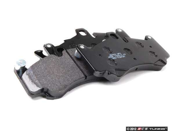

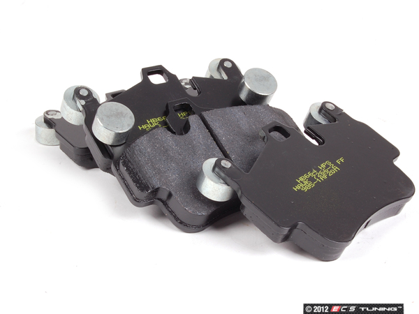

Those really look like GT2 front brake pads. Like the one shown below.
The Boxster S should look like this.

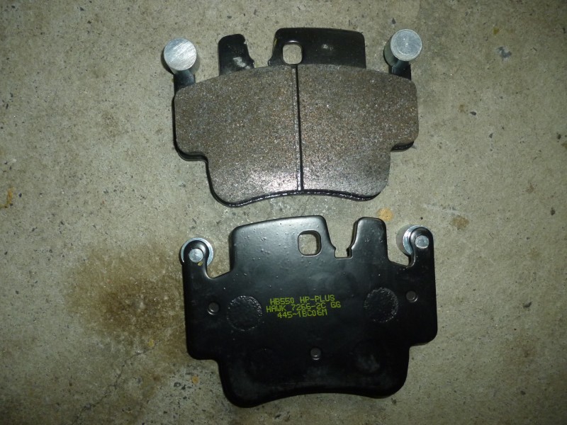

Here's another shot of just the (front) Hawk pads. They do seem to fit in the caliper / housing. But the wear sensor does not fit.
Thanks for the pics ECS Tuning - Porsche. The Boxster S pads you posted have a reference HB664 7266-2. The one I got are HB550 7266-2C ... so obviously they're not the same pads ... but those are HP Plus.
Also I just heard back from Hawkpadsdirect and they did confirm that the pads I have are the correct pads for 2008 Boxster S. Though, also they said that the HP Plus pads do not have a location for the wear sensor ... which is what I thought that slot next to the pin hole was for.
Seems like to fit these I have to do what's been suggested before - and cut/loop the wear sensors.

No need to cut the wear sensors. Just leave the sensor lead plugged in -- it protects the very critical connector at the wiring harness -- and tie the things up out of the way. I can't recall what I zip tied the sensor wire to but you want to be sure you zip tie it to something that doesn't move relative to the sensor wire connector.
