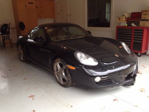

Major Accident Repairs Question

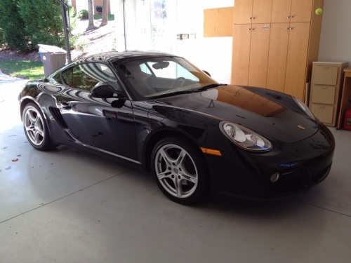

I have a 2009 Porsche Cayman and it was in an accident. Mostly front end and under body damage. It has about $20k in damage including parts and labor and I am looking for suggestions and experience with major repairs on a Cayman. Concerned that it won't be the same even though I've been told no suspension damage but the underbody damage will require straightening the front clip.
Before
After

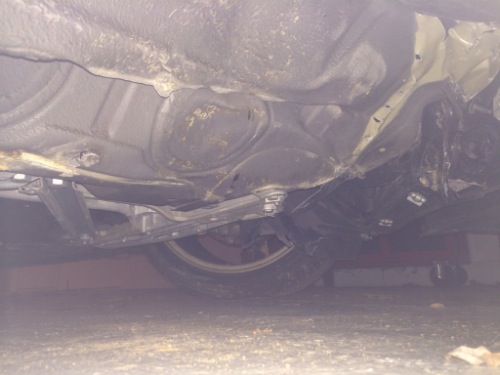

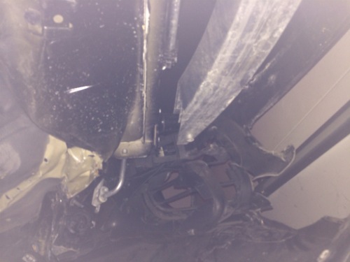

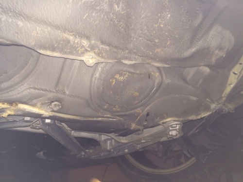

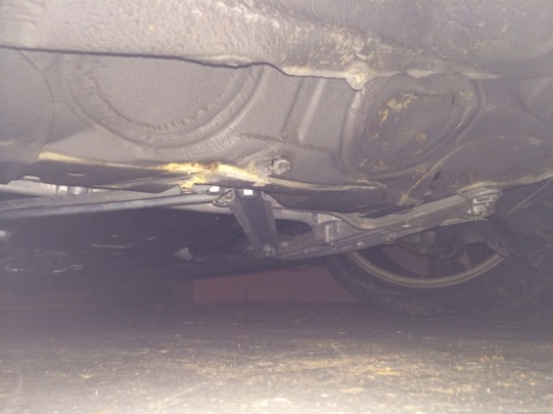

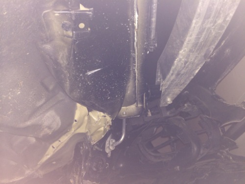

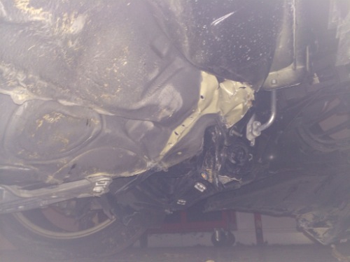

Here are some pics from the underside of the front of the car.

It CAN be properly repaired but do not assume it will be. The car must be installed on a Celette bench fixture to insure proper straitening alignment. Qualified shop will have this equipment in the shop, don't waste time at the shop until you see the Celette 1st.

That doc is hugely helpful. Would imagine I could contact the manufacturers of the equipment and find out who has one in my area. Thanks.
