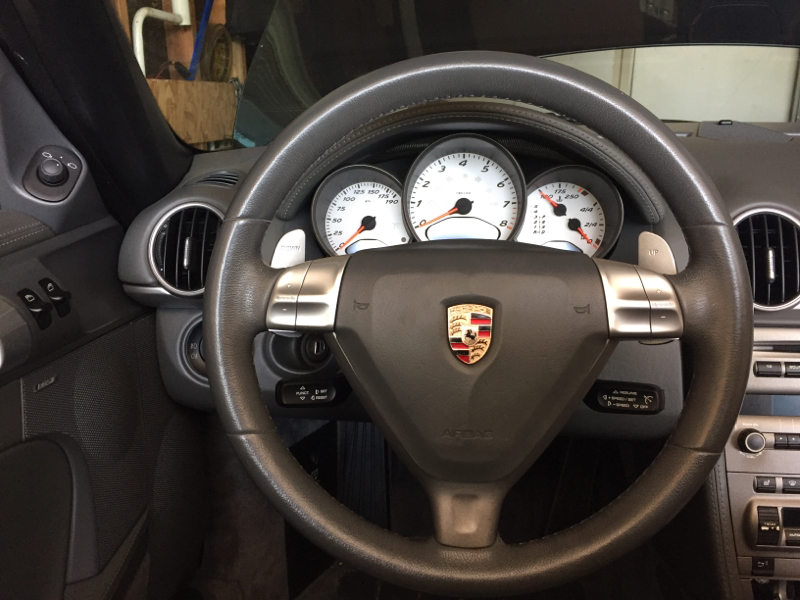

I did it. Easy. Used the Mercedes paddles. Doesn't change anything but still!

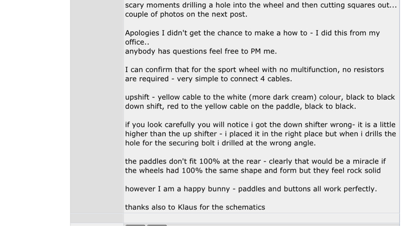

Ok. Ok. I found the info on a uk site. I'll try to find the part number. Basically pull the airbag and steering wheel. Mark the back of the wheel using the paddles as a template. Cut out the plastic on the back and drill one hole for the wires and one for the mounting screw. Mount paddles and wire as the attached image says.

Sorry. Here it is

And the mounting!

It doesn't really do anything besides a feeling. I always hated the tip buttons. I had hit them on accident at times and even in drive they will lock the gear for a bit. The paddles are cute. Up in the hills I like the ability to keep it in the gear I want. But honestly the tip will hold gears pretty well on its own to me. Some times I upside just so it am doesn't hold the gear as long. I would link to the site I found the info on but I don't remember, so the credit goes to somebody in the UK. I do like that the Mercedes paddles are metal not plastic. They have a nice feel and match the interior.
