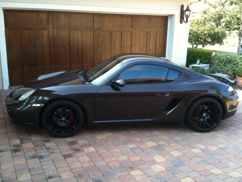

I did H&R springs on my 08 Cayman along with 19s and I must say I have been pretty bummed. I wish I just coughed up the extra cash and did coilovers bc there is still about a 2inch gap in the rear that drives me nuts.

That's odd... the H&R springs (unless they changed it in last year or so) usually have the car sit lower in the rear than the front. THere are a number of threads on another forum on this subject - search "negative rake". I assume the springs have settled? Take some measurements and report back - measure from center hub to top of fender opening. I started a thread on another board where different folks post their ride hieght with different springs. Someone I know with HR has 14.25" front & rear - overall range appears to be between 13.75 - 14.25.
Here is a picture of cayman with H&R's... and it doesn't look like a 2" gap in the rear.
http://img22.imageshack.us/i/imagen204h.jpg/

Thanks for the help I measured the front to be 13.50 and the rear 14.5 I also attached a pic and the wheels are 19s. The front gap isnt to bad but the gap in the rear looks pretty bad.

How new is the setup? It usually only take a couple 100 miles or sit yourself in the trunk to help accelerate settling. Eibachs usually sits higher than H&R. I would suggest jacking up the car and look whether there are rubber spacers/perches on top of springs. Some cars come from factory with rubber spacers. So, give it a look.

Ive had the springs on for roughly 1200 miles now so they should have settled by now. I am going to look for a rubber spacer tonight and if I see it I will have it back in the shop to be removed hopefully solving the problem.
