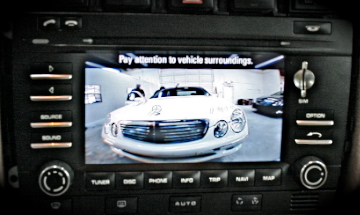

Well, I finally got myself a Porsche. After so many years working on Porsche vehicles, I figured I'll get my wife a Base model and get to be one of the first to play with the new PCM3.... Killing two birds in one shot.
I got the car over a month ago from Champion Motors in Pompano Beach, FL.
It was literally the first 09 on the lot, still wrapped in it's shipping plastics... I was surprised how well this car is protected during shipping compared to other vehicles I've seen.
I drove the car for 9 miles to our office and immediately pulled the PCM3 radio out. I inspected the radio and then reconnected the radio back and went straight for adding a backup camera. That was easy, 3 hours into the ownership and I had a fully working backup camera in my base model V6.
Next came the Bluetooth and iPod / USB / AUX retrofit. To make a long story short, this took 7 weeks of engineering. Last week I got everything completed (During all this time the car did not move) and this week I was finally able to deliver the car to my wife, who of course could not care less about the effort, she simply plugged in her iPod and drove away... oh well.

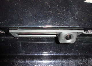

Richard,
When I said easy I meant easy to engineer.
The actual installation of the camera is not extremely difficult, But I wouldn't call it EASY.
In the process, the radio must be removed, the rear hatch trim must be disassembled, and some wires must be ran from the radio to the camera.
The good news is that I have sourced an original backup camera that replaces the rear door handle (see photo). I have documented the entire install procedure and it should be published within the next few days.
BR / Moni
