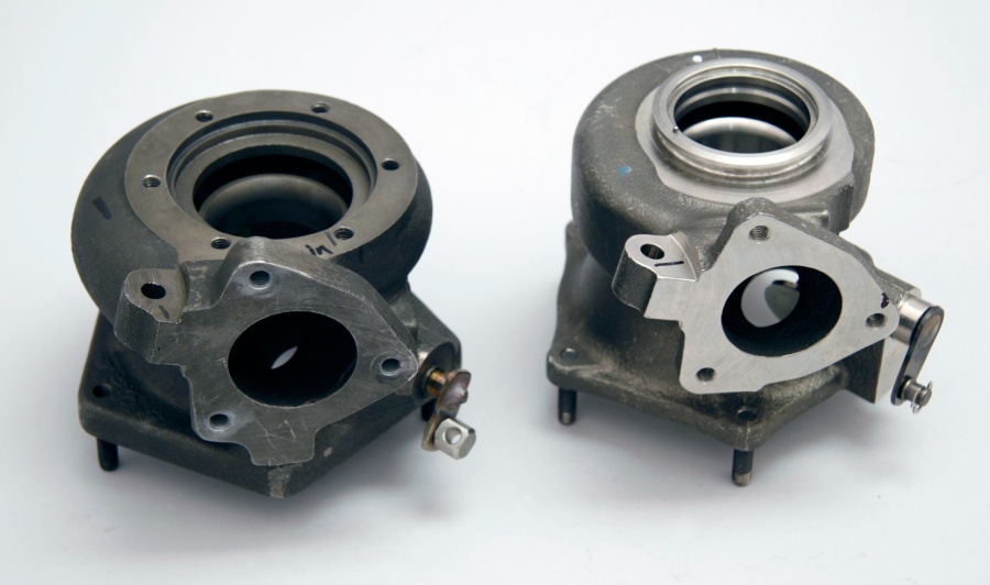

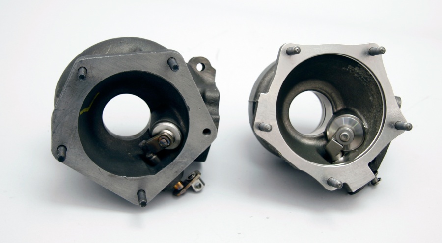

The long awaited release of our GT700 Performance System for the new generation Cayenne Turbo is nearing its completion. This Cayenne TT has all of the goodies including a full Techart Magnum Body upgrade as well Techart wheels. I will post some photos of the Cayenne before and during the building of this beast. Listed below are some of the engine modifications that we have made so far:
· EVOMS 955/957 Custom Cast Turbine Housing (accepts Garrett GT28RS Turbocharger)
· Garrett GT28RS Ball Bearing Turbochargers w/ OEM Machined Compressor Housings
· EVOMSCNC machined billet oil line inlet adapters
· EVOMS / Garrett upgraded 1 bar wastegate actuators w/ new mounts
· EVOMSCNC machined billet water line adapters
· EVOMSturbocharger water cooling lines
· EVOMSoil drain adapters to fit new Garrett turbocharger
· EVOMS fabricated down pipes w/ high flow 100 cell HJS Motorsport catalysts
· EVOMS 70mm stainless steel secondary catalyst bypass pipes
· EVOMS V-Flow X2 Cayenne TT high flow intake system
· EVOMS Billet Diverter Valves
· EVOMSit tuned SDI4 Siemens-VDO ECU calibration
· Cargraphic 70mm sport exhaust system
· IPD Intake Plenum
More photos and details to follow.
