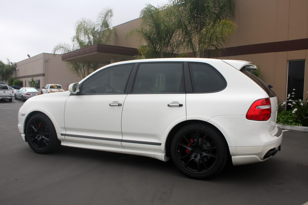

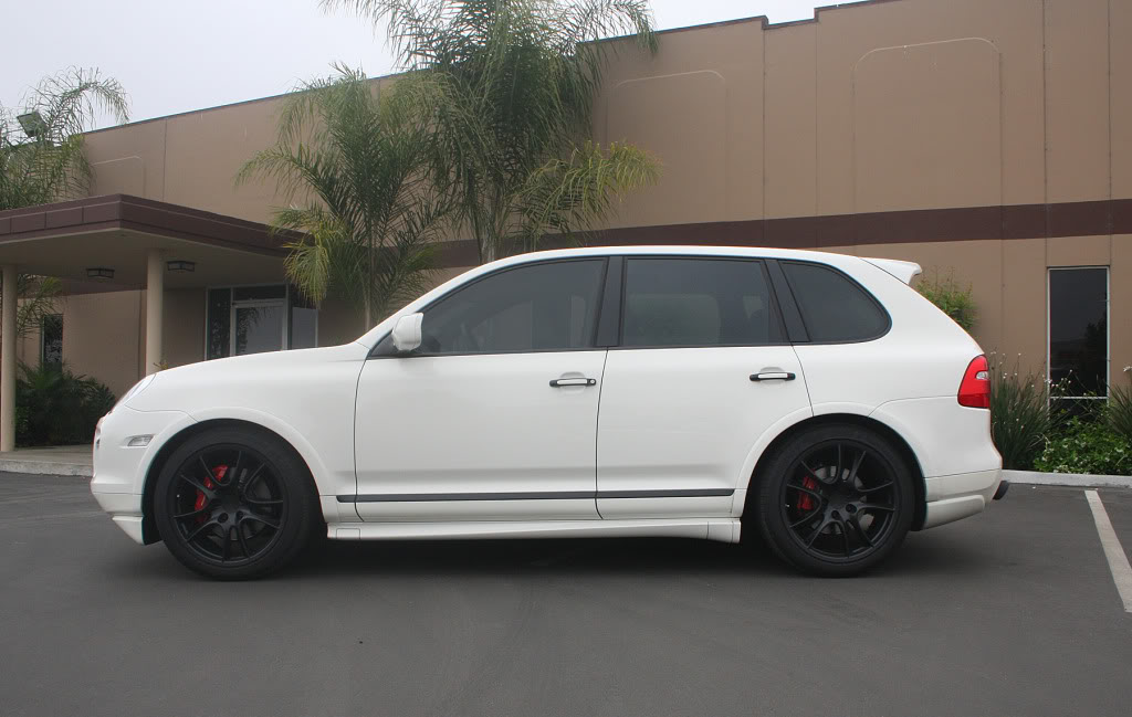

Our project 957 GTS uses the Cargraphic Lowering Module (pn#115P55LS).
The Cargraphic lowering module lowers all factory ride height settings and also allows user to define exactly how low they want the lowest setting to be.
The supplied overide switch also allows user to toggle between stock and modified settings.

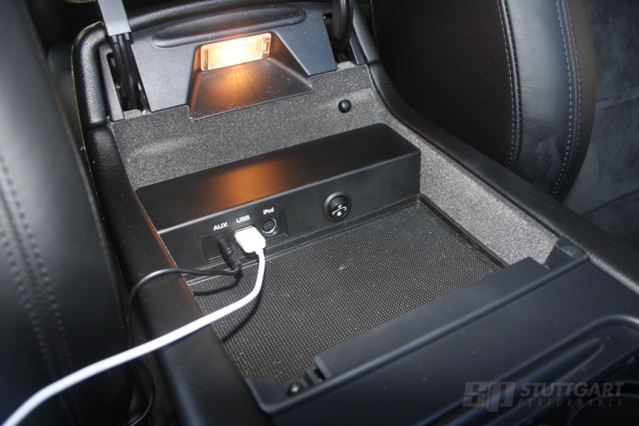

The Cargraphic switch installed on the right side of the center console. The switch toggles between modified and factory ride height settings. The switch can be installed anywhere.
