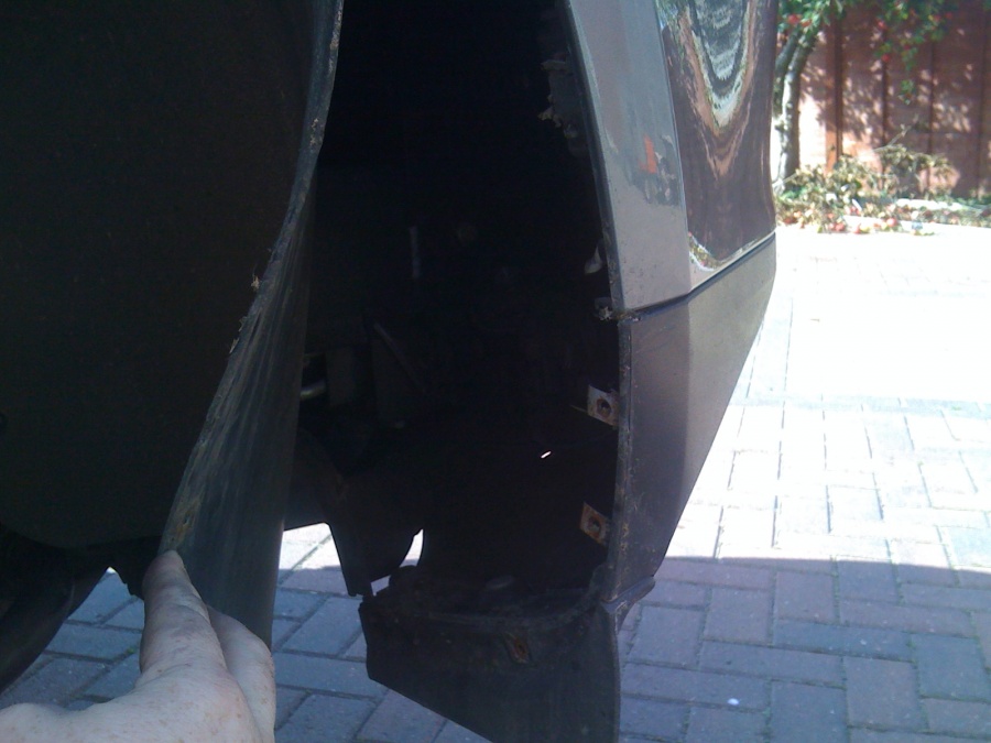

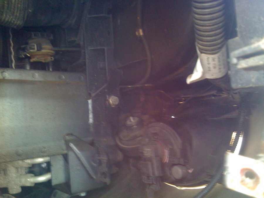

This is the view of the wheel arch screws removed and the view behind the panel. Notice the original horn removed from its bracket above. This method however gives you very limited access to the wiring. Removing the fog light( very easy) gives much better access and view.
Old Oct 6, 2009 | 06:53 PM
wilfred's Avatar
Joined: Sep 2007
Posts: 155
wilfred is infamous around these parts
Thanks for taking the time to take pictures for the rest of us that has not seen it. It will make it so much easier when our time comes... A picture is worth a thousand words so thanks for two thousand words!
