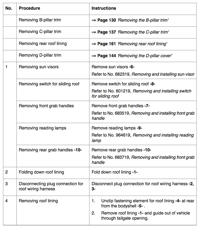

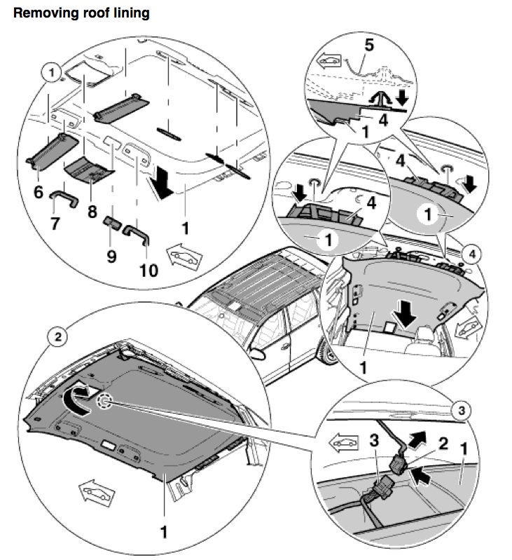

These should help, depending how in depth you want to go.

The rear roof cover where the dome light is in the very rear just pulls down. Hope that helps. BTW, mine are still leak free.
