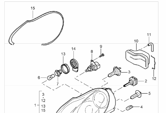

What year Cayenne?
How much condensation? Fog or water drops?
There is a $30 replaceable gasket that surrounds Cayenne headlights that usually solves the problem:

Thanks for the suggestion. Its a 2006, and it's water droplets not fog. I'll take a look a look at the gasket but the enclosure is sealed just fine on the back with all the rubber caps properly in place.

Gasket is on the surround of the headlight (clear plastic part.) Also note that on the underside of the headlight is a round plastic disk with a filter...this should be clean and unobstructed.
