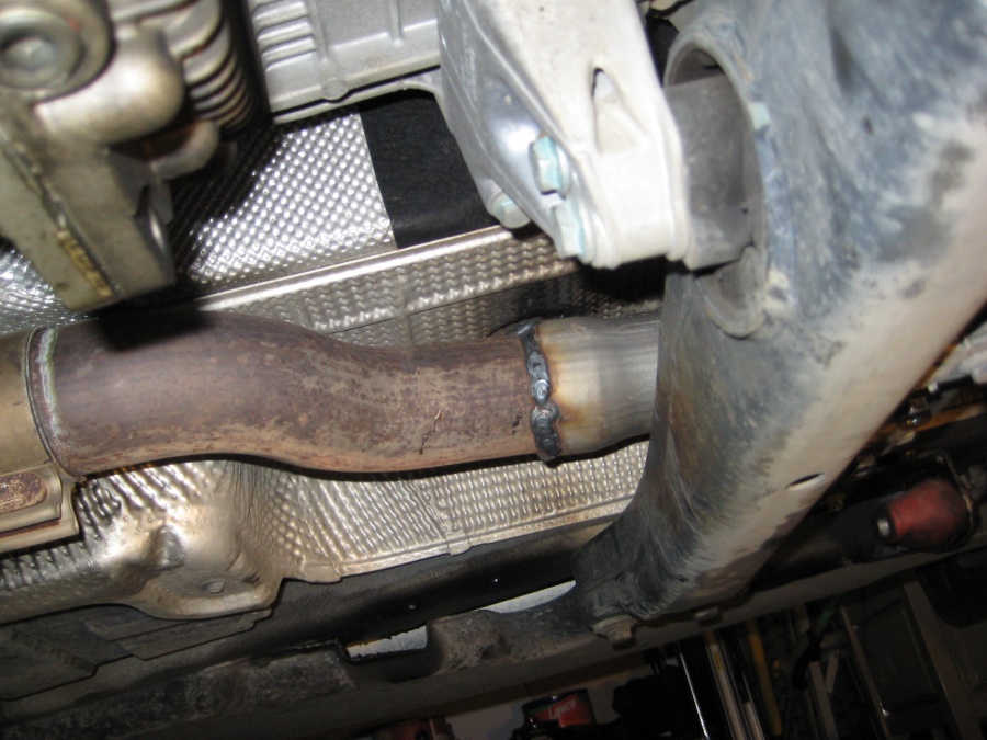

Well at first I do it for the horse power increase, but after that I begin to realize that the miles per tank increase in like 12%. Before the mod it gets 290 to 300 miles per tank on average and now it have increase to 340 to 350 miles per tank. I did not believe it at first so I did not post for like 4 full gas fill up.
Here it is, not the most beautiful but it does the job.

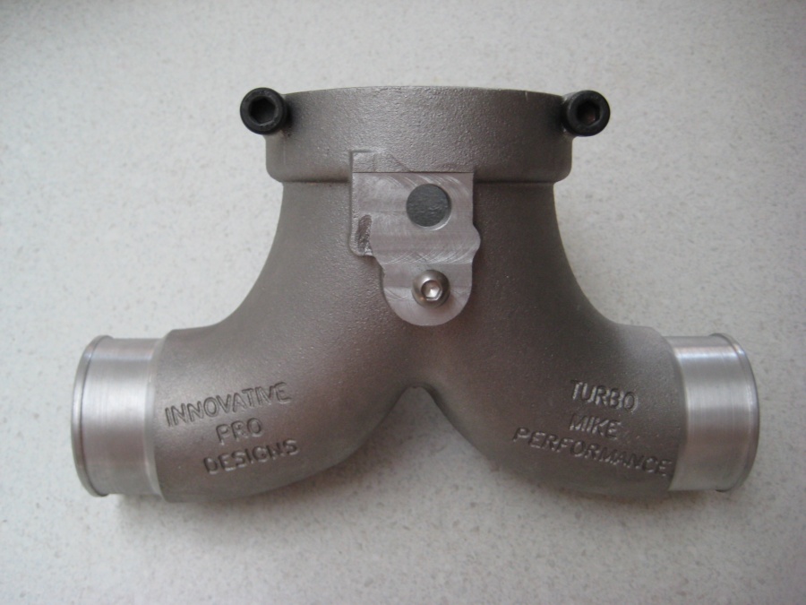

Are you telling us the by-passing the secondary cats and and IPD Plenum are all of your mods?

Is that the mod?
Yep that's all, but I see the increase in MPG after the cats delete.

Originally Posted by contigo
Is that the mod?
Yes, the mod is cat deletes by muffler shop not so good looking like others but it works.

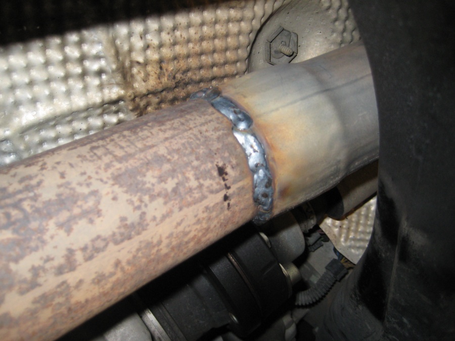

There's some sweet welds in those pics

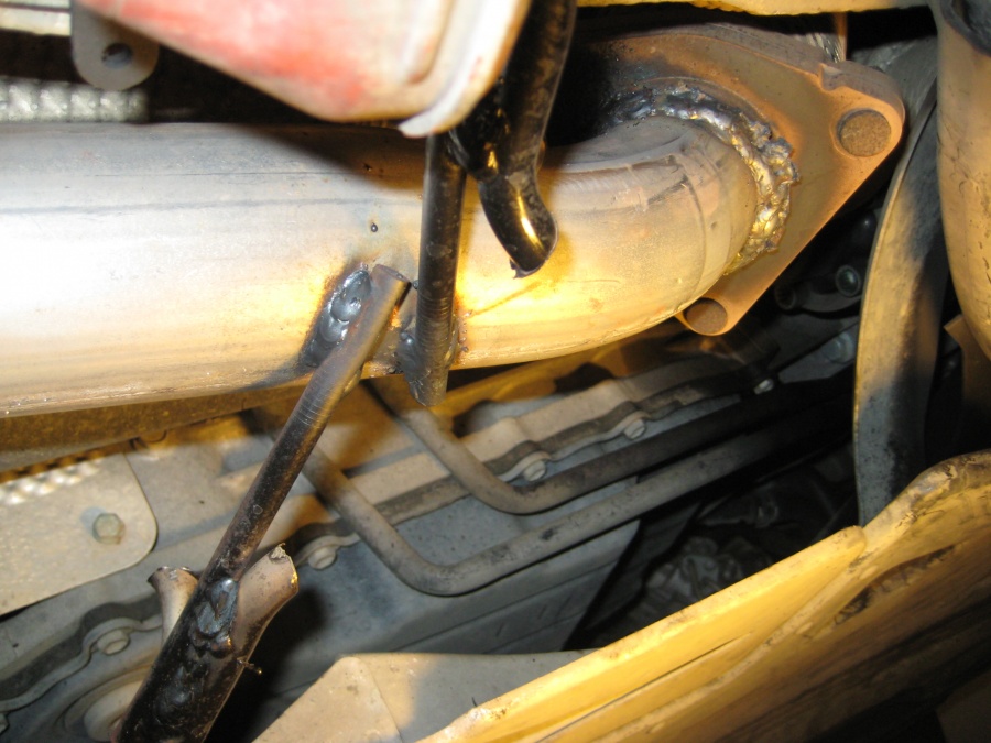

Either way, notice the 3rd pic in RXporsche post above, welding the steel arms onto to the bypass pipes prevents rattling of the pipes when you slow down. Even using Fabspeed this s highly recommended to avoid rattle. Great Job! I went back and had steel rods welded to eliminate the rattle. Annoying...
