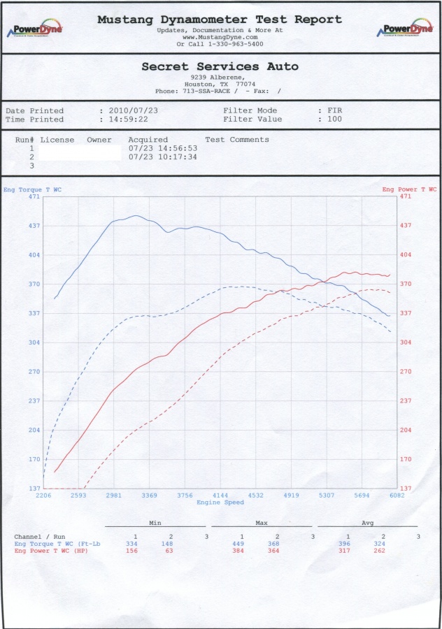

I finally got back on the dyno and the tuning went well. Either the gas around here isn't that great (I used Shell this time over Exxon, both 93 octane) and there will still some minor timing issues that had to be worked around. I specifically asked for a conservative tune with plenty of bottom end and it worked out well. Throttle response is very good and my mileage hasn't suffered any that I can tell. The boost is instantaneous and has no problems pegging the gauge. It does trail off up top, but even at the dragstrip I was able to manage 13.7s@102 in 94 degree heat with maybe 30 minutes cool down. The thing requires only moderate throttle to accelerate hard. Jerry with Eurocharged was the tuner and he was very professional and answered all of my questions during the process and also explained the changes he would make after each pull. Mine is boosting to about 14psi, tapering off to about 10.5 psi up top. I'm sure there is more in it, but I just prefer not boosting harder at the very top. Fueling is about 12.5:1 at first going to about 11.5:1 up top. Despite the dyno graph the pull is very smooth. I've had zero issues with it as far as check engine lights or anything like that. I did try the off-the-shelf tune for a while and I think it may have made a tad more peak hp but the low to mid range torque on this tune feels stronger.

Forgot the graph. Evoms intake kit, IPD plenum, Fabspeed bypass pipes, and APR DVs are the other mods and were installed during the baseline run shown here as well as after the tuning. It was tuned in about 90 degree temps with over 80% humidity.
