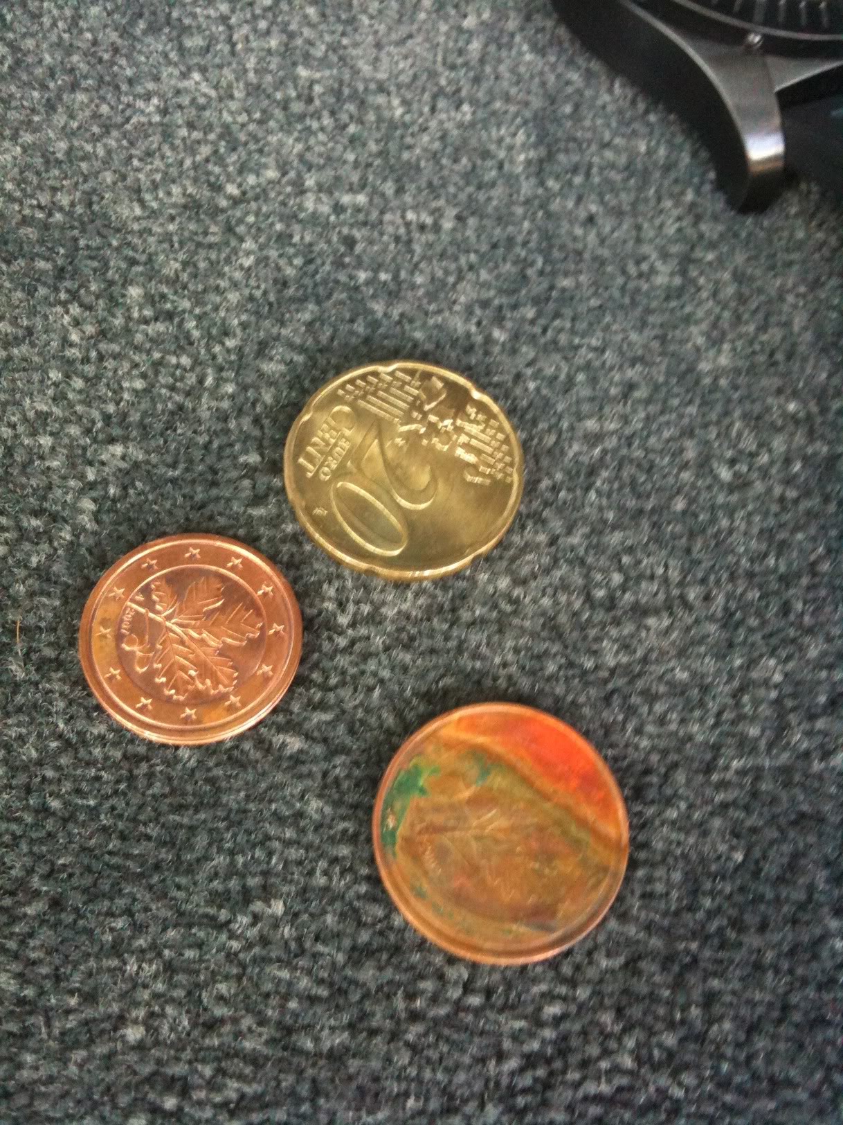

Actually - completely forgot. I removed my sub last month as I dropped a bunch of fuses down in the well and they were rattling around. Here is what I found UNDER the sub all green and stuck to the floor pan.

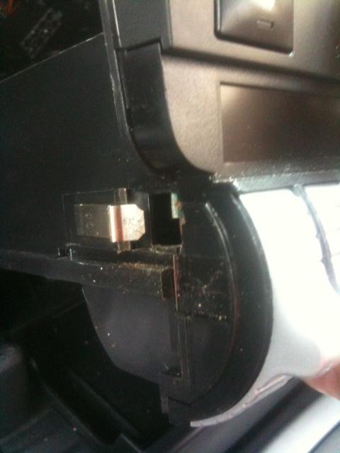

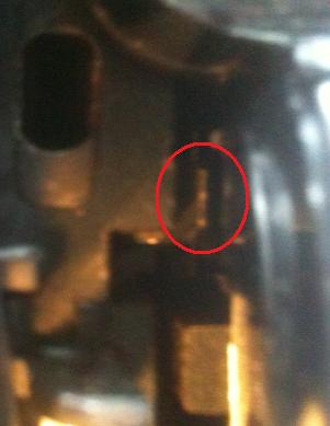

This foxed me for a while. I took these 2 pictures. You can see the clip when removed, and you can just see the silver vertical edge when the unit is fitted (circled).
They needed a good push inwards with a flat screwdriver to unclip (the blade would be pushed against the left of the clip in this picture).
